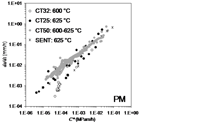

The creep crack growth rate data from all the tests examined on PM and HAZ materials are correlated with the C* fracture mechanics parameter in Figure 5. It has been noted that although only the valid data points from Figure 4 are included in this figure, some tails are still apparent particularly in the CCG data from HAZ specimens. This implies that applying the ASTM C* validity criteria don’t necessarily remove the entire tail region in da/dt vs. C* trends.
It can be observed in Figure 5 that the CCG trend obtained from PM1-CT32 is consistent with that of obtained from PM2-CT32 sample. Also seen in Figure 5 is that for a given value of C*, a higher creep crack growth rate is observed in the HAZ specimens compared to the PM. In order to quantify the amount of increase in the CCG rate of the HAZ material compared to the PM, the empirical creep crack growth power law constants (i.e. see Eqn (2)) have been obtained from the line of best fits to the valid data points and are summarised in Table 3. As seen in Table 3, similar slopes of close to unity have been found in the CCG behaviour of the HAZ and PM specimens. Also seen in Table 3 and Figure 5 is that for a given value of C*, the creep crack growth rate in the HAZ data is around 8 times higher than the PM data.
Specimen geometry and size effects
Comparison to the Existing Parent Material Data
The CCG data on PM1-CT32 and PM2-CT32 parent material specimens tested at 600 °C are compared to those of available at 600─625 °C on C(T) specimens of width W = 25 and 50 mm (with B/W = 0.5) taken from [7, 8] and also to the existing test data on single edge notch tension , SENT, specimens in Figure 6. As seen in this figure, the CCG test data on C(T) specimens with W = 32 mm generally fall close to or below the lower bound of the experimental data scatter available for the parent material at 600─625 °C. It can be observed in Figure 6 that for the range of temperatures examined, the CCG trend from C(T) specimens with W = 50 mm, is higher than those of obtained from SENT samples and also C(T) specimens with W = 25 and 32 mm. Also seen in Figure 6 is that the data scatters are similar for C(T) specimens with W = 25 mm and SENT samples. The available CCG data scatter bands from these tests, which are relatively wider than those of obtained from other specimens, generally fall on top of or in between the CCG trends for C(T) specimens with W = 50 mm (which have the highest CCG rates) and W = 32 mm (which show the lowest CCG rates).
Comparison to the Existing HAZ Material Data
The valid CCG data points from the tests on HAZ1-CT32, HAZ2-CT32 and HAZ3-CT32 at 600 °C are compared to the available experimental data on HAZ material C(T) specimens with W = 25 mm tested at 600─625 °C taken from [7, 8], in Figure 7. As seen in this figure, the CCG trends observed from C(T) HAZ specimens with the width of 25 and 32 mm are similar within the scatter, if the tails in the HAZ-CT32 tests are not considered in comparisons.
Discussions and conclusions
A higher creep crack growth rate is observed in HAZ specimens compared to the parent material when the data are correlated with the C* fracture mechanics parameter. This is thought to be due to the lower creep ductility and also higher yield stress in HAZ material which limits the plasticity effects in the CCG behaviour of the material and thus leads to higher creep crack growth trends.
Some discrepancy can be observed in da/dt vs. C* trends from the tests on PM specimens with different sizes and geometries at 600─625 °C. As shown in Figure 6, a higher CCG trend in parent material was observed in C(T) specimens of width W = 50 mm (and B = 25 mm) compared to those of W = 25 and 32 mm (and B = 12.5 mm). This can be due to the higher specimen constraint level in larger C(T) specimens which leads to dominant plane strain conditions in the samples and thus higher creep crack growth rates. The lowest CCG trend was seen in C(T) PM specimens of width W = 32 mm. Note that although PM1-CT32 and PM2-CT32 C(T) specimens of W = 32 mm had a different width compared to the C(T) specimens with W = 25 mm, but the total thickness, B, was the same in these samples (i.e. B = 12.5 mm). It may explain why the CCG data for CT32 specimens fall close to the scatter band of CT25 specimens. Note that all the CCG data on parent material C(T) specimens of width 25 mm are for 625 °C, thus a slight drop in the CCG rate of CT32 specimens performed at 600 °C may be related to the temperature effects. Therefore, repeating the tests on C(T) specimens with W = 25 mm at 600 °C may result in CCG trends closer to that of obtained from C(T) specimens with W = 32 mm tested at the same temperature.
Figure 6 o shows that the specimen geometry can influence the CCG behaviour of P91 parent material. This is because of the difference between specimen constraint levels in various geometries. For the given material and testing temperature, similar CCG trends in SENT and CT25 samples may be due to similar levels of specimen constraint in the examined test pieces.
The comparison of the available creep crack growth data on HAZ material C(T) specimens with W = 25 at 600─625 °C to those of width W = 32 mm at 600 °C shows that similar trends can be observed in all HAZ samples, if the tails remained in the data subsequent to C* validity criteria being applied are excluded. This can be due to the same specimen thickness (i.e. B = 12.5 mm) and thus similar constraint levels in C(T) HAZ specimens with W = 25 and 32 mm. Further tests on C(T) specimens of width W = 32 made of parent material and HAZ are needed to confirm the observed trends.

Figure 6: Comparison of the parent material CCG data for a range of specimen size and geometries
Figure 7: Comparison of the HAZ material CCG data for C(T) specimens with different dimensions
