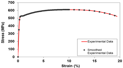

The model was meshed with 20-node quadratic brick, reduced integration elements (element type C3D20R in Abaqus). Incremental plasticity theory was used with the elastic-plastic material data taken from smoothed and averaged experimental data as shown in Fig.7. The Young's modulus was taken to be 203GPa with a Poisson's ratio of 0.3.True stress and true plastic strain data were then calculated based on the yield point of the material at 523MPa. A sharp crack was defined with propagation direction normal to the crack front because of its curved profile. The J-integral was calculated using a domain integral technique over 11 contours, with the radius of the outermost contour approximately equal to 2.1mm. Convergence of J was observed by the 11th contour and thus path-independence of J was achieved. To simulate the SENT test, the faces that would be attached to the 'mechanical grip' were kinematically coupled to a reference point, which was displaced in the x-direction with the reaction force output at each increment. A single point was constrained in the y-direction to ensure no rigid body motion.
The crack shapes assessed using numerical modelling are shown in Figure 8. All the SENT specimens were 2BxB of 20mm by 40mm in size, notched to an average depth, a0 of 6.6mm, giving an a/W ratio of 0.33 for each model case. The specimens were assumed to be parent metal with yield strength of 523MPa and tensile strength of 610MPa.
Fig.7 Stress-strain experimental data and smoothed data used in FEA
