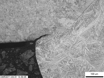

Metallography
From metallographic examination of the welds no anomalies in the microstructure were observed in the parent, HAZ, or the weld metal in any of the welds examined in both the as-received and post-strained conditions.
Minor weld root lack of fusion features were observed in some of the welds examined. The morphology of the weld root features ranged in shape and size and Figure 5 shows one of the larger typical features observed, however, there were also a number of welds examined which did not exhibit root features (Figure 6). The root features observed were considered to be typical of those found in welds made with this combination of parent and welding consumable and was not considered to have a significant effect on the corrosion performance of the weldment.
Figure 5a: An example of lack of fusion weld root feature from Weld BW03 after straining
a) Unetched
Figure 5b: An example of lack of fusion weld root feature from Weld BW03 after straining
b) Etched in Kallings No. 1 solution.
Figure 5: An example of lack of fusion weld root feature from Weld BW03 after straining
Figure 6a: An example of weld root showing no features from Weld BW01 after straining
a) Unetched
Figure 6b: An example of weld root showing no features from Weld BW01 after straining
Figure 6: An example of weld root showing no features from Weld BW01 after straining
