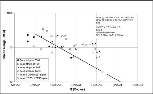

Some fatigue data exist for welded joints in both sour [9-14] ( Figures 1-3) and sweet [15] ( Figure 4) produced fluids but more data are required particularly for sweet fluids, where only one reference was found. Both types of environment are apparently detrimental. Crack propagation data indicate little effect of room temperature sour environments at near-threshold stress intensity ranges but an increasingly detrimental effect is found at higher ΔK or K max levels, Figure 2. The effect of H 2 S depends on the corrosivity of the test environment, but a substantial effect is observed even in dry H 2 S or oil with H 2 S [11] . Cyclic frequency was demonstrated to be important, Figure 3, with crack propagation rates increasing as cyclic frequency decreased. [9,13] Aqueous sour environments are more damaging, as are high levels of H 2 S, Figure 2. On the basis of fatigue endurance tests on representative riser girth welds, Buitrago and Weir reported a factor of 10-20 reduction of life for when tested in NACE TM0177 solution B with 0.5 and 1psi H 2 S partial pressure at a frequency of 0.33Hz [10] , Figure 1. An effect of temperature may be anticipated, especially in relation to the kinetics of any hydrogen effects, as for sulfide stress cracking.
Fig. 1. Results of strip corrosion fatigue tests in simulated sour produced fluids (0.33Hz, R varied) and full-scale air fatigue tests (20-30Hz, R = -1) for C-Mn steel riser pipes. [10]

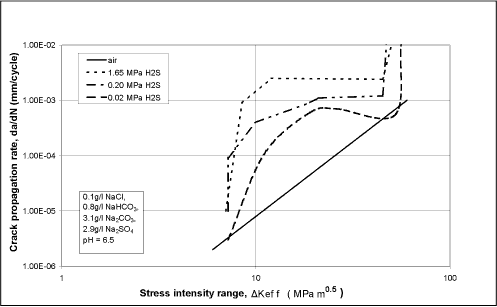

Fig. 2. Illustration of the effect of changes in partial pressure of H 2 S on fatigue crack propagation rate in a medium strength low alloy steel tested in a simulated sour drill mud (1Hz, R=0.3). [14]

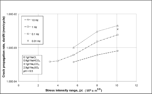

Fig. 3. Fatigue crack propagation rates for a medium strength low alloy steel tubular in a simulated sour drilling mud (17.2bar H 2 S, R = 0.3). [12]

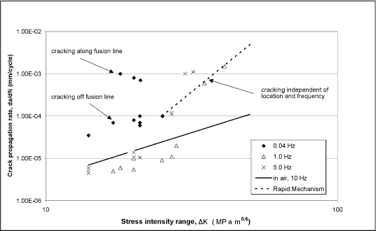

Fig. 4. Fatigue crack propagation rate data for girth welds in C-Mn steel linepipe in a sweet uninhibited brine (10%NaCl, 10%CaCl 2 , 95°C, 3bar CO 2 ) at a range of frequency (R not specified), showing an effect of HAZ microstructure. [15]
One study of fatigue of welds in a sweet environment (3 bar CO2 with a solution of 10%NaCl and 10%CaCl2 at 95°C) has been reported by Szklarz. [15] He found that crack propagation was faster than in air, believed to be primarily due to crack-tip dissolution, and that there was a strong dependence of propagation rate on loading frequency, Figure 4. This was found at moderately high ΔK (over 600N/mm 3/2 ). He observed preferential propagation along the weld fusion line and preferential corrosion of the fusion line/HAZ area. The application of inhibitor from the start of test reduced the environmental effect on crack propagation at low ΔK but had little effect if applied after a crack had started to propagate.
