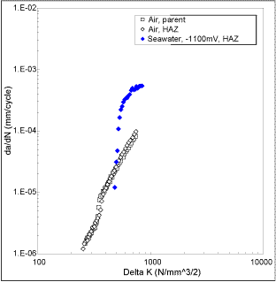

Fatigue of 12%Cr supermartensitic stainless steel in seawater with cathodic protection
Figure 1 shows a comparison of fatigue crack growth rates in air and in seawater with CP at -1100mV SCE for the HAZ notched 12%Cr supermartensitic stainless steel specimens. It can be seen that crack growth rates in the HAZ are up to about a factor of 5-7 higher than in air for ΔK >600 N/mm3/2 . At low ΔK the data under CP fall below the air data suggesting a higher threshold in the former case.
Fig.1. Fatigue crack propagation data for supermartensitic stainless steel HAZ notched specimens tested in air and seawater with cathodic polarisation to -1100mV

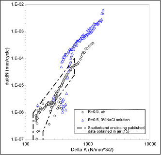

Fatigue of 22%Cr duplex stainless steel simulated haz in 3%NaCl
Figure 2 shows the data for the 22%Cr duplex stainless steel simulated HAZ specimens tested in air and 3%NaCl. The results at R=0.5 in air were consistent with published data for parent plate in air but there was a large amount of scatter in the near threshold region. The data in air are very similar to the crack growth rate data obtained for the 12%Cr supermartensitic stainless steel HAZ under similar conditions.
The rate of fatigue crack growth was increased in the 3%NaCl solution by a factor of 5-7 times at high ΔK (above about 600N/mm 3/2 ) but was very similar to or below the air data at lower ΔK. This was investigated further by examining the microstructure and fracture faces in detail. This revealed a crystallographic fracture mode and some secondary cracks after testing in 3%NaCl.

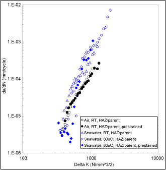

Fatigue of 25%Cr superduplex stainless steel in seawater with cathodic protection
Figure 3 shows the results of testing of the superduplex stainless steel HAZ in seawater with CP. In seawater, a step change in behaviour was observed at about ΔK = 600N/mm 3/2 . Below this level, there was most scatter in the data but there was a difference between the two temperatures in this regime indicating slightly lower fatigue crack growth rates at 80°C than at room temperature. At high ΔK, the data at 80°C lie above the room temperature data but again the effect is fairly small compared with the level of data scatter.
The crack growth rates in seawater with CP are similar to those in air at low ΔK, below about 400N/mm 3/2 . At higher ΔK, the crack growth rates in seawater are about three times higher than the corresponding air data. The seawater data exhibit higher slope than for air in the near-threshold region and there is a suggestion that the threshold may be higher in seawater with CP than in air. This may be due to closure arising from the formation of calcareous deposits under CP. However, because of the degree of scatter in the analysis, it must be assumed that the crack growth rates were not significantly different.
Fig.2. Fatigue crack propagation data for 22%Cr duplex stainless steel simulated HAZ specimens tested in air and 3% NaCl solution without cathodic polarization.

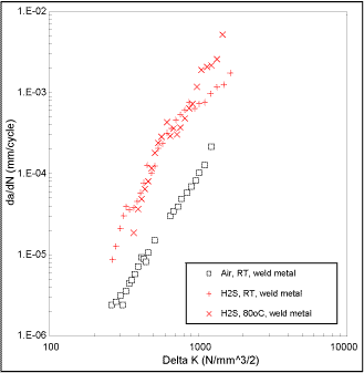

Fatigue of 25%Cr superduplex stainless steel in a sour environment
Figure 4 shows the results for the sour brine. At both test temperatures, crack growth rates were substantially higher in the sour environment than in air. Crack growth rates were up to ten times higher than in air at higher ΔK values, particularly in the mid- ΔK range. At high and low ΔK values, the effect of the environment is apparently reduced, especially at 20°C in the high ΔK range, although it is noted that only a fairly small amount of data is available in the low ΔK regime.
Fig.3. Fatigue crack propagation data for superduplex stainless steel HAZ notched specimens tested in air and seawater with cathodic polarisation to -1000mV.
Fig.4. Fatigue crack propagation data for superduplex stainless steel weld metal centreline notched specimens tested in air and a sour brine with 25mbar H 2 S.
Examination of the fracture faces of the samples tested in the sour brine showed crack propagation predominantly by transgranular cleavage suggesting an effect of hydrogen embrittlement. This was through the ferrite phase but also, to a lesser extent, apparently through austenite, giving rise to large facets on the fracture faces. There was very little evidence of ductile tearing. The samples tested in air showed crack surfaces more typical of fatigue with no environmental action, i.e. irregular transgranular features with little evidence to indicate whether propagation was through ferrite or austenite phases. Fatigue striations were also observed.
Sectioning confirmed the findings of fractography. The samples tested in the sour brine demonstrated a transgranular crack path showing large facets with little deviation from the macroscopic crack path. There was no evidence of preferential crack propagation through either the ferrite or the austenite phase. In contrast, the samples tested in air, showed an irregular crack morphology. Very little crack branching was observed in either sample.

Supermartensitic stainless steel
The supermartensitic stainless steel HAZ notched specimens showed a factor of 5-7 increase in crack growth rate when tested in seawater with cathodic protection. Cathodic polarisation will give hydrogen uptake ahead of the crack-tip due to the forced generation of atomic hydrogen on the steel surface. The cap heat affected zone typically consists of virgin martensite due to the high hardenability of the steel and the absence of reheating by subsequent passes but the remainder of the HAZ will have some reheating and will consist of partially tempered martensite. Embrittlement ahead of the crack-tip by hydrogen generated under cathodic protection would be expected to increase crack propagation rates in supermartensitic steel. The magnitude of this effect would be expected to be increased in the untempered and partially tempered martensite of the HAZ compared to the fully tempered martensite of the parent steel. Hydrogen embrittlement is a static mode of fracture and the crack growth rates would be expected to be sensitive to the maximum applied K value under such conditions, with higher cyclic growth rates as the maximum K increases. It is noted that the increased crack growth rates are only observed above about 600N/mm3/2 , with near threshold crack growth rates being similar to or lower than the air rates. This is probably due to closure resulting from formation of calcareous deposits within the fatigue crack and may be particularly important for risers, which would be expected to spend most of their life in the near threshold regime. More data are required in the threshold region to confirm this effect.
Duplex stainless steel
The faceted appearance of the duplex stainless steel fracture faces and presence of secondary cracks indicated that hydrogen embrittlement had again contributed to crack propagation in the 3%NaCl solution without CP, presumably relating to hydrogen generated by corrosion at the crack-tip, where the passive film is repeatedly ruptured. This was apparently sufficient to give increased crack growth rates compared to air. Coarse, high ferrite microstructures are typically fairly sensitive to hydrogen embrittlement and the simulated HAZ had 62% ferrite compared to 45% in the parent steel. Grain coarsening and increased ferrite levels, to around the level employed here, are inevitable in the HAZs of fusion welds in duplex stainless steels. The extent of the effect will depend on material composition, and will be most marked in steels with fairly low nitrogen level, say below about 0.12-0.13% (the steel used here had 0.17%).
Sensitivity to hydrogen embrittlement effects increases at high ferrite contents, and in principle high nitrogen contents or perhaps high arc energy welding conditions are to be preferred to promote austenite formation during the weld thermal cycle, although upper limits of heat input are specified to avoid formation of intermetallic phases.
Superduplex stainless steel
It should be noted that fatigue crack growth rates obtained for the sour brine and seawater environments show similarity to previously published data [16-18] for UNS S32760 superduplex steel tested in gaseous hydrogen and water with a range of oxygen contents. Increased crack growth rates were reported in both hydrogen and water compared to air. In addition, formation of transgranular cleavage facets was observed in the ferrite phase in both water and hydrogen, and in the current work in seawater with CP and sour brine. Consequently, it seems that increased crack propagation rates in superduplex stainless steel may be obtained in water or brine with or without cathodic polarisation, gaseous hydrogen and brine with H2S, i.e. a range of environments, which may introduce atomic hydrogen at the fatigue crack-tip. This is consistent with the 22%Cr duplex stainless steel data derived from testing in 3%NaCl without CP.
This again indicates the sensitivity of the ferrite phase to the presence of absorbed hydrogen [16-18] , although it seems from the results that the austenite might also show some sensitivity. Whilst the H2S level employed in the sour tests was below the maximum level allowed for UNS S39274 superduplex stainless steel in ISO 15156, [19] fatigue crack growth tests repeatedly expose virgin material at the crack-tip and some degree of hydrogen generation and pick-up may be anticipated for any aqueous environment. The addition of H2S tends to enhance hydrogen uptake as it is a cathodic 'poison', whilst the presence of CO2 reduces the solution pH and encourages corrosion. In the present tests, the uptake of hydrogen at the crack-tip has again reduced material ductility ahead of the crack-tip, leading to increased growth rates and the observation of a cleavage-like hydrogen embrittlement mode of failure through both the ferrite and austenite phases. Similar fracture faces have previously been observed in hydrogen-charged material [16-18] .
