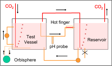

A dedicated system for environmental monitoring and control during fatigue testing in this project was built. The deaerated test solution was continuously circulated between a reservoir (~22litre) and the test cell (~22litre) throughout test (Figure 5). A hot finger, incorporated in the recirculating loop to deposit iron (II) ions from solution, allowed control of the concentration of iron in solution, which would affect development of corrosion product films on the test sample.
Pargeter Figure 5
Fig. 5. Recirculation system for test solution
Continuous measurements of pH were made within the recirculating loop, and dissolved oxygen concentration was also measured at intervals during testing. Measurement of corrosion rate in the environment was conducted using Linear Polarisation Resistance (LPR) measurements on a separate specimen made from the pipe steel. Details of these measurements are given below.
The base line test environment was designed to give a high rate of corrosive attack (pH approximately 4.5). This consisted of 35000ppm NaCl and 68ppm NaHCO3 in water at 60°C, saturated with 100mol% CO2 at 1bara. This gives 13800ppm Na+, 21200ppm Cl and 50ppm HCO3 in solution. The calculated corrosion rate from models for this environment was 4.3mm/yr ±1.2mm/yr, and the scaling temperature was calculated to be 85°C.

Fig. 6. Corrosion fatigue crack growth rate equipment (reservoir and recirculating loop not shown)

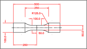

Fatigue endurance tests were conducted under direct axial loading on strip specimens machined from the girth welds. Details of the test equipment and specimen design are shown in Figures 8-10. As a result of the curvature of the test section, axial loading produces a combination of membrane and bending stress at the test weld, with the weld root seeing the highest tensile stress range. Two strain gauges were placed each side of the weld root 10 and 25mm from the weld toe. Measured strains were extrapolated to provide an estimate of the local stress at the appropriate weld toe where failure was seen to initiate. The gauges were removed prior to commencing fatigue loading for the corrosion fatigue tests. The weld bead at the root was in the as-welded condition, while the cap was machined to preclude failure from this position.

Pargeter Figure 10a
Fig. 10. Specimen design for air
Pargeter Figure 10b
Fig. 10b. Specimen design for corrosion fatigue endurance tests

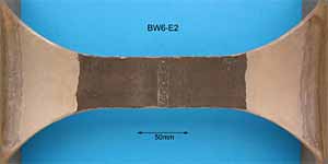

The endurance specimens tested in corrosive environments were also partially coated, principally to limit contamination of solution with corrosion products. The edges and cap surfaces were coated along the whole specimen length to preclude failure from these locations. The root side was coated to half way down the flared section, outside of the gauge length, as illustrated in Figure 11. This was done to minimise the risk of failures initiating at the edge of the coating.
Pargeter Figure 11
Fig. 11. Specimen BW6-E2 after test, showing extent of coating

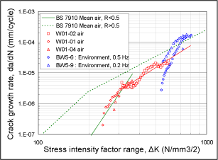

Baseline air data - The first test using specimen W01-01 was carried out under conditions of decreasing (ΔK) from an initial (ΔK) of approximately 300N/mm3/2. This test resulted in only a small amount of crack extension and relatively little test data were obtained. Subsequent specimens (W01-04 and W01-02) were then tested, again under conditions of decreasing (ΔK), this time at initial (ΔK) values of 400 and 600N/mm3/2 respectively. A summary of all of the test data is provided in Figure 13. It can be seen that test data are close to the mean curve for steels in air (R<0.5) taken from BS7910.[3]
Corrosion fatigue data - A summary of the corrosion fatigue crack growth rate data is included in Figure 13. The data obtained in air are plotted for comparison, and data are also compared to those reported by Szklarz[4] in Figure 14.

Fig. 13. Summary of FCGR data

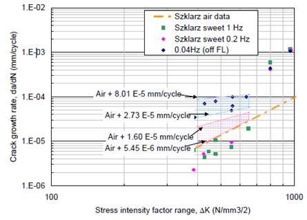

Fig. 14. FCGR data compared with data from Szklarz
For the test carried out at 0.5 Hz (BW5-6), the initial ΔK was 800N/mm3/2 and the test lasted about eight days (from start of cycling). Initially (ΔK=800) the growth rate was somewhat higher than might be expected in air. However, as the applied ΔK decreased (K= 500-600) the crack growth rate was comparable to or lower than that seen in air.
Specimen BW5-9 was tested using a lower frequency of 0.2 Hz, and the initial ΔK was again 800N/mm3/2. At high ΔK the crack growth rate was similar to the previous test (just under 2x10-4 mm/cycle), but at lower ΔK, the crack growth rate was noticeably higher than for BW5-6. This test lasted approximately three days.

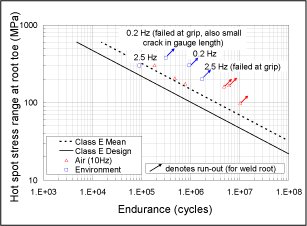

Baseline air data - Tests were performed in air at a frequency of 10Hz. Three specimens were tested to failure at local stress ranges of 174, 206 and 303MPa. Three further specimens tested at local stress ranges of 99, 161 and 167MPa, ran out at >5x106 cycles. A summary of the test data is given in Table 4 and included in Figure 15. It can be seen that all of the data are to the right of the mean Class E curve taken from BS7608.[5]
Pargeter Figure 15
Fig. 15. Summary of fatigue endurance test data
Corrosion fatigue data - Four endurance tests were conducted in the corrosive environment. Test parameters and results are summarised in Table 4 and Figure 15. The test frequency for the first two of these tests was 0.2Hz.

The second test specimen (BW6-E2) was tested at a stress range of 380MPa and was on test for 312,724 cycles (18 days). At this point, the fatigue life had again exceeded that expected in air by a considerable margin, so the test was terminated prior to failure. The appearance of the test specimen after testing is illustrated in Figure 11, with a detail of the central region in Figure 18.

Fig. 18. Detail of central region of specimen BW6-E2 after test. See also Figure 11
Data from these two tests suggested that lives in the sweet corrosive environment were significantly higher than those seen in air, and were approximately a factor of eight higher than the mean for Class E. It was decided that a complete series of six tests in this environment was not necessary.
Effect of frequency
Further testing in this environment was carried out using a cyclic frequency of 2.5Hz to investigate the influence of this test parameter. Specimen BW3-E2 was tested at a stress range of 300MPa to provide a direct comparison with specimen BW6-E1 described above. Failure of this sample occurred after 90,378 cycles (1 day), an order of magnitude lower than the 0.2Hz test, and a factor of 2 lower than the corresponding test carried out in air. Examination of the specimen after the test revealed that failure had occurred from the weld root toe.
The effect of frequency at a lower stress range was explored using specimen BW2-E2, at a stress range of 200MPa and a frequency of 2.5Hz. This specimen was stopped at 1,720,670 cycles, beyond the air results at this stress range, due to cracking in the pin loaded end. Thus, at this stress range, increasing the frequency did not change the beneficial environmental effect on life observed at 0.2Hz. This is discussed below.

The mechanism for increasing growth rate in such environments, which has been proposed to date is crack tip dissolution. Szklarz found a marked increase in growth rate at lower ΔK (~400-650N/mm3/2) when the frequency was reduced to 0.04Hz, and under these circumstances the growth rate was higher than air, with a similar slope to the air data, (provided cracking did not follow the fusion boundary, in which case it was considerably higher) (Figure 19). Because of the frequency effect, Szklarz attributed the higher growth rate to crack tip dissolution. Under such circumstances, a constant difference in da/dN would be anticipated between air and environment, regardless of ΔK, such that:
Pargeter Formula 1
and this is what is observed for Szklarz's data up to 635N/mm3/2. (Two bounding lines, air + maximum observed difference in growth rate = 8.01 e-5 mm/cycle and air + minimum observed difference in growth rate = 2.73 e-5 mm/cycle have been superimposed in Figure 19).
Pargeter Figure 19
Fig. 19. Evaluation of the effect of a constant rate of crack tip dissolution on fatigue crack growth rate for data from Szklarz
Having said that, if the crack tip dissolution effect determined in this way for 0.04Hz is factored and applied to the 0.2Hz data (giving maximum and minimum additional growth rate components of 1.60 e-5 and 5.45 e-6 mm/cycle respectively), some acceleration would also be expected, as shown on Figure 19, but was not observed from Szklarz's paper. (No measurable acceleration would be expected on this basis at 1Hz.)
At ~800-1000N/mm3/2, this relationship no longer holds (although there are no air data at this stress intensity range), and Szklarz proposes some unknown accelerating mechanism other than crack tip dissolution. The correspondence with TWI data suggests that this is a real effect, and that this is possibly similar to stress corrosion fatigue[6], rather than pure corrosion fatigue, but there is no ready explanation for the mechanism. This is not of too much concern, however, as growth at such high ΔK would only be experienced close to end of life.
Szklarz suggested that low crack growth rates in his uninhibited brine at low ΔK were due to scale build up and crack closure. It is of interest to note that the conditions in Szklarz's work would be expected to generate a carbonate scale, whereas the present environment was selected to be highly corrosive, but non scaling. Thus, it is not clear that this explanation can be used for the present TWI data, even though the performance is closely similar.
