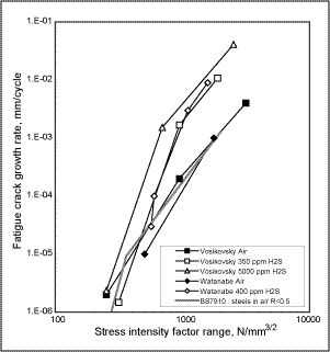

Early work examining the effect of H2S containing environments was carried out in the 1970's by Vosikovsky. [16,17] This work examined API 5L X65 pipe (non-welded), and tests were performed in crude oil containing H2S at a stress ratio R=0.05 and cyclic frequency of 0.1Hz. The H2S concentration was varied between 20 and 5,000ppm. Watanabe et al [18] also tested pipeline steel (welded and non-welded) in crude oil containing H2S, this time at 400ppm, with R=0.03 and a frequency of 0.17Hz. A summary of the data from these two references is provided in Fig.6, along with the mean curve for C-Mn steels in air from BS 7910 (which is in good agreement with the baseline data). It can be seen that at high stress intensity ranges, crack growth is up to 15 times faster at 400ppm H2S, and 25 times faster at 5,000ppm H2S.
Fig.6. Fatigue crack growth rate data for C-Mn steel in crude oil containing H 2 S [16-18]

  • In crude oil, the presence of H2S leads to a marked increase in fatigue crack growth rate, up to 35 times that in air at high ΔK. The effect diminishes with decreasing ΔK and decreasing H2S concentration.
