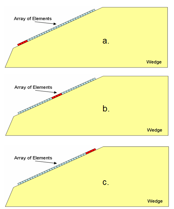

Furthermore, in both cases above, two types of element failure were studied:
  • Type 1 – Random failure of elements;
  • Type 2 – Failure of a block of contiguous elements along different regions of the array.
In type 1 failure, increasing numbers of elements were switched off in the model to simulate their complete failure. These elements were randomly chosen on the array but prevented from being adjacent to each other. In type 2 failure, a number of adjacent elements were made inactive within a contiguous group of elements. This contiguous group was placed at the bottom of the array (Figure 1(a)), centrally aligned in the middle of the array (Figure 1(b)) and top of the array (Figure 1(c)).
Figure 1 Failed element modelling of the type 2 cases: a contiguous group of failed elements at the bottom of the array (a), centrally on the array (b) and at the top (c).
An element was made inactive by reducing its amplitude of displacement to zero. Hence, the focal laws were calculated for the entire set of elements in the array; then the elements to be made inactive were not ‘fired’ when the sound field was created.

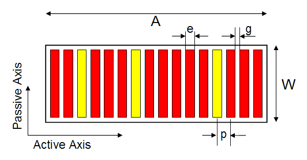

Figure 2 shows the linear array composed of two primary axes: the passive axis and the active axis. The elements lie adjacent to each other along the active axis and phasing is only possible along the active axis. Along the passive axis the sound pressure field behaves according to physical laws applicable to a fixed size radiator. In the array of Figure 2 there are a total of 16 elements (as in case B) but only the set of red elements are functional; the yellow elements are in the active group but are ‘down’ and hence do not generate sound – these are considered to be random failed elements (type 1).
Figure 2 Representation of a linear array and its primary axes, along with the definition of element width (e), gap (g), pitch (p), passive aperture (W) and active aperture (A); the yellow elements are ‘failed’.
Figure 2 Representation of a linear array and its primary axes, along with the definition of element width (e), gap (g), pitch (p), passive aperture (W) and active aperture (A); the yellow elements are 'failed'.

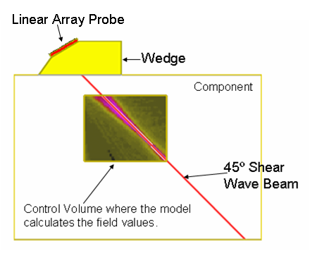

Figure 3 shows the inspection scenario with the linear array probe, wedge and component for case A (45 ° shear wave beam in ferritic steel). From the model outputs the four beam parameters (see Section 2.1) were evaluated. The model output shown in the control volume of Figure 3 is the sound pressure along the axis of the beam. Using this output and the 6 dB field depth of the sound about its focal point, changes in the beam angle due to failed elements can be evaluated. This method of beam angle evaluation based on the field is only possible in case A where the sound is focused leading to a sufficiently small field depth.
Figure 3 Representation of the linear array on its wedge propagating a 45 ° shear wave beam into the ferritic steel component.

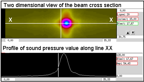

Figure 4 shows the crossbeam at the focal depth of 75 mm for case A. The model output generates a two-dimensional map of the sound pressure and the pressure variation along the line XX (active axis) can be extracted. It is then possible to evaluate the 6 dB beam widths (along the active and passive axes).
Figure 4 The crossbeam at the focal depth of 75 mm (case A) along with the cross-section pressure profile plotted along line XX through the beam.

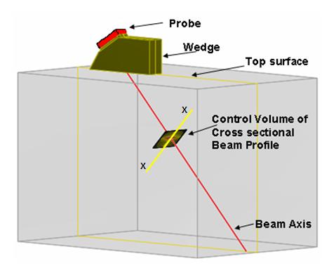

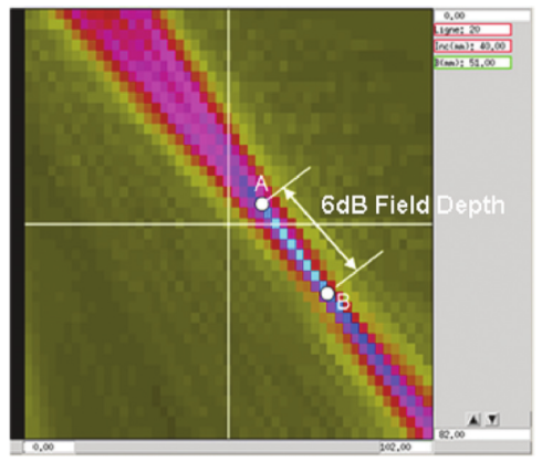

In the present study, data was collected in two types of control volumes:
  • A control volume in the plane of the active axis of the linear array in order to measure the beam angle (as shown in Figure 3);
  • A control volume perpendicular to the main beam axis - 75 mm depth in both cases (as shown in the three-dimensional representation in Figure 5).
Figure 5 The control volume is perpendicular to the beam axis to measure the cross-section profile of the sound beam at a depth of 75 mm.
The cross-section profiles (as in Figure 4) were used to evaluate the beam widths along the active and passive axes. The absolute value of the peak sound pressure of the beam is output by the model; this quantity is proportional to the unit of sound pressure and can be used to evaluate the effect on the absolute strength of the beam due to failed elements.

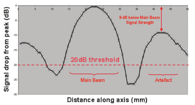

In pulse echo inspection, the primary concern is the strength of any spurious echoes which return to the probe. Hence, the sound pressure output of the CIVA model, which gives the elastodynamic quantity at the evaluation point (control volume), is converted to the equivalent strength of the signal which would be expected at the probe had an echo been generated at the control volume region. In essence, the signal strength that would be recorded by the pulse echo probe is proportional to the square of the sound pressure at the reflector.
2.4 Acceptance criteria
The threshold criterion is based on the strength of beam artefacts due to element failure. An ‘artefact’ is defined as any feature of the sound beam away from the main beam axis, which includes side energy lobes and grating lobes generated by array probes (5). Provided that the pulse echo signal strength from a point reflector due to the beam artefact is equal to or greater than 20 dB below the peak signal strength of the main beam, the integrity of the sound field generated by the phased array probe is considered acceptable.
The threshold value of 20 dB has been chosen as it represents an ultrasonically acceptable difference between an echo of significance and those which are considered to be spurious. In practice, the echo generated by a reflector (flaw or discontinuity) due to the main sound beam could be saturated (that is greater than 100% screen height on the detecting instrument). The signal returned by the same reflector due to the artefacts in the beam could then be significant. The present criterion assumes that the inspection is appropriately calibrated to ensure that echoes from the expected flaw targets will remain below the amplitude level which can be recorded as a finite value by the ultrasonic instrument.
Figure 6 shows the cross-section profile along the active axis of the received signal in pulse echo with six failed elements (in an active aperture of 16) in type 2(b) mode (contiguous set at centre of array). The field strength along the beam axis has its peak signal at 0 dB. There is a strong artefact adjacent to the beam which is 9 dB weaker than the main beam. Following the stated criterion, six random failed elements (out of 16) is not acceptable because the received signal from a reflector due to the artefact can seriously affect interpretation, positioning and sizing.
Figure 6 Example of the cross-section profile along the active axis for an array with six failed elements. The pulse echo signal strength due to the artefact is 9 dB below that from the main beam .

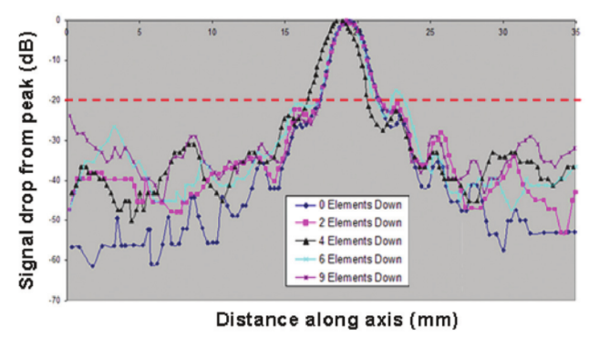

Figure 7 is a summary of the cross-section profiles through the active axis for case A (32 elements in the aperture) showing the relative sound pressure amplitudes. The curves in Figure 7 were plotted along the XX line as illustrated in Figure 4. Figure 7 shows the data as a change from the peak signal strength (of each data set) expressed in dB. The analysis of the data is summarised in Table 3.

Figure 7 The amplitude cross-section profiles along the active axis for increasing number of failed elements of type 1 failure in case A, expressed as a dB signal strength loss relative to the peak signal strength.

The effect on the active axis beam width is a reduction in the measured width; the maximum reduction is evaluated to be 7.5% when six elements have failed. However, there does not appear to be a pattern between change in beam width and the number of randomly failed elements, given the limited number of random failure cases modelled in this study. Hence, to evaluate the actual change in beam width due to a given set of failed elements, that particular case must be modelled.
As expected, the passive axis beam width does not vary with failing elements, which is consistent with the physical laws governing the propagation of the elastodynamic sound from a fixed size radiator.
There appears to be a change in the beam angle as the elements fail. However, it is within the error of 1.5 ° due to the resolution of the models and the method used to calculate the beam angle. Increasing numbers of failed elements will have an effect on the beam angle as the index point is influenced (see Section 3.3).
Note also that this data set is computed using a CW input – ie the frequency content of the input waveform is constant at 5 MHz. This is known to induce the creation of strong side energy lobes in the model outputs in comparison to a PW input where there is a range of frequencies in the waveform (2) . Hence, the strength of the artefacts (such as side lobes) generated subsequently give a pessimistic view. Table 3 shows that when six elements are defective the strength of the pulse echo side lobe is 18 dB below the peak of the main beam. This implies that the beam is not acceptable for inspection based on our criterion. However, it is not possible to put a threshold value for acceptable element failure at six, since when nine elements are defective the strength of the artefact is acceptably 24.8 dB below peak. It appears that the nature of random element failure makes it difficult to provide guidance based on trends. A further model was run with a PW input waveform, which is closer to reality, and three failed elements. In that case the strength of the artefact was 23.8 dB below peak. It suggests that, based on the available evidence for a random type failure in case A, the inspection procedure should allow a maximum of three elements to fail.
The CIVA model is able to evaluate the relative loss in the maximum sound pressure (at the focal point) as an increasing number of elements become defective. This is summarised in the last column of Table 3. As one would expect, as the number of failed elements increases, the maximum sound pressure values decrease, leading to a maximum loss of 2.68 dB when nine elements are defective.
An interesting feature that can be seen in Figure 7 is a shift in the position of the peak signal when four elements are defective, whereas the other curves representing element failure lie close to the case when no elements have failed. The shift in the peak signal in the ‘4 Elements Down’ case is less than 1 mm. The reason is likely to be due to the nature of the failed element distribution on the array (see Table 2) in that they are biased towards one side of the array.

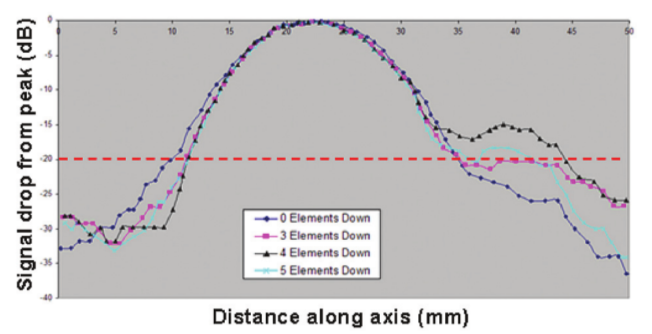

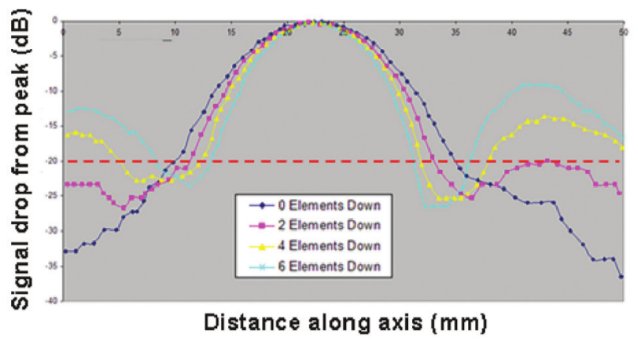

Note that the beam widths (along both the active and passive axes) are significantly larger in comparison to case A. Unlike the type 1 failures of case A, as the number of failed elements increases, the element number along the array is kept constant (see Table 2). As the number of failed elements increases to five elements, the active axis beam width reduces by 7.5%. More significant is the increase in the strength of artefacts, which is only 15.4 dB from the peak value when four elements have failed, making the beam unacceptable with regard to the working criterion.
As before, the loss in beam strength is consistent with increasing numbers of failed elements. Figure 8 shows the cross-section profiles for the cases in Table 4, measuring the change in signal strength to each data set’s peak value (expressed in dB).
Figure 8 The amplitude cross-section profiles along the active axis for increasing number of failed elements of type 1 failure in case B expressed as a dB signal strength loss relative to the peak signal strength.
The failure of three elements leads to the beam being unacceptable according to the criterion – 19.8 dB artefact strength. This implies that the allowable number of failed elements depends on the geometric condition of the particular array. Three failed elements in case A represents a loss of 9.4% of the full sound radiating surface, whereas three failed elements in case B represents 18.8% of the radiating surface. Hence, it may be necessary to approach the acceptable element failure criterion by considering how each failed element affects the total radiating surface. This would then imply that the acceptable number of failed elements depends on other parameters of the linear array: pitch and number of elements in the active aperture. In turn, the dependence on pitch also implies a dependence on the frequency of the probe.

As shown in Figure 1, within the type 2 failure mode the set of contiguous (adjacent) failed elements can be at the bottom (referred to as type 2(a)), about the centre line of the array (referred to as type 2(b)) and at the top of the array (referred to as type 2(c)). In the study, models were run in the type 2(a) and type 2(b) configurations only. It is noted, through logical reasoning, that configuration types 2(a) and 2(c) would have the same effect of rotating the field about the main axis of the beam (represented by the index point and beam angle).

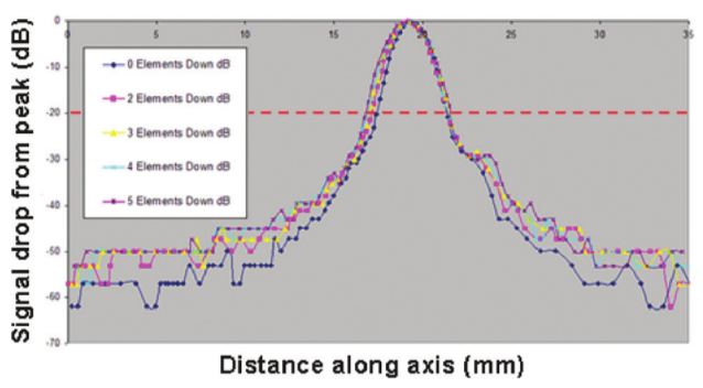

When a maximum of five elements have failed in configuration type 2(a), the loss in absolute signal strength is 1.64 dB. The change in the beam angle is within the accuracy of the evaluation method (1.5 °) – see Section 3.3. The largest effect on the strength of artefacts is only 1.6 dB when four elements are down, as illustrated in Figure 9.
Figure 9 The amplitude cross-section profiles along the active axis for increasing number of failed elements of type 2(a) failure in case A, expressed as a dB signal strength loss relative to the peak signal strength.
When five elements have failed in configuration type 2(a), the effective aperture has been reduced along the active axis direction. This leads to an increase in the divergence of the beam in the far field and a widening of the beam width along the active axis. However, the differences in the beam profiles only become significant well outside the 6 dB beam width of the main beam. Based on this evidence, the stated criterion for the allowable number of failed elements is satisfied in all the models: even after five elements have failed, the generated beam is still acceptable.
Hence, with the available evidence, the number of acceptable failed elements is greater than five when they fail in the type 2(a) configuration. Furthermore, unlike in the type 1 failure, the beam profile is a lot cleaner in the type 2(a) configuration, lacking strong artefacts along the active axis direction.

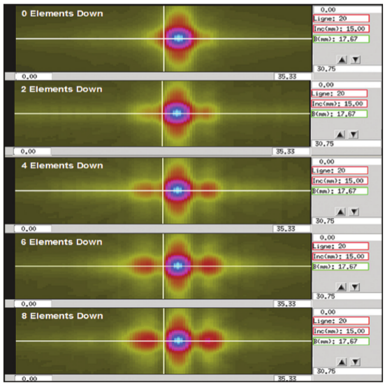

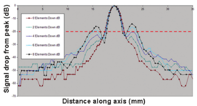

Configuration type 2(b) models (as summarised in Table 5 for case A) show different behaviour to configuration type 2(a). As the number of failed elements increases, the active axis beam width reduces steadily. When eight elements have failed (four either side of the centre line of the array), the active axis beam width is reduced by 12.3%. The increase in the strength of the artefacts is more dramatic: when eight elements are down, the strongest artefact is only 14 dB weaker than the main beam, failing the acceptance criterion. Figure 10 shows the cross-section profiles for case A type 2(b). Figure 11 shows the crossbeams, which is the same data given in Figure 10 but in a two-dimensional representation where signal strengths are plotted using a colour scale, as shown in Figures 4 and 5.
Figure 10 The amplitude cross-section profiles along the active axis for increasing number of failed elements of type 2(b) failure in case A, expressed as a dB signal strength loss relative to the peak signal strength.
The artefacts in configuration type 2(b) are due to diffraction effects (known as grating lobes). Strong sound pressure regions either side of the main beam are due to constructive interference of sound pressure emanating from essentially two sources equally spaced either side of the centre line of the array; the effect due to failed elements at the centre of the array is to divide the array into two separate radiating entities. The artefacts either side of the main beam would be symmetrical had the array not been propagating sound at an angle within the component. As the strength of the beam is dependent on the angle of refraction within the component, the artefact on one side of the main beam (lower refraction angle) is stronger than on the other side (higher refraction angle); this is illustrated two-dimensionally in Figure 11.
Figure 11 Two-dimensional representations of the crossbeams due to failed elements. The area represented is 35.33 mm (horizontally) by 30.75 mm (vertically), and maximum signal strength is represented by bright blue. Case A, type 2(b).
With the evidence available, the acceptable number of elements that can fail is four, based on the 20 dB threshold for artefact strengths (see Table 5). Figure 15 shows that, as in configuration type 2(a), in configuration type 2(b) failure the position of the beam within the component at the focal point does not appear to be altered. The change in beam angle also remains within the error of the method used for its evaluation.

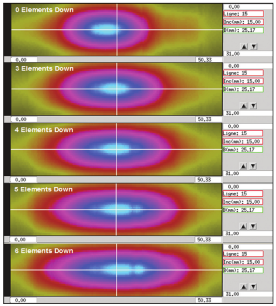

Table 6 shows the summary of the analysis of case B type 2 element failure models. Note that, again, due to limitation on the control volume size it was not possible to evaluate the beam angle using the 6 dB field depth method (see Section 3.3). Another control volume limitation in the available set of data for case B configuration type 2(a) implied that it was not possible to observe any artefacts. The physical differences between cases A and B have been stated previously (Section 3.1).
For case B configuration type 2(a), only model data for the influence of failed elements on the active axis beam width exist (see Table 6). Figure 12 shows the crossbeams of case B configuration type 2(a) for increasing numbers of failed elements. As shown in Table 6, the increase in the beam width when the number of failed elements increases from three to six is 39.4%, which is a greater change than in case A configuration type 2(a) between none and five failed elements (21.2%).

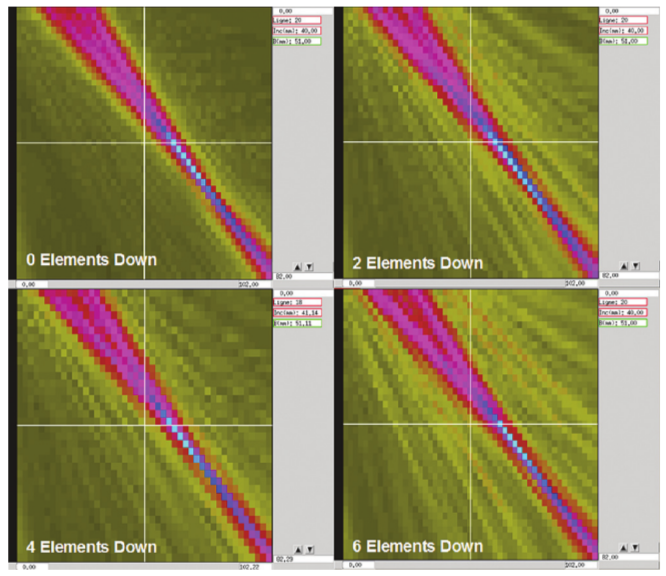

Figure 12 Two-dimensional representations of the crossbeams due to failed elements. The area represented is 50.33 mm (horizontally) by 31 mm (vertically), and maximum signal strength is represented by bright blue. Case B, type 2(a).
Along with the rapid increase in the beam width along the active axis, note the migration of the main beam centre as the number of failed elements increases; this is attributed to the index point migration. The shift in beam centre position is around 5 mm going from no failed elements to six failed elements.
For case A configuration type 2(a) failure, the shift in the position of the beam was small, in comparison to case B configuration type 2(a). Due to the larger pitch size and the increased wavelengths in case B (as opposed to case A), the effects due to configuration type 2(a) are more pronounced. Furthermore, in case A the focal law was designed to focus the beam whereas in case B the focal law was steering the beam; this implies that the shift in beam position due to configuration type 2(a) failure is dependent on the type of electronic phasing applied to the linear array.
In case B configuration type 2(b), the decrease in active axis beam width when the number of failed elements increases from 2 to 6 is 16.5%. The effects of diffraction are dominant in generating the artefacts; when six elements have failed in configuration type 2(b), the strongest artefact is only 8.6 dB weaker than the main beam (see Table 6). The reason why changes to beam widths and artefact sizes are greater in case B in comparison to case A is geometrical, as discussed in Section 3.1. The actual sound radiating area lost due to a single failed element in case A is 3.1% whereas it is 6.3% in case B.
Along with large gap sizes between the two discrete source points while in configuration type 2(b) due to geometry, the failure of just two elements in case B leads to the beam losing its integrity according to the 20 dB threshold criterion; in case A configuration type 2(b), up to four elements could fail before the probe was deemed unacceptable (see Table 5).

Figure 14 shows the beam axis and the definition of the 6 dB field depth of the beam (case A with no failed elements). By plotting the coordinates of points A and B, the beam angle can be evaluated using trigonometry; note that the dimensions of the control volume are 102 mm horizontally and 82 mm vertically.
The resolution of the control volume leads to an inaccuracy in the measured beam angle, which is estimated to be 1.5 °. Due to the limited scope of the study, sufficient models were not run to comment conclusively on the effect on beam angles (such as for case B) when elements fail in the array.
Figure 14 Definition of the 6 dB field depth (case A) is the distance between point A (upstream) and point B (downstream), where field strength is 6 dB below the strength at the focal point (which is in between points A and B).
Figure 15 shows a set of data for case A type 1 (random) failure. The measured beam angles do not vary from the expected 45 ° (within the error of the method) but the resolution is not high enough for conclusive evidence. However, it is possible to see the increase in the sound pressure either side of the main beam focus as elements fail. These artefacts can lead to an increase in spurious echoes in pulse echo testing, which could be from defects or be due to the material itself (for example ‘grass’ noise in coarse-grained materials).
Figure 15 Two-dimensional representations of the beams along axis due to failed elements. The area represented is 102 mm (horizontally) by 82 mm (vertically), and maximum signal strength is represented by bright blue. Case A, type 1.

When contiguous groups of elements fail, their configuration on the array plays an important role in deciding whether the linear array is acceptable for inspection. Furthermore, it appears that the type of phasing that is being performed using the array has an important bearing on the ultrasonic field modifications induced by the failure of contiguous groups of elements:
  1. Failure of a contiguous group of elements on the edge of the array (type 2(a)) leads to a general increase in the beam widths which can impact on the resolution of the inspection. Furthermore, there could be a shift in the beam leading to errors in positioning;
  2. Failure of a contiguous group of elements at the centre of the array (type 2(b)) leads to the generation of diffraction artefacts. These artefacts can be very strong and the severity depends on the frequency (wavelength) of the sound being generated and the gap between two effective radiating surfaces created by the failed element group.
