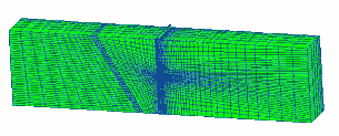

Fig.2 General views of the meshes used for
2a) the nominal-sided 'V' weld
2b) the straight-sided weld
The crack tip is modelled as a narrow notch with a semi-circular tip. This accommodates the crack blunting that takes place in a large strain, non-linear geometry analysis. Figure 3 shows the finite element mesh closer to the crack tip for the normal 'V' mesh.
Large strain, incremental, elastic-plastic analyses are conducted by updating the geometry of the model at each load increment. The incremental analyses are controlled to provide output of results at frequent intervals of loading.
Fig.3. The mesh surrounding the crack tip for the normal 'V' weld, showing the innermost mesh surrounding the crack tip
