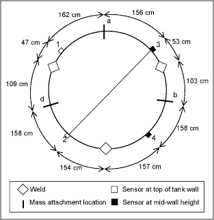

Figure 2 illustrates the different testing configurations and tank states. In the 'active tendon' configuration there were two possible locations of the cable. These were either configuration AT1 or AT2 depending on whether the actuator's cable was connected to location 1 or location 2. Both locations were across diameters of the tank and were at right angles to the each other. The results from AT1 are omitted for brevity. They were generally similar to those presented below for AT2. 'a', 'b' and 'd' represent three separate locations of the attached mass. Please note that the same mass was either attached at either location 'a' to give state W(a), location 'b' to give state W(b) or location 'd' to give state W(d). At no time was more than one mass attached to the tank.
Fig.2. Plan view of tank states and testing configurations (not to scale)

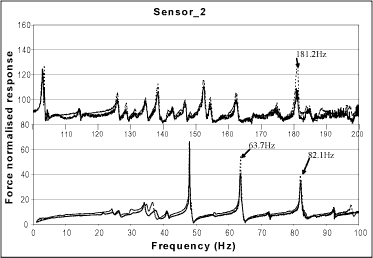

Experiment 1 and experiment 5 were repeat scans of the tank wall with no modification. Examples of the FRFs for each experiment are overlaid in Figure 3(a) (sensor 2). The results for the other sensors are omitted for brevity. Note that in this figure the 100Hz to 200Hz range is stacked above the 1Hz to 100Hz range with an arbitrary offset. Note also that the repeat scans were taken two weeks apart. Between the first and second experiment, the actuator cable was disassembled and then reassembled and re-tensioned. The scans indicated good qualitative agreement between repeat experiments. There did not appear to be any difference in the repeatability between the upper and lower frequency ranges. The closest agreement appears to be in the frequencies of the modal peaks. The amplitudes of the peaks are noticeably more variable,although not excessively so. However it is worth pointing out an exception to this. A small peak appears at 97Hz in the FRF of sensor 2 for one experiment but not the other.
Nevertheless, these results have demonstrated the concept that piezoelectric transducers could be used to excite and detect the lower order modes of vibration in a large industrial structure such as an AST.

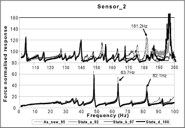

Experiment 2, experiment 3 and experiment 4 were scans of the tank wall with modification 'W(a)', 'W(b)' and 'W(d)' respectively. These FRFs are overlaid for sensor 2 in Figure 3(b). The results for the other sensors are omitted for brevity. Note that in this figure the 100Hz to 200Hz range is again stacked above the 1Hz to 100Hz range with an arbitrary offset. Note also that in this figure W(a), W(b), W(c) and W(d) are represented by state 'a', state 'b' and state 'd' respectively. All three scans were taken over a period of one week.
The first point to note is that, below 140Hz, there is very little difference between the scans for the modified tank (with the single exception of the 90Hz mode at sensor 2 when the tank had modification W(a)). In other words there is generally no sensitivity to structural change below 140Hz. However, between 140Hz and 200Hz there is clearly more difference between the modified states, i.e. the higher frequency range discriminates between locations of structural modification better.
Between 196Hz and 200Hz there were dramatic indications on the spectra of the tank modified with 'W(b)' and 'W(d)' on all sensors but particularly on sensor 2. In some cases, most notably sensor 2, the change in amplitude was verypronounced. The modal amplitudes in this region of the spectrum for states W(b) and W(d) are 12 times the amplitudes in the unmodified state.
Inspection of the 100Hz to 200Hz frequency band reveals that, while the spectra of the tank wall in states W(b) and W(d) are similar to each other, that of state W(a) differs noticeably from both of them. In fact the spectrum ofW(a) is very similar to that of the unmodified tank, suggesting that there was less sensitivity to this modification than for states W(b) and W(d) (there were nevertheless subtle indications of the mass in location 'a' such as the shift in frequency at the mode at 181.2Hz). The explanation for this lies in the symmetry of the tank wall. Figure 2 shows that in state 'd' and state 'b' the mass has approximately the same unequal displacements from the vertical butt welds (~106cm and ~313cm). However, in state A the displacements are approximately equal (156cm:162cm). The response to the modification is dependent on its relative proximity to the welds. As this does not appear to be the case below 100Hz one may assume that in this frequency range the welds do not play an appreciable role in the vibration and the wall vibrates as a continuous sheet.
a) Repeat scans on unmodified tank (measurements taken 15 days apart)
b) Scans on tank modified with 1kg attached mass at A, B and D
Fig.3. Tank wall FRFs at Sensor 2 for stepped frequency scan (0.1Hz step)

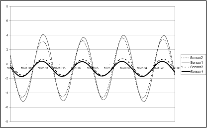

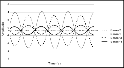

The mode shapes are harmonics of the first ovalisation mode and adopt a standing sinusoidal waveform with amplitude varying from maximum at the top to zero at the bottom of the wall. In addition the excitation force vector suppresses those modes that are not symmetrical about the cable. This property is exhibited all around the whole structure and hence also by the sensors and is characterized by the relative phases of all of the sensors being either0° or 180°. The natural frequencies are called real normal modes of vibration. Figure 4 shows the unmodified tank time histories for modes at 63.7Hz and 82.1Hz ( Fig.3). The phase of sensor 2 is matched with sensor 3 and the phase of sensor 1 is matched with sensor 4 in both cases. This restriction is imposed by the force vector that is generated by the cable. The force vector does however permit sensors 1 and 4, to be either in phase (mode at 63.7Hz) or out of phase (mode at 82.1Hz) with sensors 2 and 3.
a) Mode at 63.7 Hz
a) Mode at 63.7 Hz
b) Mode at 82.1Hz
b) Mode at 82.1Hz
Fig.4. Time histories for the unmodified tank showing phase relationships of real normal modes: a) Mode at 63.7 H; b) Mode at 82.1Hz

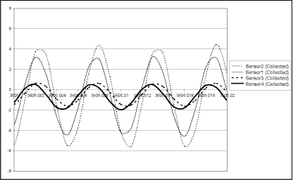

However, above 100Hz the dynamic properties of the welds are different from the parent material and the wall does not vibrate as a continuous sheet. At these frequencies the spatial model of the tank wall can no longer be approximated as uniform. The differences in the damping properties of welds compared with the parent material will produce local variations in the phase at higher frequency modes. These natural frequencies are called complex normal modes of vibration and are characterized by the relative phases of at least one of the sensors being neither 0° nor 180°. In this experiment it was generally exhibited by modes above 100Hz. Note that the phase relationship looks and behaves like a traveling wave, even at and near the amplitude peak. This is a characteristic of the complex mode. [Ewins, 2001] The time histories of the mode at 181Hz ( Fig.3) are illustrated in Figure 5. Here it is clear that there is a degree of complexity in the relative phases of the response at each sensor and this is a property of non proportional damping caused by the welds as previously discussed.

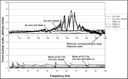

However, more significantly, over the 140-185Hz range the force spectrum exhibited large amplitude fluctuations when the tank was either in state 'b' or in state 'd'. Figure 6 illustrates this phenomenon. These features are not obvious on the response spectra yet on the force spectra they represent prominent indications of the modification. At the lower frequencies where the tank wall vibrates as a continuous sheet the anti-nodes can be expected to always be at the excitation point. However, at frequencies where the properties of the welds differ from the parent material the position of the anti-nodes and nodes become independent of the excitation location l. The force spectrum between 140-185Hz appears to be 'flatter' than below 100Hz because at the modes of vibration the excitation point is not an anti-node so the amplitude fluctuations are of lower amplitude. At locations 'b' and 'd' the attached mass appears to be effective in suppressing several modes of vibration above between 140-185Hz. This is shown by the response amplitude being generally reduced and there are corresponding 'spikes' in the force spectrum. As well as suppressing modes between 140-185Hz, modification 'b' and modification 'd' also give rise to a new modal peak between 196-200Hz and this corresponds to the minimum indicated in Figure 6. The spectral peak is large than other peaks because the force at this minimum is closer to zero that all other modes. A possible explanation is that the modification brings about a mode with an anti-node at the excitation point in this frequency range and that the force is lower because there is less modal damping at these frequencies. The fact that the force and response spectra produce no sensitivity to the mass attached at location 'a' suggests that midway between the welds there is little sensitivity to this structural modification over the whole frequency range.
Fig.5. Time histories for the unmodified tank showing phase relationships of complex normal mode
The reductions in response amplitude between 140Hz and 185Hz together with the sharp rise in amplitude are features commonly observed by noise and vibration engineers. Here the introduction of a structural modification to reduce vibration in a particular frequency range often gives rise to a new mode at another frequency (which does not represent a problem provided that the new mode is outside the operational frequency range). For condition monitoring the new mode is a valuable indication provided it falls within the scanned frequency range as is clearly the case here.
Fig.6. Force measured at excitation point for different tank states
