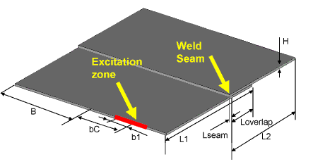

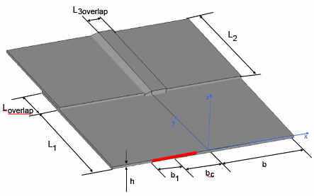

2.1.1 Geometry of the model
The 3D finite element computational model composed of linear elastic elements has been built using ANSYS and LSDYNA finite element codes. ANSYS has been used to generate the volumes and to perform the meshing of the model. The problem is then solved in LSDYNA environment. The geometry of the model generated in ANSYS (APDL internal programming language) is fully parametric. Two models have been investigated:
  • Two overlapping plates welded together, Figure 1;
  • Three overlapping plates, Figure 2.
The parameters used for both sample calculations are presented in Table 1.
Fig. 1. Two plates welded together: H is the plate thickness; B is the plate half-width; b 1 is the half-width of the excitation zone; b C is the centre of the excitation zone; L 1 the 1 st plate length; L 2 is the 2 nd plate length; L seam the width of the seam; L overlap the overlap length
Fig. 2. Three plates welded together: h is the plate thickness; b is the plate half-width; b 1 is the half-width of the excitation zone; b C is the centre of the excitation zone; L 1 is the 1 st plate length; L 2 is the 2 nd plate length; L seam the width of the seam; L 3overlap is the overlap length of the two plates
Table 1. The parameter values used in the calculation
 H,
[mm]
B,
[mm]
b 1,
[mm]
b C ,
[mm]
L 1,
[mm]
L 2
[mm]
L seam ,
[mm]
L overlap ,
[mm]
Two welded plates 6 250 50 0/-100 250 250 6 80
Three welded plates 6.17 249 24.7 24.7 249 249 6 39.1/80
(L3)
The size of an element is selected based on the consideration that 20-30 elements should be used per wavelength.

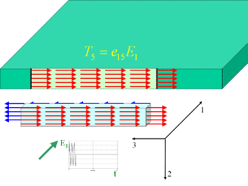

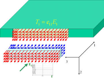

2.1.4 Wave mode excitation
The ultrasonic wave is excited by means of a piezoelectric transducer (PT). Due to the inverse piezoelectric effect phenomenon the PT deforms under the influence of an applied external electric field. The simplest approximation of the phenomenon may be presented by means of the equivalent force diagram, Figure 3. The deformation excited in the PT is defined as
S J = d iJE i,
where d iJ is the piezoelectric strain modulus ( i=1,2,3 correspond to the three longitudinal directions of possible application of an electric field E i ), S J - the strain tensor presented in Voigt's notation ( J=1,2,3 correspond to the three longitudinal components of the strain and J=4,5,6 - to shear strains in coordinate planes xy, xz, yz correspondingly). In approximate evaluations it is usually assumed that the deformation mode of the PT under the electric field E i applied in direction i is determined by the largest value
. The stresses caused by the piezoelectric effect phenomena can be conveniently presented as T J = d iKc KJE i = e iJE i , where e iJ is the piezoelectric coefficient e iJ = d iKc KJ , and c KJ is the stiffness tensor determined under constant electric field. The scheme of stresses in the plate created by means of its interaction with the PT excited by the electric field component E l is presented in Figure 3. The excitation waveform is a 50kHz sinusoidal tone burst.
2.1.5 Exciting waves propagating at an angle to the boundary
The transducers shown in Figure 3 are divided into sub elements. If these are driven uniformly, waves propagating in the direction normal to the boundary of the plate are generated. The transducer elements can be driven with phase delays to generate waves at an angle.
a) b)
Fig. 3. Free body diagram of the excitation of shear (a) and longitudinal (b) ultrasonic waves. Shear (a) or longitudinal (b) stress components are excited in the piezoelectric transducer as a consequence of the electric field component E1 and causes the corresponding interaction stress to be created in the plate

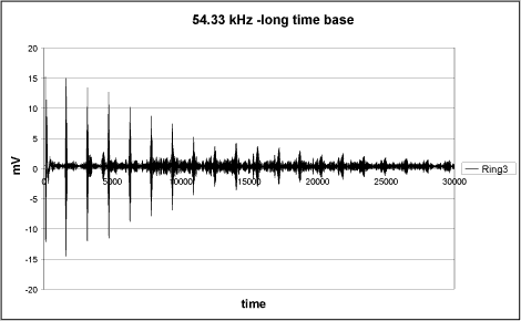

2.4 Experimental results
Experiments have been carried out with a linear array of shear transducers dry coupled to the edge of a steel plate. Propagation distances of over 100 metres have been achieved.
Fig. 13. Experimental result showing 54.33 kHz S H waves propagating in a 2.5m long steel plate
