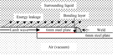

An initial global matrix model [1] (a set of analytical formulae that describe lamb waves in a multi-layer structure) was set up to consider the effect of the varying connectivity possible at a lap joint. The bonding may vary in the region where the steel plates overlap and these variations have influence on the Lamb waves velocities and attenuation. The bond strength between the layers has been considered as three different states: 'perfect', 'poor' and 'slip' [2] . The 'perfect' bond state means that all displacements are transferred through the interface. In this case, the bonding layer properties have been chosen to be the same as the steel plate properties and the bonding layer thickness is relatively small. The 'poor' bond state means that displacements across the boundary are reduced compared with the 'perfect' bonding case at the interface. This was achieved by reducing the longitudinal and shear wave velocities in the bonding layer by a factor of two. The 'slip' bond state means that shear displacements are not transferred through the interface and this state was reached setting shear velocity to 0m/s. A schematic of the model is shown in Fig.1.
Fig.1. Schematic of lap joint model
