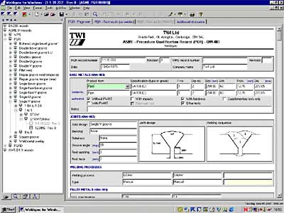

More recent software, such as TWI's Weldspec 4, has been designed to give the welding engineer help in writing and drafting new welding procedures while still giving the benefits of speed and editing of existing procedures. The development of such software has required expertise in a large number of factors, including :
  • World-wide welding and application standards, from such organisations as ASME, AWS, European Standards, etc.
  • Industry practice in developing, qualifying and using welding procedures.
  • Typical interactions between customer, fabricator and inspector.
  • Welding engineering and metallurgy.
  • Software development and knowledge representation techniques.

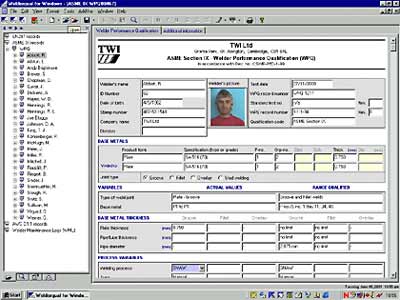

Management of welder performance qualifications is very similar to welding procedures, in that their administration is defined by standards. Thus, the variables that must be recorded, the extent of approval given by a test and the destructive and non-destructive test regimes are specified in National and International standards.
However, unlike welding procedures, welder qualifications are only valid for a specified time without practice or additional testing. Certificates expire, so the date of expiry becomes another key variable and the fast sorting capability of computers is even more beneficial.

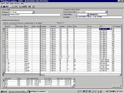

An integrated software system such as TWI's Welding Co-ordinator can overcome all the problems listed above. Such software is designed to be used live to manage fabrication as it is progressing. It is usually based around an electronic 'weld map', or 'weld data sheet' or 'weld schedule', into which data are entered as welds are designed, engineered, welded and tested. The weld map would also usually have some space for approval, either weld by weld, or once a project or structure has been completed. Figure 1 shows an example of part of a weld map suitable for the power generation industry and Figure 2 shows an example of the system as used in the chemical process industry.
Fig. 1. Part of a Weld Data Sheet used in the power generation industry

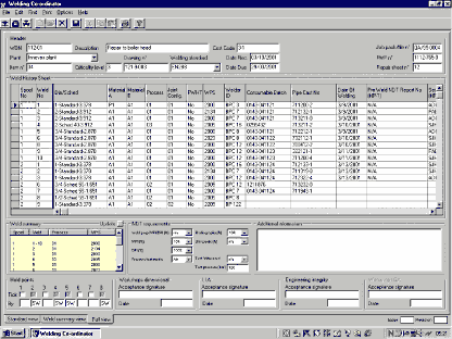

Fig. 2. Part of a Fabrication Inspection Record from the chemical process industry
Data are usually entered into the system from four functions :
  1. At the design stage, where information such as the weld ID number and other design parameters (material type, thickness, joint type, etc) are entered.
  2. At welding engineering, where a welding procedure and possibly class of welder is assigned.
  3. At production, where welders are assigned and the completion of a weld is recorded (usually by entering the date).
  4. At quality control, where acceptance of the weld is recorded by entering test report numbers into the system, or via links to other software systems, such as TWI's NDTspec.
It should be stressed that these data should be entered live into the system, as fabrication progresses.
Screen view of the Welderqual program software

  • Automatic production of test requisitions. The system illustrated in Figure 2 automatically produces NDT requisitions, based on the NDT requirements for the project. These can be selected either manually, or the system could 'randomly' select welds for testing.

  • Automatic update of WPQs. This is a very time consuming task on paper and may be impossible due to the amount of paperwork. However, it is ideally suited for computerisation because it is a simple data sort and test function. The integration between Welding Co-ordinator and Welderqual makes it possible for the system to update all WPQs in a project, based on satisfactory production welds.

Screen view of the Weld spec software program
