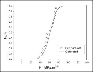

In this study the calibrated Weibull parameters from previous study [5] were used, see Figure 1.
Fig.1. Calibration of Weibull parameter to AR data of C(T) and SENB specimens for A533B material at -170°C [5]
The parameters were calibrated to experimental data obtained from highly constrained specimens, C(T) and SENB of A533B material at -170°C in the as-received conditions. [5] The calibrated parameters were then used to predict the fracture behaviour of a pipe subjected to an initial residual stress field. It was assumed that the same set of Weibull parameters could be used for one material with and without residual stress field. This approach is based on FE analyses. In the following section details of FE analysis of pipe are discussed.

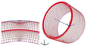

The FE model used in this study is a 432 mm diameter cylindrical vessel with a thumb-nail shape part through circumferential (in the hoop direction) crack on the outer surface, 50 mm long and 5 mm through the 19.6 mm thick wall at its deepest point as shown in Fig 2.
Fig.2. Geometry and crack details for the finite element model
The pipe dimensions were adapted from a previous work by Bouchard and Bradford [23] that had been used for validation of RS fields in welds. Due to symmetry conditions, with the plane of symmetry in the crack plane normal to the pipe axis, only half pipe FE models were produced in ABAQUS/CAE and used in the corresponding analyses. The whole pipe was modelled for use with general loading schemes where analyses involved introducing residual stress field as initial conditions. In the whole model the partial circumferential crack was introduced artificially by the addition of new nodes at the coordinates coincident with the nodes representing the crack face and assigning those nodes to elements on one side of the crack. For the half model the crack was identified by assigning boundary conditions to the remaining ligament at the crack plane, the plane of symmetry. The material used in this study is A533B ferritic steel for which material models at room and low (-170°C) temperature were available from previous research. [5]

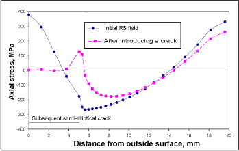

The FE simulations were conducted in two stages. Firstly the as-received (AR) condition was assumed in the analysis. In the next stage, an initial axial residual stress (RS) field was introduced and the local approach was used to predict fracture probability in presence of initial stresses. The latter was named as initial stress-cool-fracture (ISCF). Figure 3 shows the distribution of residual stress in an un-cracked pipe and the redistribution following the introduction of the crack.
The introduction of residual stresses as initial boundary condition took place at room temperature, whereas the material was then cooled to -170°C before final loading to fracture. The initial analysis was used to identify the appropriate node/element sets at the crack front area in order to obtain the stress data files containing the crack front plastic zone for use in the local approach to cleavage fracture. [5] Thus stress and plastic strain data from ABAQUS results were only extracted over the region required and were stored in a data file for use with the failure prediction model. Throughout the load-controlled analyses an appropriate amplitude function was used to control the load application scheme.
Fig.3. Initial residual stress filed

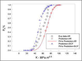

The model used for calculation of probability from Weibull stresses is given by equation (1) and Weibull stress for each increment was calculated by integrating maximum principal stress within the crack tip plastic zone, equation(2).
The failure probability distributions were plotted against stress intensity factors, SIF. The prediction of probability of failure for AR and ISCF are shown in Figure 4.
Fig.4. Prediction of probability of failure for AR and ISCF conditions of a pipe, A533B material at -170°C
The local approach predictions for fracture in the cylinder used the same Weibull parameters calibrated to the SENB and C(T) specimen test data in the as-received conditions of the same material at the same temperature in previous research, see Figure 1. [5] The stress intensity factors (SIF) for the applied primary loads in FE analysis of pipe were calculated based on the solution given in BS7910. [10] There is very slight difference between SIF solution using BS7910 [10] and R6 code [11] for this geometry and load condition. [24]
Also shown in Figures 2 and 4 is the experimental data from previous study where the Weibull parameters were calibrated. The experimental data were ranked and the distribution of experimental data followed equation (3) as suggested by [25] :
 (3)
where N is the total number of specimens tested and i is the order number.
Figure 4 shows:
  • Probability of failure distribution of apparent toughness (SIF) for the highly constraint specimens and pipe are different. This can be due to differences of constraint between the actual experimental data (highly constraint specimens) and the pipe geometry.
  • The effect of initial residual stress field is about 28% reduction in apparent fracture toughness (SIF) at 50% probability of failure.

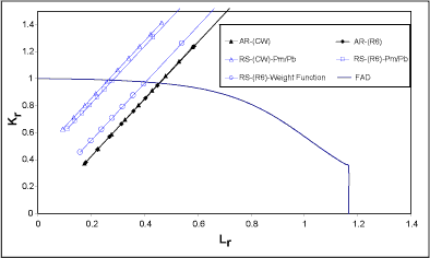

Assessment codes such as BS7910 [10] and R6 [11] assess proximity to failure in a structure using two parameters, K r and L r . K r is a measure of proximity to fracture and L r is a measure of proximity to plastic collapse.
Three cases were considered, and K r and L r were determined using Crackwise [13] and R-code, [14] and plotted on the failure assessment diagram, shown in Figure 5. The three cases were:
Case1: pipe in the as-received condition,
Case2: pipe with an initial residual stress field in which the residual stresses were linearised and membrane and bending stresses were applied as secondary loads, [10]
Case3: pipe with an initial residual stress field in which weight function method was used for determination of secondary load from the residual stress field. [14]
K mat was taken to be the average elastic stress intensity factor of the available experimental data from previous study at -170°C, i.e. 58 MPa.m 0.5 . Both Crackwise and R-code were used for cases 1 and 2 whereas for case3, only R-code [14] was used.
The FAD curve concept, here, was used as 'failure prediction' rather than 'failure avoidance' mode. The intersection of assessment lines with FAD curve were taken as critical (failure) points. Therefore, for each case of 1, 2 and 3there was one critical L r . The effect of residual stress can be quantified by comparing L r values.
Fig.5. FAD diagram of A533B at -170°C
Figure 5 shows:
  • Crackwise [13] and R-code [14] give identical results for case 1 where the critical L r =0.45.
  • There is slight difference (3%) between Crackwise and R-code for case2. However, both show the critical L r at about 0.27, i.e. almost 37% of reduction in critical L r values.
  • For case 3, the critical L r , calculated by R-code is 0.4. It means a reduction of only 11% in L r values.
