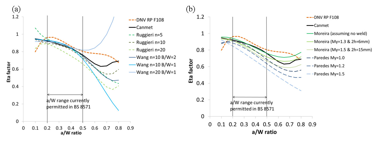

2.3. Eta (η) factor equations
Eta (η) is a non-dimensional parameter which describes the effect of the plastic strain energy of the applied J integral, and is used in the calculation of the plastic component of J (Carvalho and Ruggieri, 2010). The precise details of the equations to calculate η depend on whether it is based on the load-line displacement (LLD) or the crack mouth opening displacement (CMOD) measurements, and on whether it is for pin-loaded or clamped SENT tests. There have been a significant number of sources of different η factors for SENTs in recent years, and most references give a polynomial equation as a function of a/W based on functions fitted to numerical analyses of SENT specimens. In this paper, only the solutions for clamped specimens based on CMOD with specimen length H equal to ten times the width W which have been compared. The solution in DNV RP F108 (2006), equation 3, is based on equations for a stationary crack in parent material, but includes an additional 0.85 factor to allow for effects of weld strength mismatch and strain hardening (Pisarski, 2010). Canmet (Shen et al., 2009) provide a simpler equation, but with a larger number of polynomial orders up to ten, and is considered to be independent of strain hardening. More recent η factor solutions have been published by Ruggieri (2012), which is of a similar form to Canmet but with different coefficients for parent material with strain hardening coefficient (n) of 5 (typical of high strength steel), 10 (which might reflect a structural steel), and 20 (closer to the tensile behaviour of stainless steels). A general form of all these is given in equation 4. These three different approaches were compared by Wang et al (2015), who also offer their own (more complex) approach, where the main coefficients of a0/W are defined as θiχi, the respective components of which incorporate, the strain hardening coefficient, n, and the BN/W ratio of the specimen, as variables. These different parent material eta functions are plotted in Fig. 1a. Specific η solutions for weld specimens have also been published by Paredes & Ruggieri (2012), for different levels of weld strength mismatch ratio, My, up to 1.5. An alternative eta factor equation for weld specimens is offered by Moreira & Donato (2010), based on the weld width, 2h, as well as My, in a twenty-term equation. These eta functions for welds are plotted in Fig.  1b.
Comparison of J Equations for SENT Specimens - Equation 3
(3)
Comparison of J Equations for SENT Specimens - Equation 4
(4)
When these eta factor functions are plotted against a/W ratio in Fig. 1 it is possible to compare them. The DNV solution (even accounting for the 0.85 factor) is higher than almost all of the others. The Canmet solution is close to other solutions for low levels of strain hardening and/or weld strength overmatch. The Paredes weld equations give significantly lower eta factors than Moreira and Donato, and seem conservative compared to the other solutions. The Wang solutions are close to the Canmet solution within the current a/W range in BS 8571 of 0.2 to 0.5, but diverge beyond this. All the solutions presented here have been individually validated against their own numerical models, so it is not possible to identify from this comparison which is ‘best’ in terms of accuracy. However, the Canmet formula is not an outlier and captures the trend of many of the other solutions, so is a reasonable choice of general eta factor solution for SENT tests. The assumption about eta might need to be further reviewed when testing very high weld strength overmatching (My > 1.3) or for very high strain hardening materials (n>10)
Fig. 1. (a) Comparison of plastic eta factors from literature for parent materials with different strain hardening coefficients (n). (b) Comparison of plastic eta factors from literature for welds of different strength mismatch (My) and weld width (2
Fig. 1. (a) Comparison of plastic eta factors from literature for parent materials with different strain hardening coefficients (n). (b) Comparison of plastic eta factors from literature for welds of different strength mismatch (My) and weld width (2h), alongside the DNV and Canmet formulae.

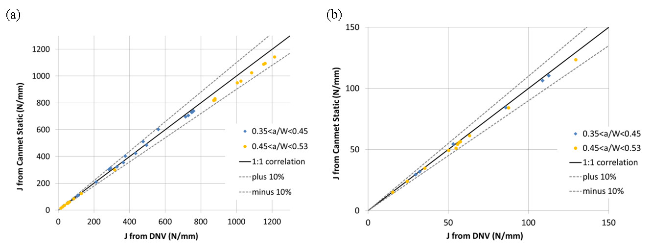

Fig. 3. (a) Full set of data showing comparison of experimental SENT single point results calculated using DNV and Canmet Static equations. Also shown are the 1:1 correlation line and ±10% error lines , (b) selection from (a) but just showing data at
Fig. 3. (a) Full set of data showing comparison of experimental SENT single point results calculated using DNV and Canmet Static equations. Also shown are the 1:1 correlation line and ±10% error lines , (b) selection from (a) but just showing data at low values of J.
The collection of single-point SENT tests data from recent TWI projects is plotted in Fig. 3, with the J calculated using the DNV equation correlated against the J from the Canmet static equation. At low values of J the comparison is dominated by the elastic component of J (Fig. 4b), whereas at high values of J it is the plastic component which has a dominant influence (Fig. 4a). All of the data falls within the 10% error bands around the 1:1 correlation. This means that there is little significant difference in the experimental values of J calculated using either of these methods. The data is shown separately for SENT tests with a/W ratios of 0.35 to 0.45, and for a/W ratio of 0.45 to 0.51. The deeper notch depth shows a slightly lower Canmet Static J compared to DNV at high values of J. The shallower-notched specimens correlate around 1:1 but with more scatter; a/W ratio has less effect for J < 150N/mm.

When a comparison of the two J equations (DNV and Canmet) is made based on a set of experimental test data, there was very little difference between the results of the two, suggesting that for the common SENT applications to date, the errors in the DNV method would not have been significant. The comparison of single point values of J show that there is less than 10% difference between the J determined from the DNV equation and the Canmet static equation. This means that should the J equation in BS 8571 be altered to solely include those from Canmet, the difference in the single point values of J being determined as a consequence would be negligible.
