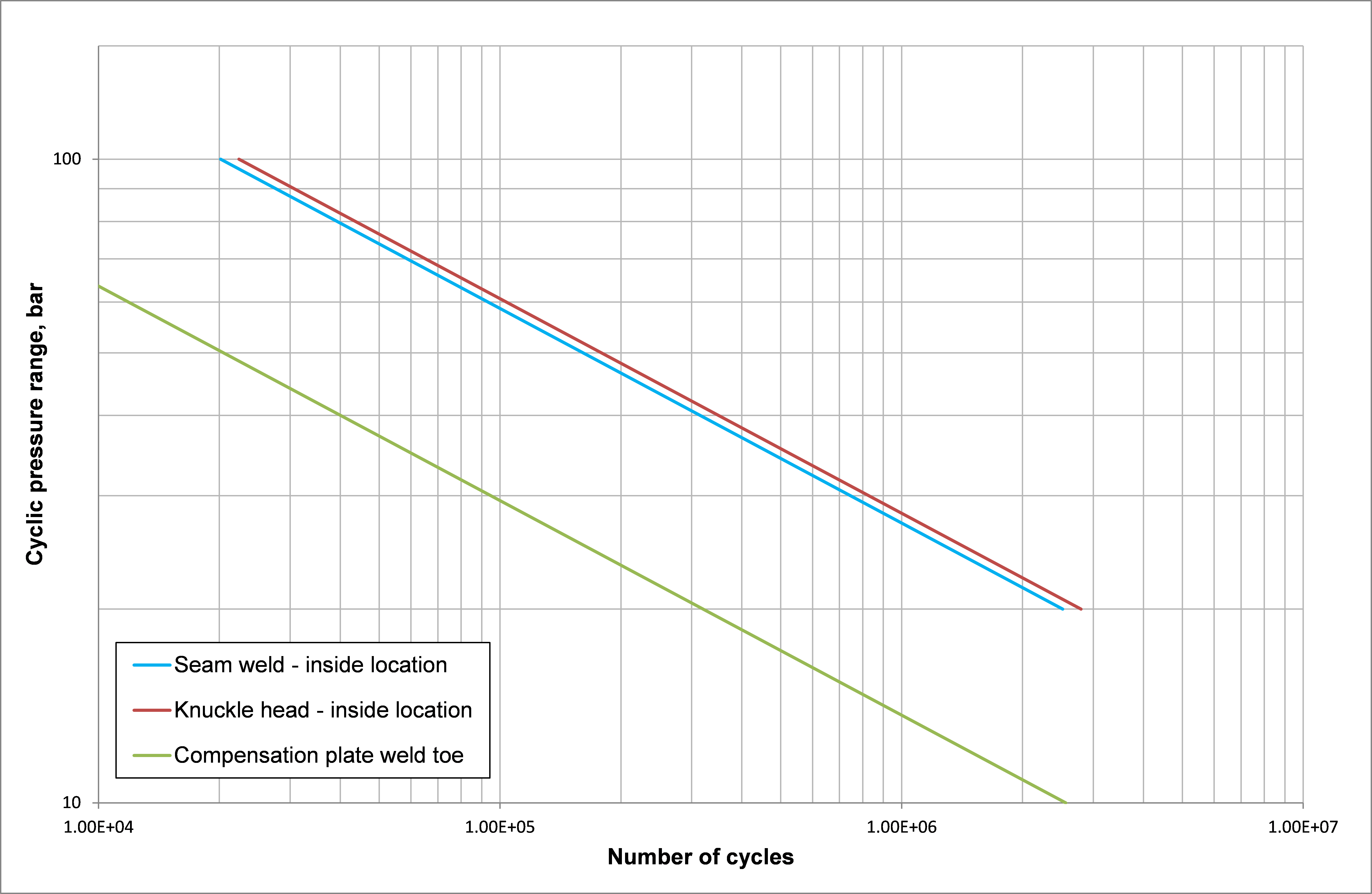

Comparison of the three weld details
The comparison of the design fatigue limits for the seam weld, knuckle weld and compensation plate weld toe using the maximum principal stress approach of EN 13445 shows that the compensation plate weld toe has the lowest fatigue limit. This is illustrated in Figure 9.
Comparing the fatigue analyses, we observe that PD 5500 can give a higher fatigue limit than EN 13445 for the same weld detail where it allows a different classification. We also observe that the fatigue analyses using Tresca equivalent stress range and maximum principal stress range are more conservative than using von Mises equivalent stress range for the same weld Class.
Figure 9 Comparison of weld details using maximum principal stress approach using EN 13445.

For the example of the pressure vessel analysed: it has been shown that
  • The compensation plate fillet weld toe has a lower design fatigue limit than the full penetration seam or knuckle welds.
  • The fatigue assessments based on Tresca equivalent stress and maximum principal stress are more conservative than based on von Mises equivalent stress for the same weld Class.
  • The fatigue assessments based on the structural hot spot stress determined by through wall integration or surface extrapolation are more conservative than that based on nodal force equilibrium.
  • Fatigue assessments made to EN 13445 and PD 5500 are similar except where the standards differ in the classification of a weld detail.
