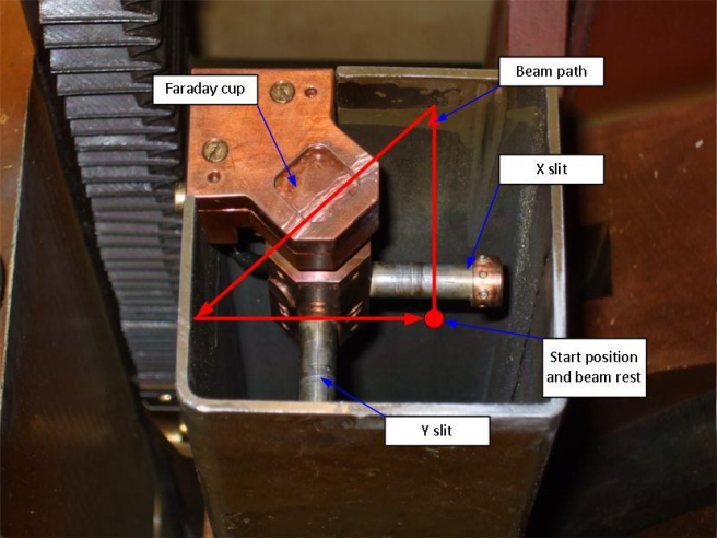

The EB signals were acquired through the two-slit probe which consisted of two probe fingers mounted perpendicular to each other and a Faraday cup. The two probe fingers were used to capture the signal in x and y axes. The Faraday cup was used to measure the full beam current. The experimental set-up to acquire the signals is shown in Figure 1. Because of the high power of the beams, these were not continuously focused on the probe fingers, rather the beam was deflected over the fingers intermittently at very high speed to capture the measurement. The electron beam was deflected over the two-slit probe in the pattern shown in the red. When the beam travelled over the probe fingers, part of the beam current was collected by the Faraday cup of the probe finger which was then converted to a voltage signal through a resistor. This signal was captured either on a digital oscilloscope or through signal processing software on the computer.

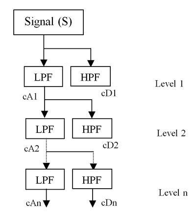

The discrete version of the wavelet transform (DWT) has been used to decompose the discrete signal into components under different scales of fixed wavelet functions called the “mother wavelets” [5, 9]. There are many functions like Harr, Daubechies (db), Coifllets (Coif), Symlets (Sym) that are used as mother wavelets. DWT acts as a pair of complementary high pass and low pass filters and iteratively decompose the signal into multi-resolution subsets of detail (D) and approximate (A) coefficients. The decomposition process of the DWT at different levels is shown in Figure 2. Each level is half the bandwidth of the one level above it.
Figure 2: DWT decomposition levels.
In the present analysis, the entire frequency range is decomposed into 8 levels using db3 mother wavelet. As it is important to choose a mother wavelet having a similarity with the signal to be analysed, various mother wavelets were examined for correlation coefficients [10] and percent root mean square difference [11]. The best results for the signals acquired from the slit probe were achieved using the db3 wavelet function. Also, the number of decomposition levels depends upon the sampling frequency of the acquired signal. In this case, the signal was captured with a sampling rate of 25MHz. Multi-signal analysis in 1-D has been carried out using proprietary software [12]. Figure 3 shows the decomposition levels of one of the probe signals.

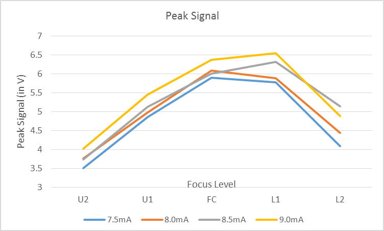

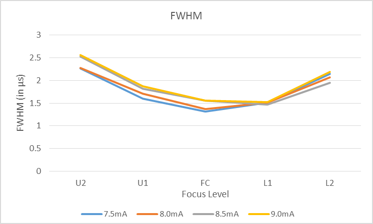

Figure 4 and Figure 5 represents the peak signal and FWHM respectively with respect to the different beam currents and the focus levels set around the sharp focus setting.

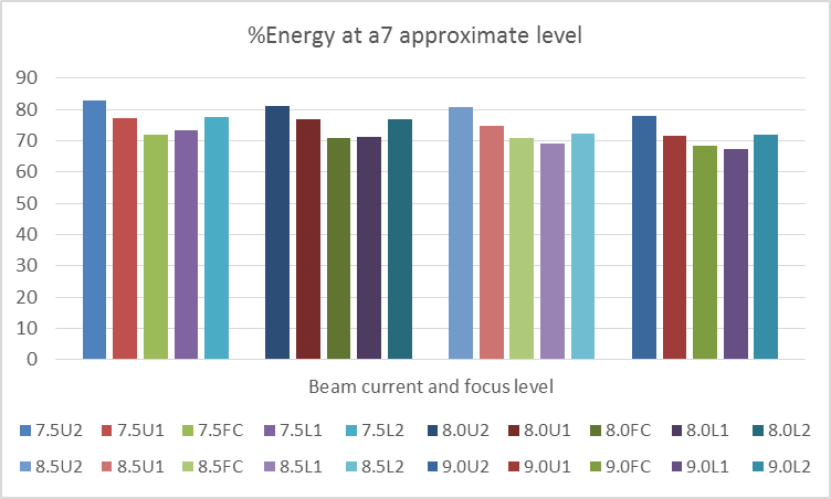

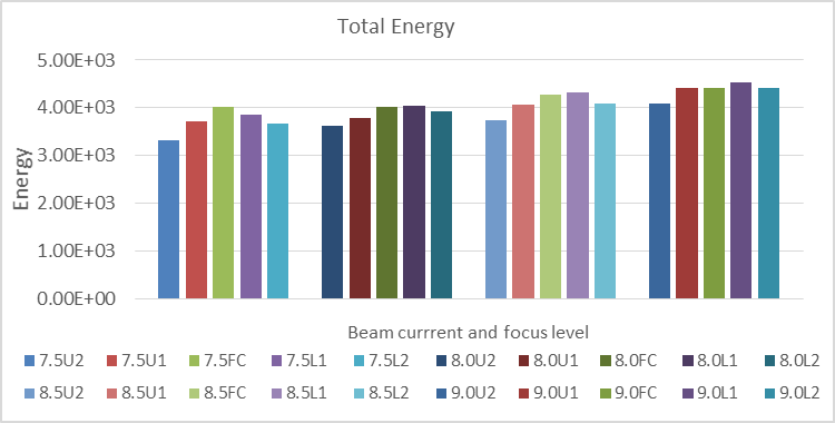

The acquired signals were processed using wavelet transform. The signals were decomposed into 8 levels. The total energy of the signals and their distribution among different decomposition levels were considered as the features vector as mentioned in the earlier paragraph. Figure 6 – 10 represents the total energy of the signals at different beam current and focus levels, the distribution of energy at d8, d7, d6 decomposition levels and a8 approximation level respectively.
Figure 6: Total energy of the signals.

The features extracted in the above paragraphs give a clear distinction of differing beam qualities at different input settings of beam current and focus levels. The peak signal values and FWHM indicated the trends as expected. At larger beam currents, the peak values were increasing and at sharp focus showing the maximum. Similarly, at sharp focus settings, the peak values were at maximum and decreasing either side i.e. at over-focused and under-focused levels. FWHM was narrowest at the sharp focus and becoming broader on either side. However, it was observed that the peak values at 8.5mA and 9.0mA were slightly shifted towards the lower focus levels i.e. L1. Also, the FWHM values representing the sharp focus were also shifted. From this, it was appearing that the sharp focus had shifted towards the lower focus level as the beam current was increased. This was in line with the explanation given in [13] i.e. the focus of the beam depends on the focus coil current as well as on the control-electrode voltage. Although the focus coil current for a typical setting is constant, however, the control electrode voltage changes with the beam current. Hence, the shift in the sharp focus at higher beam currents was observed.
The wavelet coefficients indicated that there were no high frequency components above about 400kHz. In a few signals only a small portion of the energy was observed. Other than the last approximation i.e. a8, rest of the energy was distributed among detailed levels d8, d7 and d6. The maximum change in the energy level was found in d7 around 76% from minimum to maximum value. The distribution of the energy percentages in these levels showed similar trends as that of peak values and FWHM i.e. the energies at these levels were increasing as these were moving towards the sharp focus as well as the levels were increasing with the increase in beam current. The lower levels of energy towards the sharp focus in distribution at approximation level a7 also indicated that as the beam was more focused, the low frequency contents decreased and higher frequency contents increased (i.e. the pulse shape becomes sharper). Also, the energy distribution among the detailed levels d8, d7 and d6 might be due to the pulse width that varies between 4 – 12µs and was represented by the frequency bands of these details levels.
The results of the work show that there is significant differences between the energy distributions among the decomposition levels. Even a 0.5mA difference in the beam current gives sufficient difference in the energy levels distribution. This suggests that the features distinguishing between different beam quality traces may dominantly lie in the total energy of the signal and their distribution among different decomposition levels. Through this work, it has been demonstrated that the wavelet transforms can potentially be used in characterising the probe traces to define features vector for the beam quality.
