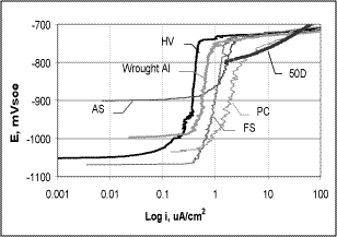

Anodic polarisation plots from the tests performed at 20°C are shown in Fig.2. It is noticeable that the uncoated steel (50D) is corroding very rapidly. This is shown by the immediate rapid increase of anodic the current density upon a small increase of potential from 'E Corr .' Figure 2 shows that all the coatings, including the wrought aluminium displayed a passive potential range shown by low current densities at potentials positive to E Corr , up to a breakdown potential of about -750mV sce . However, some differences in passive current densities can be seen between the coatings. Figure 2 shows the HV coating had the lowest passive current density and was similar to that for the wrought aluminium. The HV, FS and PC sprayed coatings as well as the wrought aluminium showed E Corr in the range of -1000mV sce . The AS coating displayed a less negative electrode potential 'E Corr ' at about -900mV sce .

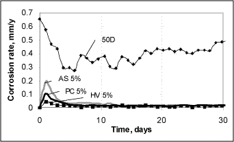

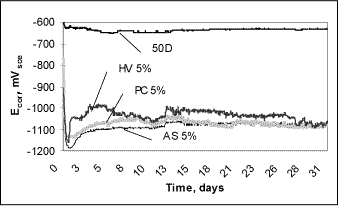

The free corrosion potentials of the coatings with a 5% holiday reach stable values by approximate 15 days, Fig.3. The arc sprayed coating with a 5% holiday (AS5%) and the Purecoat coating with a 5% holiday (PC5%) both displayed similar stable potentials of about -1080mV sce . The high velocity flame spray coating with a 5% holiday (HV5%) recorded a slightly less negative potential of about -1030mV sce . However, after 27 days of exposure all the coatings with a 5% holiday reached similar stable potentials of about -1080mV sce . This potential range of -1030 to -1080mV sce for the specimens with a holiday in the coating is sufficient to provide a good level of cathodic protection to the steel substrate. The stable free corrosion potential of the uncoated steel submerged in a similar solution was about -630mV sce . A cathodic protection potential requirement of -800 to -1050mV Ag/AgCl for submerged steel is well documented in various literatures. [9] Corrosion rates of the specimens with a 5% coating holiday and of the uncoated 50D specimen, calculated using the LPR technique are shown in Fig.4. These corrosion rates were calculated using the literature values of 'B' given in the experimental section.
Fig.2. Anodic polarisation in nitrogen purged 3.5wt% NaCl solution, 22-25°C, pH 7.9-8.2
Fig.3. Free corrosion potentials in aerated 3.5wt% NaCl solution, 22-25°C, pH 7.9-8.2
Fig.4. Corrosion rates in aerated 3.5wt% NaCl solution, 22-25°C, pH 7.9-8.2

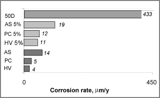

 Fig.5. Corrosion rate obtained from the stable corrosion rate region on day 21
Calculated corrosion rates for the various coatings (without and with a 5% holiday) and for the uncoated 50D steel specimen are given in Fig.5. The uncoated 50D steel specimen displayed a very high corrosion rate of about 433µm/y after 21 days of immersion, as expected. For the coatings with a 5% holiday present, corrosion rates were obtained in the range of 10 to 20µm/y. For the PC and HV coatings without a holiday, corrosion rates were low in the range of 4-5µm/y, whereas for the AS coating without a holiday, the corrosion rate was high and was about 14µm/y. The data inFig.5 show lower corrosion rates for the coatings produced using the high velocity (HV) and the Purecoat (PC) systems than for the coating produced using the arc spray (AS) system, in both conditions i.e. without and with a 5%holiday. These corrosion rates are estimates for the test duration of 31 days investigated in this work and provide a good comparison between the coatings produced by conventional and newer thermal spray systems in a 3.5wt% NaCl solution.

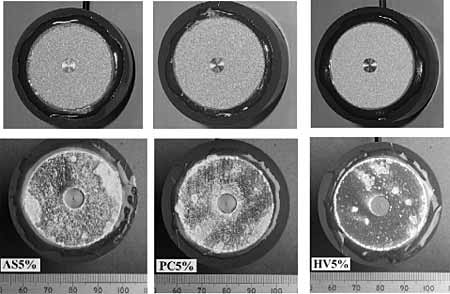

The very high corrosion rate of the uncoated 50D steel specimen on completion of the corrosion test was clearly discernible with a loss of substantial steel thickness (not shown in this paper). The surface of the coated specimens with a 5% holiday (AS5%, PC5% and HV5%) after the immersion test are shown in Fig.6. Closer examination of the holiday area from the coated specimens did not show any sign of corrosion on the exposed steel surface. The exposed holiday surface was fully protected and appeared unaffected due to immersion in the test solution, except that the machined surface had lost its glossy appearance due to a thin film build-up on the exposed steel surface. The coating surface exposed to the salt solution displayed a dark film build-up and some white corrosion product. The white corrosion product is believed to be the hydrated aluminium oxide 'bayerite'. Figure 6 also shows the least white corrosion product on the HV 5% coating surface.
Fig.6. Surface of the coated specimens with 5% holiday (top) before test; and (bottom) after 31 days of immersion in aerated 3.5wt% NaCl solution, 22-25°C, pH 7.9-8.2

The results of the electrochemical polarisation tests conducted in a nitrogen-purged 3.5wt% NaCl solution at 20°C, suggest that there are some differences between the coatings produced by various systems. In particular, the conventional arc sprayed coating was shown to have an E Corr of about -900mV sce , which is about 100mV less negative than the potentials shown by the coatings sprayed using the newer systems. This less negative potential is believed due to the higher amount of oxide and porosity in the arc sprayed coating, giving a mixed potential of the coating and steel system upon immediate exposure to the test solution. The HV wire flame sprayed and the Purecoat arc sprayed coatings displayed a large passive region, where the current density was low, during the anodic polarisation scan. This large passive region was similar to that seen with the wrought aluminium and suggests that the coating on its own could act as a highly protective barrier. The conventional arc sprayed coating did not display such a passive region.

The steady free corrosion potential 'E Corr ' values of the unsealed coating with a 5% holiday produced by the conventional arc, shrouded-arc and high velocity flame spraying systems after 10 days were about -1030 to -1080mV sce . This mixed potential range for the TSA/steel system indicated that the exposed steel was sufficiently polarised and protected. The potential range is similar to the NACE and NORSOK recommended cathodic protection potential range of -800 to -1050mV Ag/AgCl . The good level of cathodic protection to the exposed steel was confirmed by examining the test samples after 31 days, which showed no corrosion attack of the exposed steel surface at the holiday region.

Corrosion rates calculated from the LPR values were used to determine the rate at which the aluminium coating was lost when immersed in a 3.5wt% NaCl solution at a temperature of 22-25°C. The calculated corrosion rates were assumed to be due to dissolution of the aluminium coating only and were not contributed to by the underlying steel or due to the exposed steel substrate. The corrosion rates of TSA coatings produced with these newer systems with a 5%holiday were about 11-12µm/y. The corrosion rate of the conventional arc sprayed coating with a 5% holiday was about 20µm/y, which is about two times higher than the coatings produced by the newer systems having a similarsized holiday. The corrosion rates for the specimens without a holiday were substantially lower than for the specimens with a 5% holiday. This suggests that a 5% holiday will increase the rate at which the aluminium coating is lost. Reports in the literature indicate that longer-term protection can be expected in seawater based on field trials and actual service experience. In seawater, the corrosion rate will be lower due to the formation of a calcareous deposit on the exposed steel (cathode) and corrosion product films on the TSA (anode) surface and hence a longer coating life.
