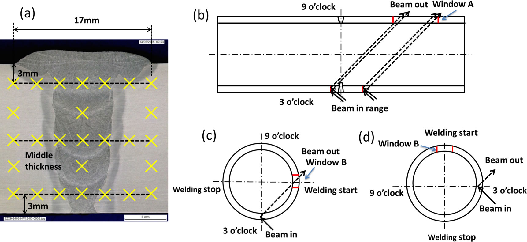

The components investigated were made of API 5L X65 pipeline material. The dimensions of the girth welded pipe spool that used for stress evaluation by neutron diffraction were in 355.6mm (14 inch) outside diameter, 19.1mm wall thickness and 1000mm length. A six-pass narrow-gap girth weld was located in the middle of the pipe spool. The welding and PWHT procedures were described in a previous publication [14]. At this point, it is worth noting that both furnace and local post weld heat treatment methods were employed in this study but the results concerning local PWHT are discussed in this paper.
For the evaluation of the welding residual stresses, three line-scans parallel to the axis of the pipe spool were carried out. They were located 3mm below the pipe outer surface, 3mm above the pipe inner surface and at the mid-thickness. Through thickness measurements were conducted at weld center and weld toes. A set of measurement points across the weld in parent metal, heat affected zone and weld material are show in Fig. 2a. A window cut was introduced for measuring the axial strain component (Fig. 2b) before embarking on the measurements in as-welded condition. This window greatly reduced path length travelled by the neutrons.  For the measurement of the pipe spool in post heat treated condition, another window was introduced for hoop strain measurements (Fig. 2c and 2d). Following PWHT, residual strain components were measured at the same locations as in Fig. 2a.
Fig. 2 Measurement locations and reduced travel path of neutrons after cutting a window on the pipe spool

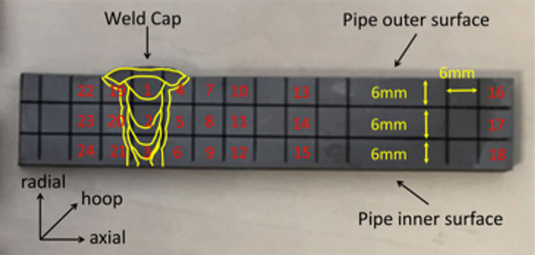

Stress-free comb sample (d0 sample) was extracted from another pipe spool which was fabricated using the identical welding procedure. This sample was cut from the 3 o’clock position to make sure that the target micro-structure and geometry is replicated. The d0 comb sample was 6mm thick and 95 mm long, containing the whole weld cross section and part of the parent material (Fig. 3). The strain component directions were defined the same as the corresponding orthogonal (axial, hoop and radial) directions in the pipe. The slits in through pipe thickness direction were cut by Electrical Discharge Machining (EDM) and repeated every 6mm to create the ‘teeth’ on the sample. Additionally, two line-cuttings were introduced perpendicular to the “teeth” to manufacture 6x6x6 mm3 grids on the comb sample. These procedures enabled the welding induced residual stresses in the comb sample to relax in hoop, axial as well as radial directions, and are supposed to provide the sample in a strain-free condition.
There were 24 points measured on the stress-free sample. The numbers shown in the Fig.3 demonstrate the scanning points sequence on the grids. With the given gauge volume 3x3x4mm3, the measurements in three directions for each point were carried out focusing the beam at the center of each grid. At each scanning point, lattice spacing parameter d01 (supposed stress free lattice spacing in the as-welded condition) was measured in three orthogonal directions. The comb sample was subject to the same PWHT procedure as the pipe spool so that the same PWHT procedure is replicated on the comb. Lattice spacing parameters in it were measured again to obtain new lattice spacing d02 values (stress free spacing after PWHT) for the evaluation of the residual stress state.
Fig. 3 The grid sample for calculating the strain-free inter-plane spacing
Assuming that hoop stress in the grid sample was completely relaxed during EDM cutting, 24 convoluted d-spacing values were calculated by using Hook’s Law for each point. Averaging the values obtained from parent metal (from point 7 to point 18 and point 22 to 24), d01p was calculated and selected as the strain-free d-spacing to calculate the relative strains in hoop, axial, normal directions as well as the convoluted strain variation in the parent material. These values provided the information regarding the strain variation hence the stress magnitude variation. After PWHT, all the data were analyzed following a similar procedure. An averaged strain-free d-spacing value was obtained from all the measurement locations in the parent material which was defined as d02p. Strain variation in the weld metal and parent metal was compared as well. In this work, the lattice spacing in HAZ was not able to be accurately measured. This is because the HAZ was only 1mm wide in the narrow gap weld which was much smaller than the individual dimensions of the gauge volume.

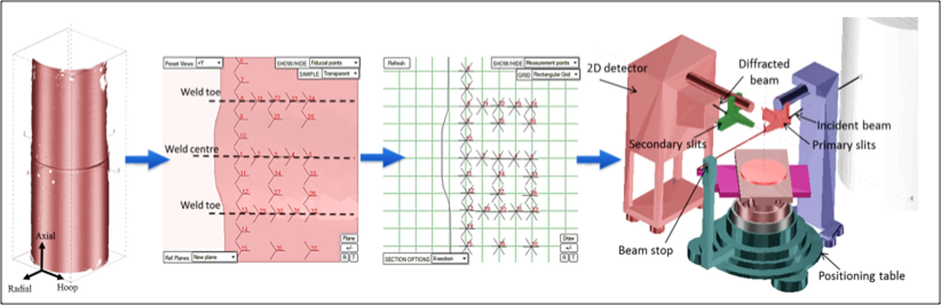

Due to the large scale and complexity of the components to be measured, careful planning of the experiment was of great importance. KOWARI virtual instrument within Strain Scanning Simulation Software (SScanSS) [16] was adopted to plan and locate the measurement points accurately and maximize the efficiency of the experiment. The software was used in the planning and execution of measurement of the residual stress on both the pipe and the d0 sample. Prior to neutron diffraction scanning (Fig. 4 left), 3D models of the pipe and the d0 sample were created by laser scanning the surfaces. Measurement points were positioned on the sample models and the scanning sequence was displayed as the point number. Each scan was simulated to predict the measurement time and to check the orientation of the sample.
Fig. 4 The adoption of SScanSS software to pre-design the measurement points on the laser scanned 3D pipe model

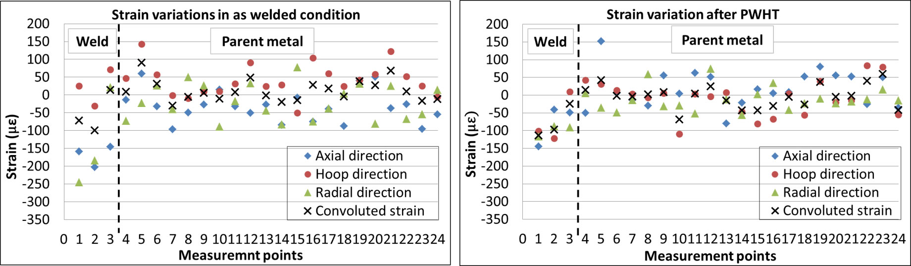

Strain values in the reference sample in as-welded condition were calculated using the d01p values shown in Fig. 5a. The values following PWHT (Fig. 5b) were calculated using d02p. These strain distributions illustrate the strain variation in the d0 sample. In Fig. 5a and 5b, it also emphasizes the importance of selecting position dependent (weld metal, heat affected zone and parent metal) d0 values for calculating the residual stresses.
Figure 5. Strain variation based on selected reference d-scpacing values
In the as-welded condition, the averaged d0 value, designated as d01p, was selected to calculate strains in the parent material. There was approximately less than 100με variation and this leads to approximately 20MPa stress deviation in any single direction. However, in the weld metal, higher strain variations exceeding 200με occurred in axial and radial components resulting in up to 50MPa stress error. Therefore, position dependent d0 values obtained from the weld of the stress free sample should be used to evaluate the stresses in the weld metal of the pipe in the as-welded condition.

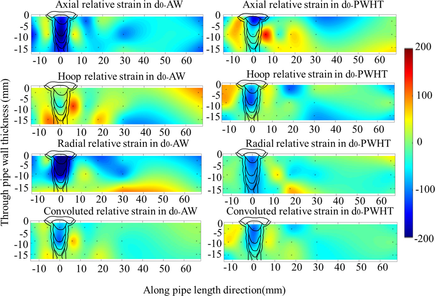

In the PWHT condition, the use of averaged d0 value, designated as d02p, exhibited smaller strain variation in all directions as well as the convoluted strain. This d-spacing valued was used for the calculation of the stresses in the parent material after PWHT. The variation in the strain in the weld metal was less than 100με. However, it is also worth noting that the stresses remaining in the component following PWHT were significantly smaller. Therefore, for the evaluation of the stress state in the weld region, an averaged convoluted d0 value obtained from weld metal measurements (measurement points 1, 2 and 3) was used, see Fig. 6.
Fig. 6 Normalized strain variation maps of the comb sample before (left) and after (after) PWHT

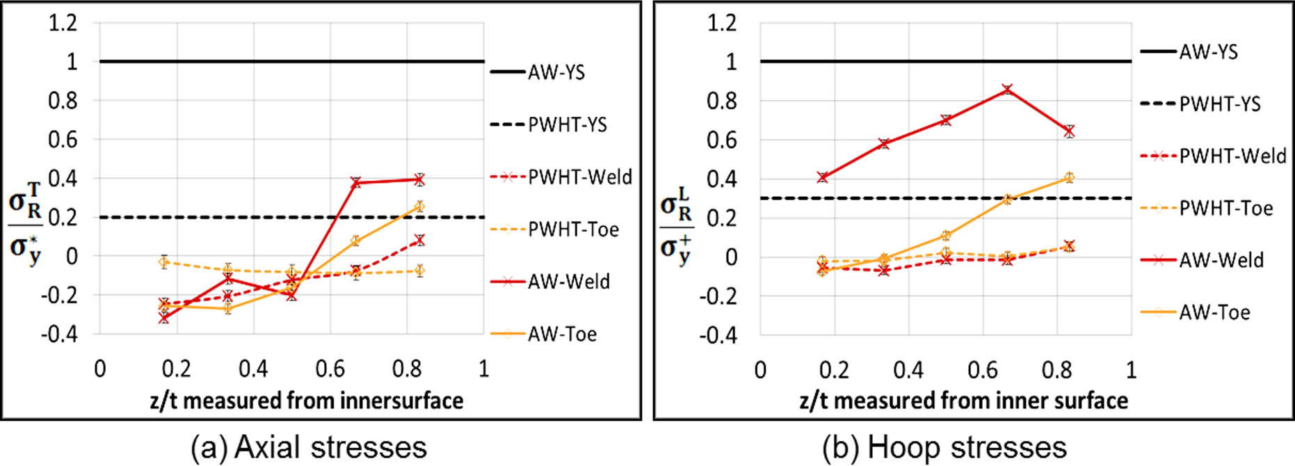

3.2. Residual stress states before and after PWHT
Residual stress profiles in through thickness direction in the as-welded and post weld heat treated conditions are shown in Fig.7. Hoop stresses were normalized with respect to the greater ( \(σ_y^+\) ) of the weld and parent material, and axial stresses were normalized with respect to the lower value ( \(σ_y^*\) ) of the two [15] using the 0.2% proof strength of the parent material and weld metal. The weld was overmatching. Yield strength of weld metal ( \(σ_y^+\) ) was 657MPa and this value was used for normalizing the hoop stresses. For normalizing the axial stresses, parent material yield stress ( \(σ_y^*\) ) 510MPa of was used.
Through thickness residual stress profiles at weld center and toe were presented in Fig.7. Compared to the uniform, yield magnitude profile advised in BS7910 for the as-welded condition, much lower residual stress values were obtained from the measurements in the as-welded condition. Following PWHT, it was seen that axial stresses reduced to less than the 20% of yield strength of the parent material at room temperature. Hoop stresses were significantly lower than 30% of the yield strength of the weld metal at room temperature.
Figure 7. Normolised througth thickness residual stresses at weld center and toe before and after PWHT
