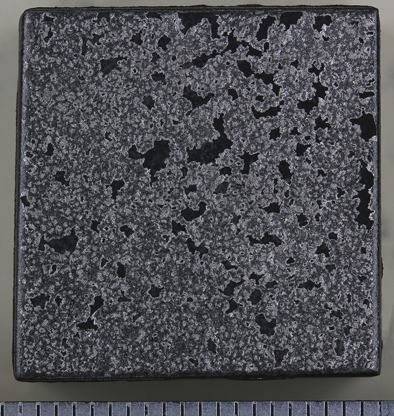

The coupons were ultrasonically degreased in acetone and loaded into alumina crucibles prepared as described above, then covered with fine rutile (TiO2) powder to further simulate the microenvironment experienced in service. Toluene was not used. The test cell was purged with nitrogen (2h, 1L.min-1) and then heated to 600°C. A test gas with higher carbon activity (90%CO-2.5%H2-Ar) was introduced and the test cell then heated to 1100°C. The test gas was flowed over the samples at 0.15L.min-1 for 336 hours at 1100°C. Four coupons were tested at a time. The test cell was then purged with nitrogen and the samples extracted and cross-sectioned for microstructural analysis by light microscopy and SEM/EDX. This included measurement of penetration depth, i.e. the deepest point at which the microstructure had been affected by the environment. Mass change results are not presented for these trials due to varying amounts of partially reduced/reacted Ti oxides tenaciously adhering to the surface, as shown in Figure 1. The powder was analysed by x-ray diffraction.
Figure 1: UNS N06601 (tested in the as-received surface condition) after 336h at 1100°C in flowing 90%CO-2.5%H2-Ar while under TiO2 powder. A millimetre scale is included.

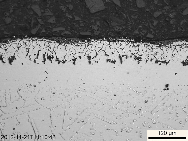

When tested under 10%CO-1%CO2-Ar, UNS N06601showed a mixture of carburisation and oxidation, with black particles visible along grain boundaries (example in Figure 2) at depths of up to 150µm. Mass gains varied from 3.6-4.9g.cm-2 depending on surface finish. EDX confirmed the presence of complex corrosion products on the UNS N06601 surface rich in Cr, O, presumably chromium oxide. Chromium and carbon-rich regions were nearer the surface, alongside detached pieces of substrate. Intergranular attack was present below, with dark particles at the grain boundaries primarily consisting of Al, O presumably Al2O3. This indicates minimal oxygen diffusion along the substrate into the grain boundaries; under a more oxidising environment the formation of chromium oxides would be expected to dominate2 (p[O2] for formation of Cr2O3 is ~10-19atm at 1100°C vs ~10-31atm for Al2O3). No microstructural difference was observed between the four different surface finishes post‑testing, but in all cases the surfaces and cross‑sections appeared less corroded and had a different appearance than the proprietary industrial cell. This gas mixture was not judged to be a suitable simulant for this service.
Figure 2: Light micrograph of UNS N06601 cross-section (tested in the polished surface condition) after 336h at 1100°C in flowing 10%CO-1%CO2-Ar.

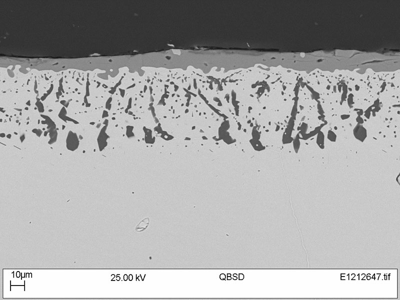

The surface finish of UNS N06601 did not significantly affect the extent or mechanism of corrosion, with penetration depths ranging from 91µm (heat treated) to 105µm (as-received), likely the same within the range of experimental error. Figure 3 shows an example. Below the affected region the composition was unchanged but Al and O (indicating Al2O3) were present along the grain boundaries. The metallic region was depleted in chromium and the surface oxide layer correspondingly enriched with both chromium and titanium. Local aluminium enrichment was observed in some regions of the scale.
Figure 3: Scanning electron micrograph of UNS N06601 cross-section (tested in the polished surface condition) after 336h at 1100°C in flowing 90%CO-2.5%H2-Ar while under TiO2 powder.

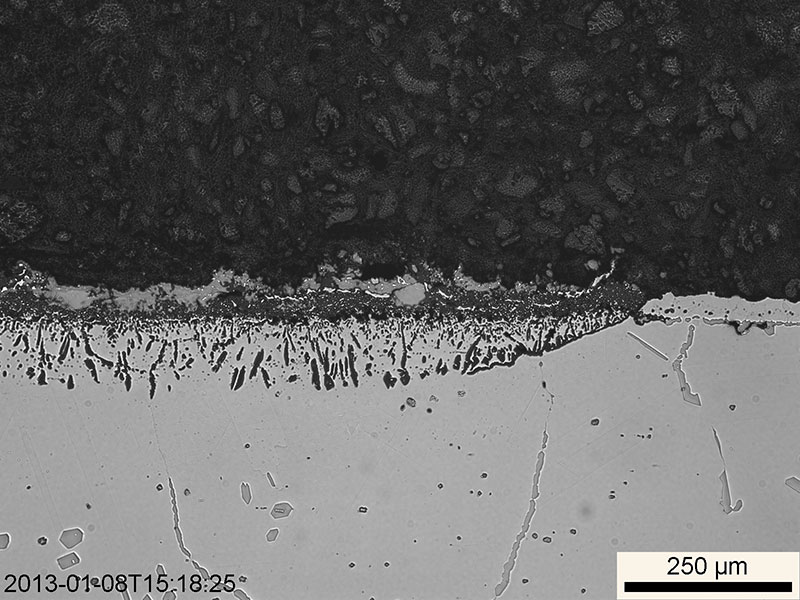

Examination of aluminide diffusion coated samples pre-test verified that the coatings were coherent, non-porous and covered the entire outer surface with no visible cracking. The microstructure showed a rough outer layer, a middle layer with voids at its base and an inner layer with filamentary penetration into the substrate, including diffusion of aluminium and formation of a metallurgical bond between coating and substrate. The observed attack on coated substrates depended on local coating behaviour. For UNS N07214 and UNS N06025, there was little or no attack where the coating was present. Where significant regions of the coating had been damaged, the attack was similar to that on uncoated coupons of the same materials (Figure 4). The coating microstructure had also changed, with the formation of a mixed aluminide layer with voids remaining in the coating. For UNS N06601, only a small flaw was present in the coating, this lead to massive grain boundary precipitation radiating outwards from this region. For all three coated alloys, the attack was deeper than observed on uncoated substrates, but only in regions where the coating was damaged.
Figure 4: Light micrograph of beta-aluminide coated UNS N06601cross-section after 336h at 1100°C in flowing 90%CO-2.5%H2-Ar while under TiO2 powder. Grain boundary precipitation is visible for several hundred µm below this region.
Figure 4: Light micrograph of beta-aluminide coated UNS N06601 cross-section after 336h at 1100°C in flowing 90%CO-2.5%H2-Ar while under TiO2 powder. Grain boundary precipitation is visible for several hundred µm below this region.

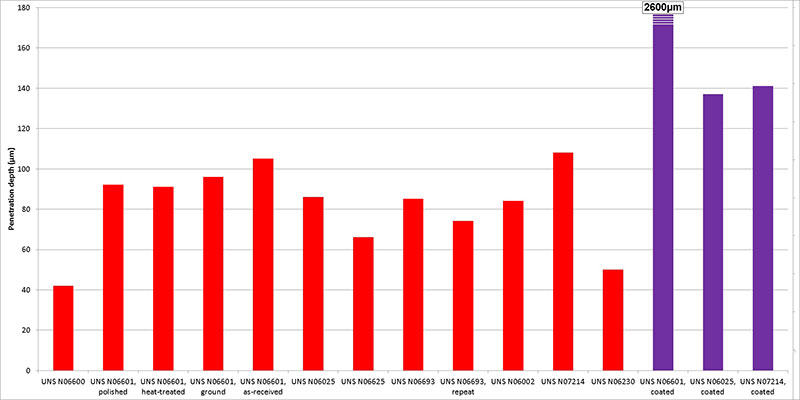

Difficulties were encountered in accurately measuring penetration depth perpendicular to the surface, as the original substrate surface could not be clearly discerned. Where this was the case, measurements were taken from the visible remaining surface. All alloys and penetration depths are summarised in Figure 5.
Figure 5 Maximum penetration depths for all alloys tested for 336h at 1100°C in flowing 90%CO-2.5%H2-Ar while under TiO2 powder. Some depths are above the scale of this graph, these are noted.
Based on the above, UNS N07214 was deemed unsuitable for this service. UNS N06230 experienced low penetration with little intergranular attack, though a Cr-depleted layer formed below the scale surface. UNS N06625 had moderately promising performance; low penetration combined with void formation and no intergranular attack. The surface did not display a significant melted/corroded appearance. This may be due to the presence of niobium which acts as a carbide stabiliser and may lead to preferential formation of niobium carbides over chromium carbides. These two materials appeared to be the most promising. UNS N06600 did have the lowest penetration into the substrate; voids and carbides had formed below the substrate surface but the original surface could not be definitely discerned and so was regarded as promising but with caution. Other alloys displayed intermediate performance, with higher levels of molybdenum and/or chromium generally leading to increased resistance, but this was qualitative only.

In 90%CO-2.5%H2-Ar at 1100°C with TiO2 powder present (a suitable simulant for the proprietary industrial cell), attack was attributed to a complex mixture of oxidation and carburisation resulting in formation of chromium oxides, aluminium oxides and multiple carbides. Attack was either general/uniform (with void formation) corrosion or intergranular corrosion with associated precipitation along grain boundaries, depending on alloy composition.
No quantitative correlation between alloy composition and resistance to attack was observed, but qualitative trends were present. UNS N06230 and UNS N06625 showed reasonable resistance to this environment with UNS N06600 showing good, but slightly lesser performance. UNS N07214 showed the poorest performance. Beta-aluminide coatings were partially protective, but any local failure led to extremely heavy localised attack. Material lifetime could potentially be improved by preventing the metal oxide powder from directly contacting the substrate by means of a coating or tiling.
