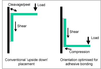

Adhesives are stress sensitive and despite the superior fatigue properties that they can offer a structure, the type and direction of loading can have a drastic impact on performance. As a rule of thumb adhesively bonded joints should be designed to maximise compression and shear and minimise/eliminate peel and cleavage. It has been shown that the load carrying ratio of compression:shear:peel can be approximated to 100:100:1.
A simple example of this is shown in Fig.1 where an 'L' bracket is attached in a vertical position. If attached in the conventional 'upside down' position and the bracket loaded in a vertical manner as indicated, then the forces acting on the joint will be focussed at the upper area in the form of cleavage/peel and some shear down the joint length. This will reduce the load carrying performance of the structure substantially. By simply reversing the orientation of the bracket the moment of the carrying arm causes the forces to be directed in compression to the base of the joint and as shear along the length of the joint. The bracket will be able to carry significantly more load as a result and all that was changed was the orientation.
Fig.1. Effect of bracket orientation on loading directions
