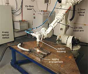

At the beginning of 2004, a 7kW Yb-fibre laser was installed at TWI Ltd, Fig.1. The YLR-7000 laser, manufactured by IPG Photonics GmbH, comprises a series of 200W single-mode fibre units, the outputs of which are combined, using proprietary IPG technology, into a 10m long, 200µm diameter, single optical fibre. The output laser power is transmitted into a four-way optical switch maximising the system's flexibility to process industrial components of different sizes and shapes. Twenty metre long, 300µm diameter,single optical fibres transmit the laser power from the optical switch to the laser process heads. Based on existing experience at TWI using up to 9kW of Nd:YAG laser power, by combining laser sources of very different beam qualities, the optical diameter of the laser process heads for the fibre laser, i.e. the beam diameter at the focussing lens, was set at 43mm, providing a fairly compact head, useful for instance when access is restricted. The beam quality of the laser beam through the four beam paths was measured to be between 17.7 and 18.7mm.mrad. With this beam quality, focussing lenses with a 250mm and a 160mm focal length were chosen (with a 120mm focal length collimating lens) to produce a calculated minimum spot diameter of 0.625mm and 0.4mm respectively, similar to those obtained with the 4kW lamp-pumped Nd:YAG laser also available at TWI. During testing, an average minimum spot diameter of 600µm and 390µmwas measured for the 250mm and the 160mm focussing lenses respectively. A Kawasaki ZX130L 6-axis articulated robot arm, equipped with Interbus-S to ensure high-speed communication between robot and laser, was used for beam manipulation.
Fig.1. The 7kW Yb-fibre laser welding trials set-up
