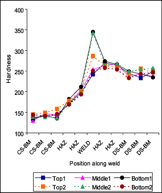

Hardness surveys:
The hardness variation in the optimised welds was determined at two weld cross sections and is shown in Figure 5. Traverses were carried out at three locations through the weld thickness. High hardness values (HV 351 and HV 333) were seen in the top of welds in the CS to AS combination. However, the hardness results were more scattered due to the large variation in the weld metal microstructure. Similar peak hardness results (HV 342 and HV 345) were observed in the sections from CS to DS combination. The hardness variation in the CS-DS welds was lesser due to a more uniform microstructure.

Fig.5. Hardness variation in the weld (taken at two sections) between:a) Carbon-Mn steel and austenitic stainless steel; b) Carbon-Mn steel and duplex stainless steel

  5. In the CS-AS weld combination, higher hardness values have been measured in the top of the weld, while a less diverse hardness distribution was obtained in the CS-DS combination.
