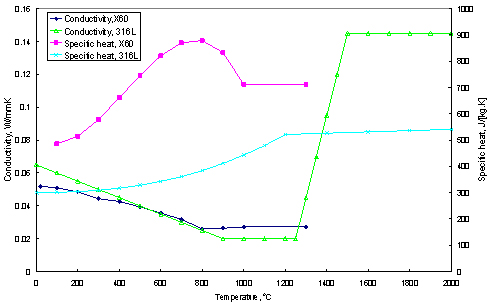

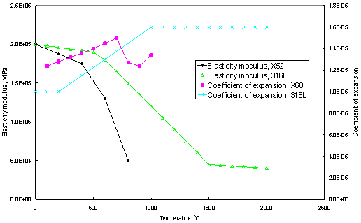

The thermal properties (conductivity, specific heat and coefficient of expansion) used in the analysis are shown in Figure 1. As no thermal properties were found for X52 steel, those for a similar steel (X60)[10] were used in the analysis.
(a) conductivity and specific heat;
(b) elasticity modulus and coefficient of expansion
Figure 1. Physical properties used in analysis: (a) conductivity and specific heat; (b) elasticity modulus and coefficient of expansion

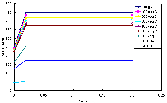

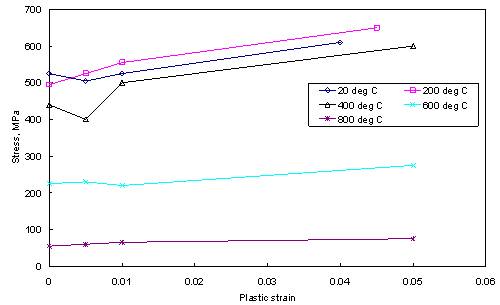

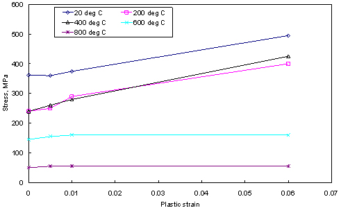

Strain hardening models
Various material hardening models including isotropic hardening, linear kinematic hardening, perfectly plastic deformation (ie no hardening) and annealing, were considered to demonstrate the effects of material hardening on welding residual stresses. Other more complex hardening rules such as the non-linear combined isotropic/kinematic hardening were not considered in this work as no sufficient experimental data were available to define those hardening models.
The elasticity modulus and stress-strain curves at various temperatures used in the analysis are shown in Figures 1-3. The properties for the parent metal (X52 steel) and the weld metal used in modeling the 19-pass welded pipe were measured, as reported in [9]. The properties of 316L stainless steel used for the 3-pass welded pipe were referred to an IIW round robin project. [3]
(a) parent metal X52 steel
(b) weld metal
(b) weld metal
Figure 2. Stress-strain data used in modeling the 19-pass welded pipe
Figure 3. Stress-strain data used in modeling the 3-pass welded pipe

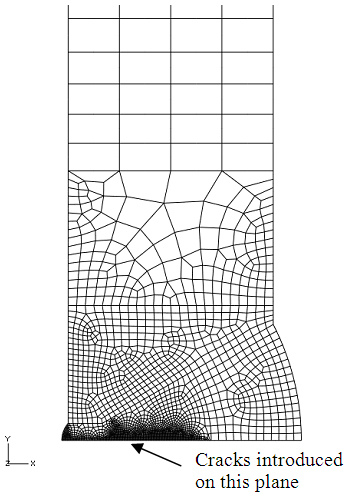

A fully circumferential internal crack was simulated using the 3-pass girth weld model (Figure 4). The cracks of various crack depths (2.5, 5.07 and 10mm) were postulated to be situated at the WCL (ie the symmetric plane). The cracks were introduced into the model with an initial welding residual stress field, followed by application of an axial load at the ends of the pipe. Two methods of introducing a crack were employed to illustrate the effects of introducing a crack numerically. One method was the introduction of a crack instantaneously, while the other introduced a crack progressively. In the case of instantaneous crack growth, all the crack flank restraints were made free simultaneously, while progressive crack growth allowed the crack flank restraints to be released in sequence from node to node in an FE model. Note, however, that for the cases of 5.07 and 10mm long cracks (Figure 12), only part of the crack face was released progressively to save simulation steps. This should not affect the results obtained as the progressive crack growth started sufficiently far from the crack tip.
Figure 4. FE mesh of the 3-pass welded pipe

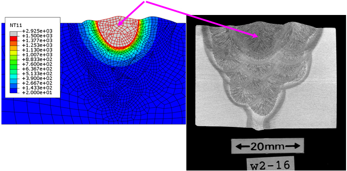

Validation of the thermal analysis was undertaken by comparing the simulated cross-sectional profile of each weld pass and the macro-section of each weld pass. It is found that the simulated weld cross-sections for each weld pass match the actual ones reasonably well. As an example, Figure 5 shows the comparison between the simulated last weld pass with the actual one.
Figure 5. Comparison of simulated last weld pass profile (ie pass 19) (left) with the macrograph (right)

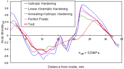

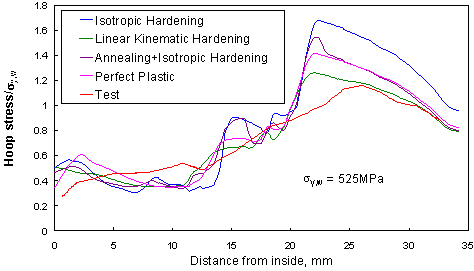

Validation of the mechanical analysis was made by comparing the through-wall distributions of axial and hoop residual stresses at the WCL predicted from various material hardening models with those from measurements using the BRSL technique, as shown in Figure 6. The BRSL method is classified as a destructive method and commonly used to measure the residual stress distributions through the thickness of a structure or component. Three steps are included in this method:
  • Block removal: removal of a block where the residual stresses are required;
  • Splitting: the block is split into two pieces at the mid-plane parallel to the inner and outer surfaces;
  • Layering: layers parallel to the splitting plane are removed from each of the block halves.
(a) axial stress
(a) axial stress
(b) hoop stress
(b) hoop stress
Figure 6. Comparison of the through-thickness distributions of residual stress at the WCL predicted from various FE material hardening models and measurements. (a) axial stress; (b) hoop stress
The BRSL technique has been demonstrated to produce the measurements with an overall accuracy within ±50MPa.[11] As illustrated in Figure 6, the predicted through-thickness distributions of residual stresses from various material hardening models demonstrate a similar trend to the one from the measurements, although there are some discrepancies in magnitude. The discrepancies were considered to be caused mainly by the limitations of all the material hardening models in describing the complicated mechanical behaviour present in the thermal cycles of multi-pass welding. Among the different hardening models, the linear kinematic hardening model predicted the lowest residual stress level, while the isotropic hardening model predicted the highest value. In this study, the variation of residual stresses in the pipe wall, as predicted from the linear kinematic hardening model, was in best agreement with those from the measurements. This may reflect on the fact that the linear hardening model was more representative of the mechanical behaviour in welding than other models considered in this work. As mentioned before, the non-linear combined isotropic/kinematic hardening model was not tested in this work due to the insufficiency of data in definition of such a complicated model. In theory, the combined hardening model should be the most favorable one in describing the thermal mechanical behaviour occurring in welding. However, this can be valid only on the premise of generating accurate parameters required to define a combined hardening model, which usually requires a substantial effort.
The outcome from the validation case demonstrates that an axi-symmetric model can be used to simulate the multiple weld passes for a pipe girth weld for determination of welding residual stresses. In practice, the use of axi-symmetric model may be the only practical option for a multiple-pass pipe girth weld as the effort in creating a 3D model, the computer run-time and memory requirements may be prohibitively huge.

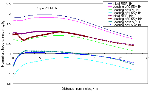

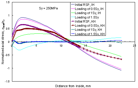

Static loading effects on 3 pass weld
Figure 7 shows the variation of residual stresses with thickness at the WCL due to the three static axial loads only. The three load levels were 0.5, 1 and 1.5 times the yield strength (250MPa) as applied to cases 1 to 6 of the Table. Figure 8 demonstrates the effect of internal pressure (12.5 and 25MPa) and the combination of internal pressure (25MPa) and axial loading (equal to the yield) for cases 7-9 in the Table. Internal pressures of 12.5 and 25MPa produced hoop stresses in the pipe of 125 and 250MPa respectively (ie 0.5 and 1 times the yield).
(a) axial residual stresses
Figure 7. Static loading effects on (a) axial residual stresses;
(b) on hoop stress
(b) on hoop stress
Figure 7. Static loading effects on (a) axial residual stresses; (b) on hoop stress

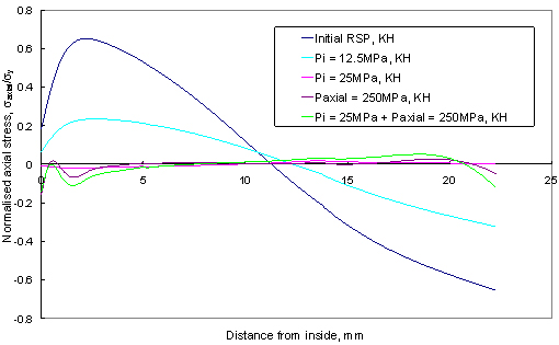

Figure 8. Static loading effects due to internal pressure and the combined internal pressure and axial loading
As shown in Figure 7, regardless of which strain hardening model (isotropic or kinematic) was used, small beneficial effects were gained when a static load was below 50% of the yield strength, whereas a substantial decrease in peak tensile stress was attained when the static load was above the yield strength.
From the isotropic hardening model, the peak tensile axial stress was decreased by about 75% (from 92 to 23% of the yield strength) after the application of an axial load equal to the yield strength. More profound reduction in the peak tensile stress (from 92 to -27% of the yield strength) was induced as a result of applying an axial load equal to 1.5 times the yield strength. From the kinematic hardening model, however, nearly the same level of decrease in the peak tensile stress (from 65% to minus 3% of the yield strength) was found for the cases with the axial load equal to the yield strength or 1.5 times the yield strength. Similarly, substantial reduction was also found in hoop stresses when the applied axial load was above the yield.
The results shown in Figure 8 demonstrates that an internal pressure of 12.5MPa caused a marked relaxation of the peak axial stress (from 65% to 23% of the yield strength), compared with a much smaller decrease due to an axial load equal to 50% the yield.
The different strain hardening models had a profound implication on the amount of relaxation in residual stress due to mechanical loading. In theory, the kinematic hardening model should be more representative of the material deformation behavior due to loading and unloading because it represents more accurately the BAUSCHINGER effect. However, further work with experimental validation is needed to demonstrate which strain hardening model is more appropriate.

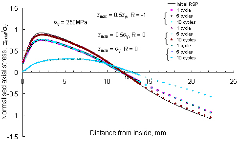

The through-wall axial stress distributions affected by various cyclic loadings as specified for cases 10-13 in the Table are shown in Figures 9-10. Figure 9 presents the results obtained for the three sets of cyclic loading for the IH model. Figure 10 compares the results from the IH and KH models.
Figure 9. Cyclic loading effects on axial residual stresses from the IH model.

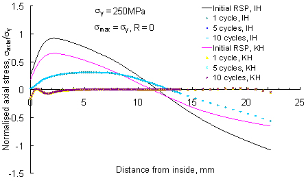

Figure 10. Comparison of cyclic effects from the IH and KH
For each level of the fatigue loading, the effect was seen immediately after the first cycle, and no marked difference in the effect on residual stresses was found between one, five and ten cycles. Because of this, the profiles affected by cyclic loading are similar to those affected by static loading discussed above. With their numerical investigation, Dattoma et al[4] also demonstrated a significant reduction in the initial residual stresses after the first load cycle, and subsequent cycles did not show any effect on the redistribution of welding residual stresses.
However, in contrast to the cases of static loading in which the effect was governed only by the magnitude of a static load, the effects on residual stresses due to a cyclic load were shown to be due to the combined action of the maximum load and the minimum reversed load leading to yielding in reversed compression. This was demonstrated from a more pronounced effect of stress relaxation from case 10 (Smin/Smax = -1 and Smax = 0.5 times the yield) than from case 11 (Smin/Smax = 0 and Smax = 0.5 times the yield).
Finally, it is worthwhile noting that the underlying mechanism for relaxation of residual stresses due to either static loading or cyclic loading is the occurrence of yielding of the materials under the combined action of residual stresses and the stresses due to external loading. Obviously, no relaxation of residual stresses would occur if no yielding was induced, as usually in cases of high cycle fatigue (ie low external stresses).

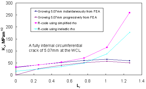

The effective driving force KJ in terms of the assessment procedure in R6[13] was also evaluated using the following equation.
(Eqn 4)
(Equation 4)
All the parameters in Equation (4) were calculated using R-code (an assessment program based on the R6 procedure). Two methods given in R-code, the simplified and the inelastic, were used to calculate the factor. The inelastic method is generally less conservative than the simplified method.

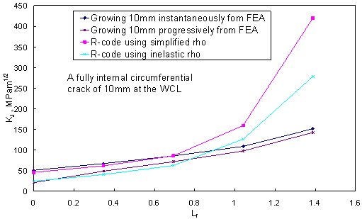

The effective driving forces KJ from FEA and R-code are presented in Figure 11 for the crack heights (5.07 and 10mm) in the girth weld. The average value of the J-integrals evaluated by FEA over the domain close to the crack tip was used to calculate the FEA KJ. The values of load ratio Lr were evaluated from the R-code program, rather than from FEA.
Firstly, a thorough examination of the FEA evaluations of J-integral was made with respect to the path-independence of J-integral in a welding residual stress field. When the J-integral domain included only the region close to the crack tip (approximately within one fifth of the crack size), it was found that the path-independence feature of a J-integral was largely maintained in the two crack heights (5.07 and 10mm) for the fully internal crack, regardless of which method of introducing a crack (instantaneously or progressively) was used. This path-independence was found to be improved as the primary load was increased. These observations were consistent with those by Bouchard et al[5] and Smith and Goldthorpe[6], although the whole welding residual stress and strain fields in this work were significantly more complex than the one investigated by Smith and Goldthorpe and Bouchard et al.
However, a strong path-dependence was found in the small crack height (2.5mm) for the fully internal circumferential crack, even with the increase in primary loading. This means that in this case, the J-integral is not a valid parameter for governing the crack-tip field of elastic-plastic deformation. A modified definition of the J-integral which accounts for the initial strain due to residual stress, ie JEDI[8] may be able to address the issue of path-dependence. However, it should be noted that the path dependence of J-integral in a welding residual stress field is due to the complex cycles of loading and unloading experienced in welding and the crack extension leading to additional unloading. In the case of deeper cracks (5.05 and 10mm in this work), path-independence was demonstrated to be largely retained. This was mainly because the near-crack tip stresses for a deeper crack can be intensified sufficiently for overcoming the effect of residual stresses in comparison with a shallower crack. To avoid the issue of path dependence, CTOD may be considered as an alternative parameter for use in a welding residual stress field. However, it should be aware of the constraint effect (ie specimen dependence) on fracture mechanics parameters including CTOD and J integral.
The effect of the method of introducing a crack is clearly shown in Figure 11, which show that a lower value of KJ was obtained from a progressively growing crack. This effect occurred because the progressively growing crack front left a plastic wake along its flanks than the instantaneously growing crack. The comparison of crack opening profiles from the two methods is presented in Figure 12, clearly demonstrating the formation of a larger plastic wake for a progressively growing crack. As a result of this, a reduced crack opening displacement was attained by progressively growing a crack, making the progressively growing crack in a residual stress field more benign. Similar results were made by Bouchard et al[5] who considered a repair weld in a pump casing, and by Charles et al [7] who considered a fully circumferential external crack in a pipe girth weld. However, it should be noted that the extent of reduction in KJ varied. This work and the work of Charles et al [7] showed smaller reductions in KJ than those of Bouchard et al.[5]
(a) for the 5.07mm long circumferential crack;
(b) for the 10mm long circumferential crack.
Figure 11. Comparison of the effective K factors due to the combination of RSPs and primary membrane loads from FEA and R-code. The RSP in this example was referred to Initial RSP, IH in Figure 7. (a) for the 5.07mm long circumferential crack; (b) for the 10mm long circumferential crack.

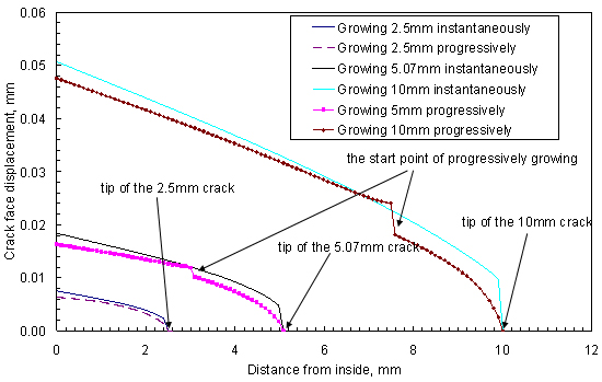

Figure 12 CMOD in a residual stress field.
Figure 12. CMOD in a residual stress field
A few interesting points can be further revealed by examining the results shown in Figure 11 for the fully internal circumferential crack with two heights of 5.07 and 10mm.
Firstly, the R-code evaluations of KJ were closer to the FE calculated KJ when the load ratio Lr was below about 0.7. After this value of Lr, the divergence in the KJ evaluated from the R-code methods and FEA tended to be substantial, with over-estimation of KJ from the R-code methods.
Secondly, while the simplified ρ method in R-code gave KJ values closer to the values from the FEA which simulated a instantaneously growing crack, the KJ values evaluated from the inelastic ρ method were more comparable with those from the FEA simulating a progressively growing crack.
Thirdly, when Lr was below about 0.7, the R-code evaluations could be non-conservative, particularly when the inelastic ρ method was adopted. Similar findings with respect to the non-conservatism of the R6 assessment procedure were also reported by Smith and Goldthorpe.[6] However, it should be pointed out that to reach a general statement with regard to the observed non-conservatism would require investigating a wider range of cases.
