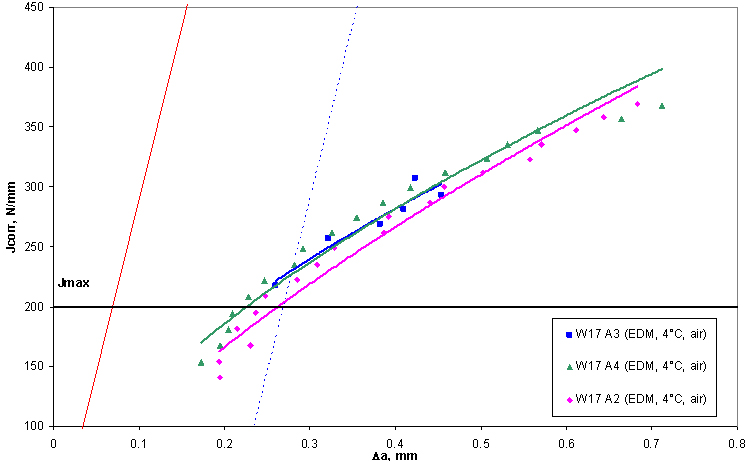

The results from the fracture mechanics tests conducted in air are presented in Figures 1 and 2 for EDM and fatigue pre-cracked notched specimens, respectively, in terms of J (corrected for crack growth in accordance with BS 7448 Part 4[3]) versus ductile crack extension or tearing (Δa). Only valid data points according to BS 7448-4 are shown in these figures.
Figure 1. Unloading compliance J R-curves obtained from specimens tested in air at 4°C from EDM notched specimens

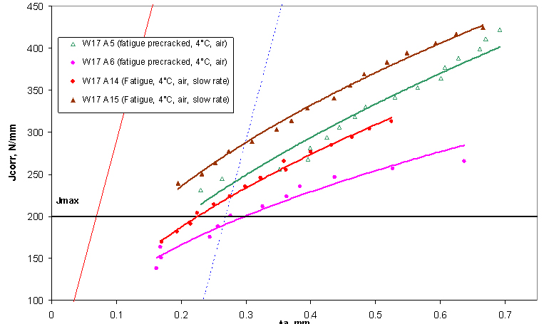

Figure 2. Unloading compliance J R-curves obtained from specimens tested in air at 4°C from fatigue pre-cracked notched specimens
A best fit curve was fitted using the following power law:
J=l (Δa)x
Where J is in N/mm and Δa in mm. Coefficients l and x, as well as values of J0.2BL for each fitting curve, are given in Table 1.

As shown in Figures 1 and 2, the majority of the valid data points for all of the tests lie above the maximum value for J (Jmax) as defined by BS 7448 Part 4.

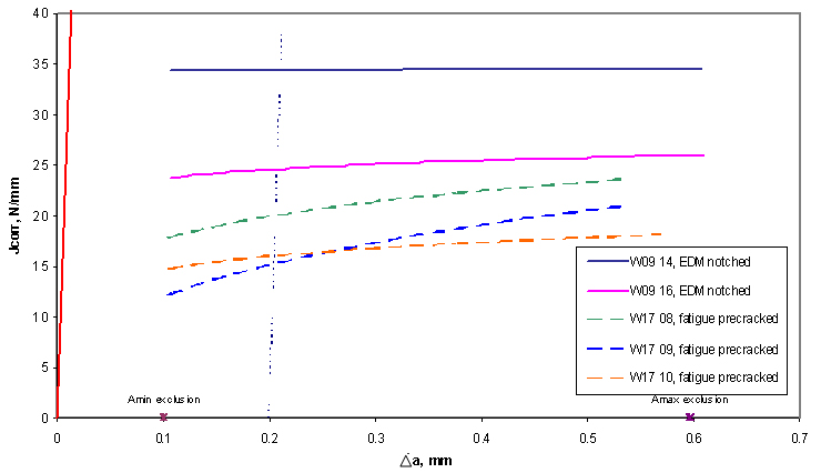

The results from the fracture mechanics tests conducted in 3.5% NaCl are presented in Figure 3. A best fit curve was fitted in each case. The coefficients l and x, along with values of J0.2BL are given in Table 1. This figure also includes J R-curves for EDM notched specimens tested previously by Beaugrand et al,[7] for comparison.
Figure 3. Unloading compliance J R-curves obtained from EDM and fatigue pre-cracked notched specimens tested in 3.5% NaCl with cathodic protection

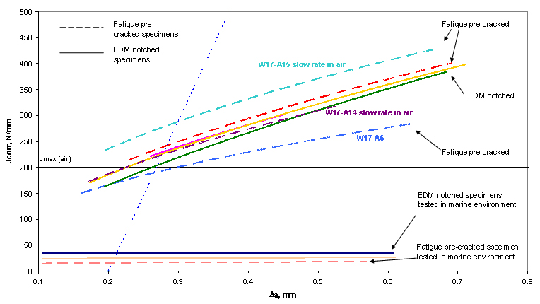

Figure 4 shows all of the J R-curves obtained. It shows that the lower bound J R-curve and the minimum value of J0.2BL in air, ie 189N/mm, were obtained from specimen W17-A6 (fatigue pre-cracked). The same figure also shows that the J R-curves obtained from specimens tested in 3.5% NaCl with cathodic protection were considerably lower than those obtained in air. The lower bound J R-curve for the specimens tested in 3.5% NaCl was obtained from the fatigue pre-cracked specimen W17-A10. The lowest J0.2BL was measured for specimen W17-A9 (also fatigue pre-cracked). Of the specimens tested in 3.5% NaCl all three fatigue pre-cracked specimens gave lower curves than the EDM notched specimens.
Figure 4. Comparison between unloading compliance J R-curves obtained from specimens tested in air at 4°C and in 3.5% NaCl with different notch configurations. J-R curves were obtained as power law fit of selected data points.

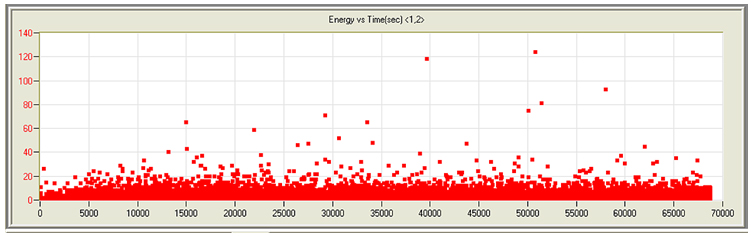

The results of the accelerated H cracking susceptibility tests under no applied external load are summarized in Table 2. Although significant indications of up to 120dB intensity were recorded by AE, the cross sections revealed that no cracking occurred during the tests. An example of the AE output of energy versus time, for the F6NM to 625 sample welded using a layered weld bead sequence and tested for 20 hours, is shown in Figure 5. A minor crack was observed at the F6NM/625 stacked interface after 164hrs exposure, but the location of the crack, away from the interface suggests that it was most likely not a result of reduced toughness by H saturation. The AE signals are thought to be due to the bursting of H bubbles at the sample surface.
Table 2. Accelerated H cracking susceptibility under no applied external stress test results
InterfacePotential (mV)Exposure (hrs)Result
F65/625 (No PWHT) -1100 20 No Cracks
F6NM/625 Stacked -800 20 No Cracks
-1100 164 Minor crack
F6NM/625 Layered -1100 20 No Cracks
Figure 5. Acoustic emission measurement for F6NM to 625 sample welded using a layered weld bead sequence and tested for 20 hours.

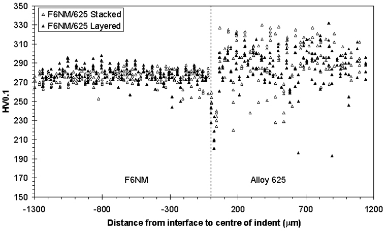

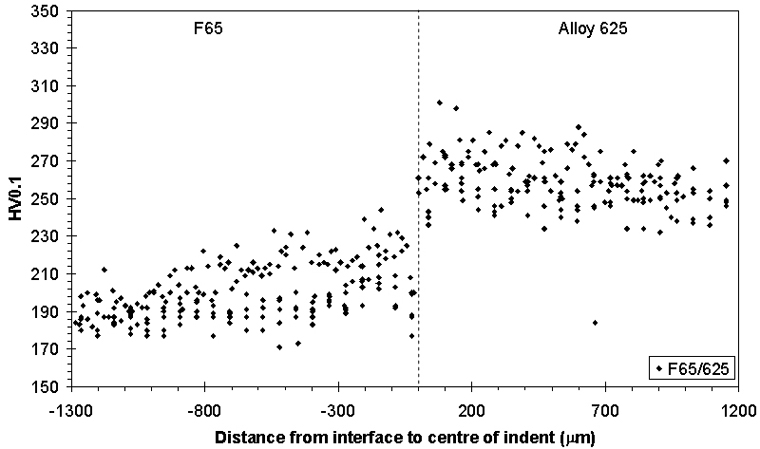

The microhardness measurement results for the F65/625 interface, and F6NM/625 interfaces, are presented in Figures 6 and 7, respectively. Interestingly, higher hardness was not measured on the F65 side of the interface, even though no PWHT was carried out for stress relieving. The F6NM and alloy 625 had similar hardness, with a drop in hardness on the 625 side, adjacent to the interface.
Figure 6. Micro-hardness array across F65 to alloy 625 dissimilar metal interface
 Figure 7. Micro-hardness arrays across F6NM to alloy 625 dissimilar metal interfaces. Results for both stacked and layered weld bead sequences

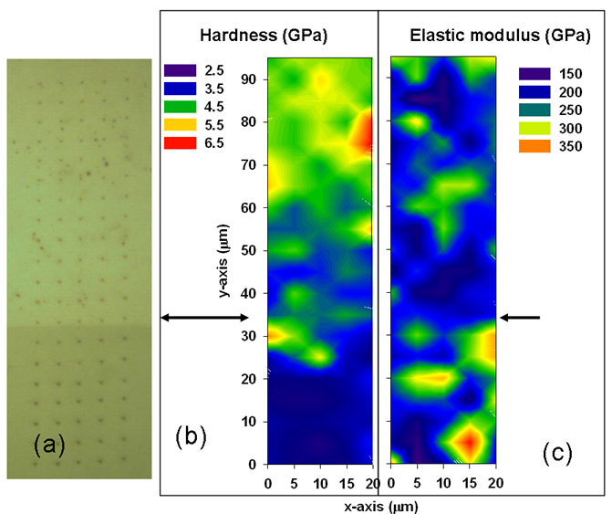

Figures 8(a)-(c) show nanoindentation arrays performed in the F65 interface and resultant 2D maps of the hardness and elastic modulus obtained by probing regions shown in Figure 8(a). Comparing Figure 8(b) and (c) with Figure 8(a) it is possible to understand that nanoindentation was able to define the mechanical properties gradients contained within the microstructure scale. The average values of the hardness and of the elastic modulus across the y axis is presented in Figures 9(a) and (b), respectively. From the nanohardness measurements, an increase in hardness was measured along the interface, especially towards the F65 side.
Figure 8. Nano-hardness array across F65/Alloy 625 dissimilar metal interface 8a) Micrograph of cross section and indentation locations; 8b) Nano-hardness. Location of interface is indicated; 8c) Elastic Modulus. Location of interface is indicated

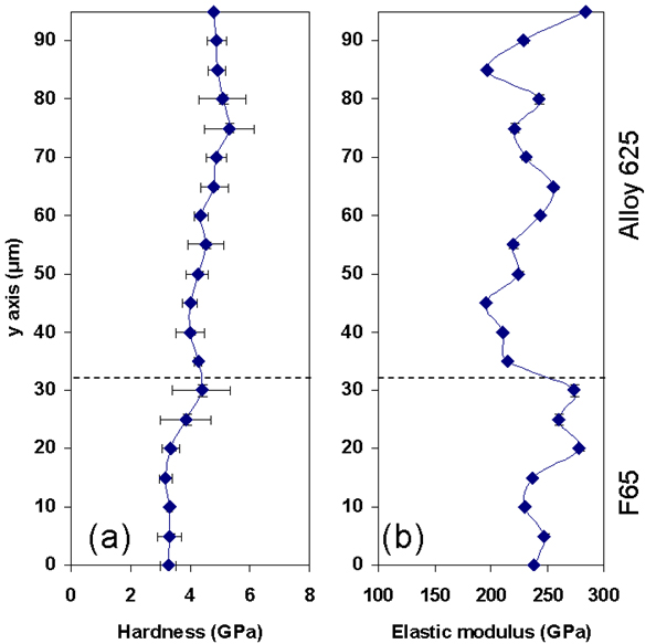

Figure 9. Average nano hardness and elastic modulus with measurement deviation, in a and b, respectively

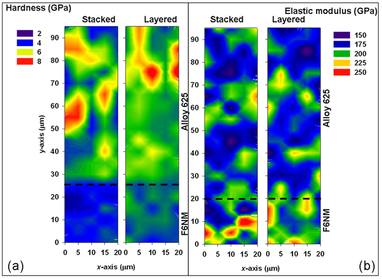

Figures 10(a) and (b) show nanoindentation hardness and modulus maps of the F6Nm to alloy 625 interface with a stacked weld bead sequence and layered weld bead sequence, respectively. Higher hardness was measured on the alloy 625 side, with lower hardness on the F6NM, showing the efficiency of the PWHT. The nano-hardness measurements confirm the micro-hardness data, showing a slight decrease in hardness immediately adjacent to the interface, towards the 625 side. However, it must be pointed out that the indentation spacing of 5mm would not be capable of revealing features smaller than this.
Figure 10. F6NM to alloy 625 interface nano-indentation result maps. 5µm indent spacing 10a) Hardness 10b) Elastic modulus
