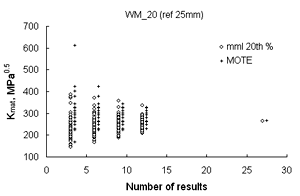

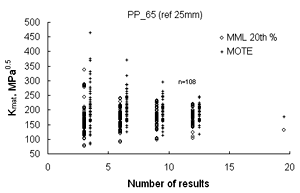

The results from these calculations are presented in Fig.4 to 6. Also included are the 20th percentile Kmat predictions made from the complete data set. For the BS procedure, various statistical distributions were fitted to the censored experimental data using a maximum likelihood method. Results from specimens that did not fracture were censored. However, censoring does not mean the result was ignored. In all cases the log e-normal distribution was found to provide the best fit, and the fitted parameters together with the 20th percentile and mean minus one standard deviation values are given in Table 2.

Fig.4 MML and MOTE procedures compared for 100 simulations for each sub-set up to 12 results, above 12, 20th percentile values from distribution are shown for weld metal at -20°C.

Fig.6 MML and MOTE procedures compared for 100 simulations for each sub-set up to 12 results, above 12, 20 th percentile values from distribution are shown. Results are for parent plate at -65°C.
Figures 4-6 clearly show that the mml procedure reduces the risk of overestimating fracture toughness compared with the MOTE procedure, especially for small data sets, e.g. 9 or less. When the data set comprise only 3 results, both procedures show that a very wide range of fracture toughness estimates is possible. Actual toughness can be significantly overestimated or underestimated, although large overestimates are less likely with the mml procedure. As expected, when the number of results in a data set increases, scatter decreases. The mean values of fracture toughness tend to be lower with the mml procedure compared with the MOTE procedure, but the lower bound values are similar for both procedures.
When the results from the whole data set are compared (for the present purposes, this represents the whole population), the 20th percentile predictions from both procedures are similar, despite the fact that the mml procedure is based on a 3 parameter Weibull distribution with a shape parameter of 4, and the BS procedure is based on a 'best-fit' log e-normal distribution.
An apparent exception is indicated by the result from the parent plate where the 20th percentile Kmat from the mml procedure is 25% lower than the Kmat from the BS procedure. In this case, the mml prediction is based on STEP 3, and the lowest result from 108 tests; this result is likely to be an outlier. Figure 3 shows that a better fit to the experimental is obtained from STEP 2. STEP 2 provides a 20th percentile Kmat of 194MPam 0.5, which is close to but 11% higher than the BS procedure. This is consistent with the SINTAP procedure which recommends halting the analysis at STEP 2 when more than 9 results are available.
Nevertheless, Fig.4-6 show the particular strength of the mml procedure when dealing with small data sets, in that, in comparison with the MOTE procedure, it minimises the likelihood of overestimating fracture toughness. Furthermore, the results do illustrate the potential problems of relying on the results from data sets as small as three. For safety critical components reliance on three test results is unacceptable, unless high safety factors are included in other input parameters to the flaw assessment.
