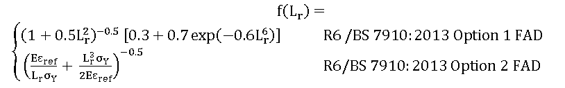

With Lr defined according to Equation (1), if Pref is used to construct a BS 7910:2013 Option 3 failure assessment diagram, then it will intersect the corresponding BS 7910:2013 Option 2 FAD at Lr = 1. This means that at Lr = 1, both the Option 3 and Option 2 FADs give the same Kr value. In this case, the limit load is allowed to depend on the strain-hardening characteristics of the material, not just the yield or flow strength.

f1 (Lr=1)=0.673 [7]
f2 (Lr=1)=0.816 [8]
is obtained.
Note that two different stress-strain curves were employed for the Option 2 FAL: the bilinear stress-strain curve and a Ramberg-Osgood fit (as described in BS 7910:2013 Clause 7.1.3.5) through the yield and ultimate tensile strengths used to define the bilinear curve. However, for this case, the choice of stress-strain curve (discontinuous vs continuous yielding) does not affect the value of the failure assessment line at Lr= 1.
According to the J-based limit load method, in order to determine the reference stress, the global bending stress for which √(Je/J) equals either value in Equation [7] needs to be solved for. This is illustrated graphically in Figure 6.
Therefore, the reference stress is 403MPa for the Option 1 assessment and 365MPa for the Option 2 assessment. The corresponding load ratios, Lr, can be evaluated by dividing the reference stress by the yield stress, giving Lr = 1.71 for the Option 1 assessment and Lr = 1.88 for the Option 2 assessment.
