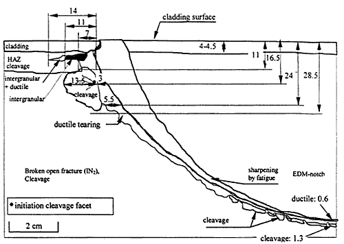

In the NESC-1 Spinning Cylinder test, [1] a large surface-breaking flaw in a thick steel cylinder component was subjected to high primary and secondary stresses, produced by combined rotation and thermal shock loading. After the test, destructive examination of the cylinder showed that the flaw (hereafter referred to as flaw R) had grown initially by ductile tearing before extending by cleavage at one end. Cleavage crack propagation stopped after 13.5mm of sideways extension and the lobe-shaped cleavage region was contained within 30mm of the inside surface (see Fig.1).
Fig.1. Fracture morphology observations of Defect R
The arrest of a significant pre-existing flaw after a relatively small amount of ductile tearing and cleavage crack extension in a large-scale component test has potentially beneficial implications for safety cases of nuclear reactor plant under comparable conditions. It is important, therefore, that the reasons for crack arrest in this case are fully understood, so that the general theory can be applied with more confidence elsewhere.

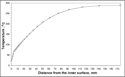

The transient temperature distribution through the cylinder wall was determined from a simple 2D finite element model. The cylinder internal heat transfer was modelled by conduction. The heat flow from the inner surface of the cylinder to the quench water was quantified by the following equation:
q = HA(T - T 0 )
where A is the area (m 2 ), T is the temperature of the cylinder inner surface, T 0 is the water temperature = 5°C, and H is the heat transfer coefficient [10,000W/(°C-m 2 )].
The predicted temperature distribution through the cylinder wall at the assumed time of crack initiation is shown in Fig.4. Measurements during the test showed that temperature also varied slightly along the cylinder length and the circumference, but these variations were not considered significant to influence the thermal stress or crack front temperatures. This through-wall temperature distribution was therefore applied throughout the 3D finite element model.
Fig.4. Temperature distribution through cylinder wall at 217s after the quench
In the finite element calculations, an initial temperature of 290°C was assumed. As a result, ABAQUS assumes that the finite element model is stress free at 290°C. In reality, there will be stresses in the cylinder at any uniform temperature because of the difference in thermal expansion coefficients between the stainless steel and the ferritic steel. However, because the cladding is only 4mm in a thick section of 175mm, neglecting those stresses is considered acceptable.

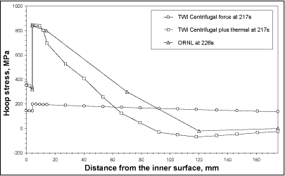

Stress results

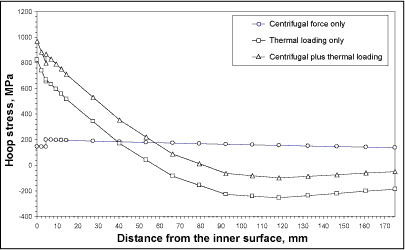

Figure 5 shows the various hoop stress components through the cylinder wall in a part remote from the defect (479mm from crack position), 217s after the water quench, as computed from an elastic analysis. The hoop stress due to centrifugal forces at the angular speed of 2247rpm is about 200MPa in the base material. The thermal stress is in self-equilibrium and varies from just over 800MPa at the inner surface to just under -200MPa at 90mm from inner surface, and then increases slightly towards the outer surface.
Fig.5. Elastic hoop stresses at 217s after the quench (remote from the crack)
Figure 6 shows the results from an elastic-plastic analysis mainly for the purpose of comparisons with the elastic results and the results in Ref. [7] . Compared with the elastic analysis results, plastic yielding reduces the magnitudes of hoop stresses in the cladding, HAZ and near-surface base material. The effect of the different yield and work hardening properties of the three materials can be clearly seen in the near surface regions, but throughout the remaining part of the cylinder, the hoop stresses are similar to those from the elastic analyses. The hoop stress results obtained by ORNL in Ref. [7] are also included in Fig.6 for comparison. Both the TWI and ORNL results follow the same trends, especially at the inner surface. ORNL predicted stresses higher than those of the present work at distances greater than about 15mm from inner surface, and this is likely to be due to differences in finite element mesh refinement.
Fig.6. Comparison of present and ORNL results of elastic-plastic hoop stress

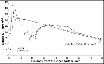

Elastic stress intensity factors under constant load
Elastic fracture mechanics analyses were carried out to obtain J-integral values at discrete points along the crack front using the contour integral calculation scheme in ABAQUS. [12] Stress intensity factors, K, were calculated from J using the following equation (assuming plane strain conditions):
Where E is 206GPa and ν is 0.28.

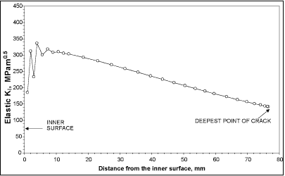

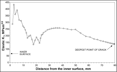

Initial flaw
Figure 7 shows elastic stress intensity factors along the front of flaw R as a function of the distance normal to the inner surface of the cylinder. The stress intensity factors (K I) obtained from the finite element analyses are shown as discrete points (open symbols). Each point in the figure represents a point along the crack front and its associated K I value. The point right on the inner surface has not been included because of numerical instability. At the deepest point of the defect, 76.5mm from the surface, the value of K I is 140MPa √m. The K I value at 10mm from inner surface is about 300MPa √m, more than twice that at the deepest point, because the water quench generates very high thermal stresses near the inner surface (as shown in Fig.5 and Fig.6). Between these two positions, K I decreases almost linearly from 300 to 140MPa √m.
Fig.7. Static elastic stress intensity factors for the initial crack at 217s after the water quench
A curve is drawn through all the discrete points representing K I values in Fig.7 to indicate trends of the stress intensity factors. The KI values computed by the FE analysis seem to drop as the inner surface is approached, but it is not certain how K I values actually vary within a small distance of about 2mm at the inner surface because no reliable K I values have been obtained there in the present work. There are oscillations of K I values in a band of about 8mm near the inner surface. Similar oscillations were also found in the ONRL analyses [13] and are likely to be a computational effect due to influences of free surface and of material in-homogeneity, and, to a less extent, FE mesh design on calculated stresses and strains. The oscillations of the stress intensity factor do not, however, occur in the region of actual interest, which is the band of base material at a distance of 10 to 30mm from the inner surface. Checks undertaken using analytical K I solutions show that the FE model gives accurate results at the deepest point for the stresses produced by centrifugal loading.

It was not the intention of this work to explain the shape of the arrested crack. For this it would have been necessary to undertake an incremental viscoplastic dynamic analysis of the propagating crack and changing stress field, computing the stress intensity factor at each increment. An example of this complex type of analysis is given in Ref. [4] . Instead, the present analysis has been made using the shape of the arrested crack (slightly idealised), where the objective is to show that the use of compact crack arrest toughness data with statically determined elastic crack driving force is a sufficient condition for crack arrest.

The elastic K I values for the initial and arrested crack are compared in Fig.9. It is evident that the K I values are significantly reduced in the region of the arrested cleavage growth, 11 to 28.5mm from inner surface (see Fig.1), where the K I values are about 50%-60% of those of the initial crack. Post-test destructive examination showed that a lobe-shaped crack developed from the cleavage fracture initiation site, about 16.5mm from inner surface (see Fig.1). The crack grew away from the initial semi-elliptical defect boundary predominantly in the direction of the cylinder axis. Since the applied stresses hardly vary in the axial direction, it is the change in the crack front shape that has caused the reduction in K I values, leading to arrest.
Fig.9. Comparison of static elastic stress intensity factors obtained under constant load for the initial and arrested crack

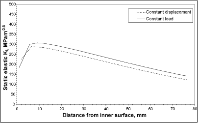

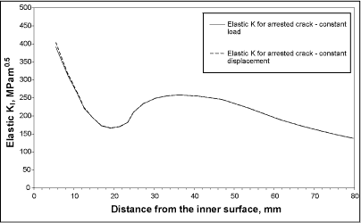

Elastic stress intensity factors under constant displacement
The constant displacement analyses described next were intended to check the significance of dynamic effects on crack driving forces.
Figure 10 includes both results of applied K I values obtained under constant load and constant displacement boundary conditions for the arrested crack. For the sake of clarity, the curves in Fig.10 have been drawn through K I values obtained from the mid-nodes of the crack front elements, where the crack front curvatures are continuous locally. It can be seen from Fig.10 that the two sets of results are almost identical. Figure 10 implies that dynamic effects on K I values of the run-and-arrest event of flaw R are negligible in the NESC-1 test. This is because the cylinder is stiff and its stiffness is hardly changed by the small amounts of crack extension. The newly created crack surface area is, in fact, merely 0.2 to 0.3 % of the un-cracked area.
Fig.10. Comparison of static elastic stress intensity factors obtained under constant load or constant displacement boundary conditions for the arrested crack
If crack extension is large, dynamic effects on K I values are more important. This is illustrated by carrying out a constant displacement analysis on a crack of the same size as the initial flaw R which was assumed to have developed from an un-cracked cylinder of exact dimensions as the NESC-1 spinning cylinder. Applied loads were the same as those in the NESC-1 test and appropriate displacement boundary conditions were imposed on cylinder outer surface in the constant displacement analysis.
Figure 11 shows K I results under constant load and constant displacement for this hypothetical crack. As pointed out before, for the sake of clarity, the curves in Fig.11 have been drawn through K I values obtained from the mid-nodes of the crack front elements. KI values under constant displacement are 10% lower than K I values under constant load at 20mm from inner surface and 20% lower at 76.5mm (the deepest point). The cracked area in this hypothetical case is about 6% of the un-cracked area, which seems to be big enough to cause dynamic effects.
Fig.11. Comparison of static elastic stress intensity factors obtained under constant load or constant displacement boundary conditions for a hypothetical large crack

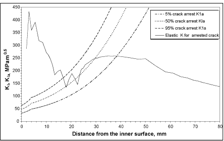

3. Comparison of stress intensity factors with crack arrest toughness
Previous review work [3,15] has led to the conclusion that in terms of fracture mechanics, sustained crack arrest will take place if the applied crack driving force falls below the crack arrest toughness and if the dynamic crack driving force peak shortly after arrest does not exceed the dynamic initiation toughness. It was also concluded that standardised Compact Crack Arrest (CCA) tests give conservative estimates for both crack arrest and dynamic initiation toughness. These principles of crack arrest assessment are now applied to flaw R. As dynamic effects have been shown to be negligible in this case, the crack driving force shortly after arrest is not considered further.
Figure 12 shows a comparison of the computed elastic stress intensity factors K I and the measured crack arrest fracture toughness (K Ia ) of the base material. Clearly, the relevant K I values fall inside the range of measured crack arrest toughness. Fig.12 therefore explains crack arrest, as observed experimentally. It can be speculated with some confidence that if further crack driving force calculations were carried out modelling larger (along the axial crack propagation direction) arrested crack dimensions, even lower elastic K I value would be obtained. If a series of such calculations were carried out, the crack dimensions where the measured arrest toughness first exceeds the applied K I value would then predict the arrested crack shape and size. Given the current coincidence of elastic crack driving force and arrest toughness, the predicted arrested crack shape thus obtained would be very similar to the actual arrested crack shape.
Fig.12. Comparison of computed applied static elastic stress intensity factors K I for the arrested crack and the measured crack arrest toughness K Ia of the base material
In the present study, evaluation of the experimentally observed crack arrest behaviour of the large NESC-1 spinning cylinder (1296mm length x 1045mm inner diameter x 175mm thickness) uses crack arrest toughness data obtained from small scale CCA specimens of 152x150x25mm. The current analysis of the NESC-1 test results shows that the small-scale CCA crack arrest tests are able to explain the crack arrest behaviour of the large cylinder. Good correlation of crack arrest between small-scale CCA specimens and large-scale structural components has also been demonstrated in the past (a review of recent work is given in Ref. [16] ).
Whereas the stress intensity factor for the arrested crack shape reduces from that of the initial defect between 10mm and 30mm from the inner surface, Fig.9 shows that below 10mm the SIF for the arrested crack exceeds that for the initial defect and rises towards the surface, before it finally reduces. With an apparently rising stress intensity factor, it may be asked why the arrested crack did not re-initiate and propagate in this region.
Firstly, it must be pointed out that the total stress consists of a relative low primary stress ( <50% of yield strength) due to spinning and a high secondary self-balancing thermal stress. The thermal stress will be relaxed to some extent in elastic-plastic materials due to the presence of the crack and plastic yielding. The stress intensity factors for both initial and arrested defects were derived from elastic finite element stress analyses. Figs.5 and 6 show the elastic stresses and the effect on the stress distribution of plasticity. In Fig.6, the stainless steel cladding has yielded and the stresses in the ferritic cylinder are reduced, although still shown in excess of uni-axial yield due to hydrostatic constraint. Tunnelling of the arrested crack under the surface produces very high elastic stresses in the ligament of material between the crack and the surface that would have yielded and redistributed. Between 0 and 10mm the elastic stress intensity factor for the arrested crack shown in Fig.8 is therefore considered to be an over-estimate of the SIF in the true elastic plastic stress field.
There are other reasons apart from a possible over-estimation of the stress why the crack did not propagate in the 10mm near surface region. This region consists of approximately 4mm of stainless steel cladding and 6.5mm of heat affected zone ferritic material from the deposition of the cladding. The toughness of these materials are both higher than that of the parent ferritic. In addition, tests on deeply and shallow cracked specimens showed a significant increase in toughness for shallow cracks with less constraint. Thus, propagation would not be expected in the cladding or HAZ until high values of stress intensity factor were reached.
If one looks at Fig.1, a small cleavage facet in the HAZ is evident. This detail was too small to be modelled in the finite element analysis but would not be expected to influence the stress and stress intensity factor around the main part of the arrested crack. The small facet may, however, be a result of re-initiation within the HAZ after arrest. As it has not propagated significantly, it may be concluded that the observation is consistent with it being an effect controlled by variations in the local microstructure.
