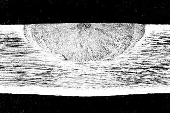

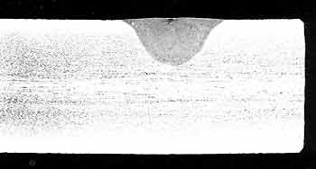

The welds with argon shielding gas were made with a fixed stand-off distance of 0.8mm from the tip of the tungsten to the workpiece. The first published reference which discusses the phenomenon of increased penetration of these fluxes in some detail identifies an increase in arc voltage associated with the fluxes and also a reduction in the welding current 2. The initial TIG trials carried out at TWI also show an increase in the arc voltage of typically 0.5 V but not a reduction in the welding current.
It can be clearly seen from Fig.3 that the A-TIG flux causes increased penetration and a reduced width of bead. For these TIG welds, the weld cross sectional area is also increased by 30 to 80%. Although some of this can be attributed to the increase in voltage and change in cooling rate due to the surrounding material, it is also possible that the flux has increased the efficiency factor of the process, i.e. more of the arc energy is transmitted as heat input to the parent material.
a) without A-TIG flux at 187A, 9.5V, 100mm/min and 1.07 kJ/mm arc energy (AH1898)
b) with A-TIG flux 187A, 10V, 100 mm/min and 1.12 kJ/mm arc energy. 6mm thickness stainless steel (AH1899)
Fig.3. Macrosections of TIG welds made with argon shielding
