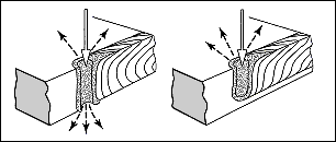

In EB welding technology, we clearly understand that there is typically a 'keyhole' that is traversed through the workpiece ( Figure 2). It is this keyhole effect that gives both EBW and LBW (Laser Beam Welding) the ability to make deep, narrow welds, with all the advantages that this can bring.
Any experienced power beam welding engineer will be familiar with the peculiarities that arise at the start and the finish of such welds; at the start, there is usually a 'bump' of displaced material, and at the end, there may be a slight depression, or even a significant cavity. Normally we look at these features as imperfections or even 'problems' to be solved.
Fig.2. Typical power beam welding keyhole mechanism
However, it is also clear that the keyhole action has in fact moved material in the reverse of the welding direction, albeit not very efficiently. Many years ago, we were discussing this 'problem' phenomenon yet again at TWI, but this time we asked ourselves some questions: What if we set out to enhance this effect? What if we repeated this type of action, in order to enhance this effect?

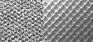

The EBT process ( Figure 3) can operate at extremely high speed, and allows the generation of a range of surface textures. Typically these textures have ~1:1 aspect ratio, and may include overhangs to give 're-entrant' features suitable for bonding. All this may be implemented with just a single beam, to give (typically) 500 to 2000 features per second. In some cases even higher speeds are possible.
Fig.3. EBT examples, with unsynchronised (L) and synchronised (R) deflection strategies
The EBT process is now being industrially applied, with several suitably retro-fitted EB machines as well as dedicated new builds equipped for the task. This transition from 'laboratory' to 'production' necessitated the development of improved equipment, both in beam generation and control.
With the first EBT equipment, we could not normally achieve a well-controlled process that incorporated repeated beam visits to a single location on the work. However, the development of more sophisticated controls suited to industrial EBT helped in the development of more sophisticated processing strategies, eventually leading to the development of the Surfi-Sculpt process.

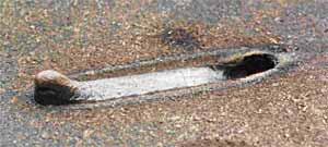

The first such Surfi-Sculpt protrusions were of low aspect ratio, as were the accompanying holes. Even so, they comfortably exceeded what was possible using EBT, and thus encouraged further work. Soon we were making protrusions and holes of dizzying aspect ratio, up to 30:1 in some cases ( Figure 5).
Fig.5. High aspect ratio features; from the bottom of the hole to the top of the protrusion is almost 6mm

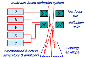

Accordingly a system comprising five programmable arbitrary function generators (AFGs), amplifiers, and coils was constructed. This system was programmable via a standard PC, for flexibility, but once the system was initialised, the PC would be out of the control path. This was to allow reliable operation ( Figure 6).
Fig.6. Beam deflection system (schematic)
The chosen AFGs allowed up to 16000 coordinates each on 'primary' (X/Y) 'secondary' (U/V) and 'Z' axes, the latter being a 'fast focus' control. By employing both X/Y and U/V sets, a total of 256 x 106 co-ordinates are possible, each in theory with a further 16000 focus possibilities via the 'Z' axis.
Pattern programming is achieved via specially written software, containing suitable functionality for programming of EBT and Surfi-Sculpt patterns.
This system has since been further improved in series manufacture under license, with increased numbers of programmed co-ordinates available, as well as a CNC control interface for automated production work.

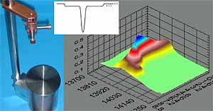

Fig.7. (L to R) Probe unit with low-power heat sink, typical single slit probe signal, typical 'through focus' composite probe data
TWI's probe system ( Figure 7) is therefore normally configured as a slit system, although configuration as a pinhole device is also possible. The in-chamber hardware comprises a simple probe head that can be configured for a variety of tasks. In the event of a beam strike, the probe head can be replaced very quickly. Repair to the damaged head is carried out off-line, and typically requires a minimum of new components.
The probe system can be fitted to most EB machines. Where a suitable beam deflection system exists, this may be used to throw the beam over the probe device. Where coils exist, but a suitable amplifier does not, a so-called' universal deflection amplifier' may be used for probing. The system will cope with coils that vary in sensitivity, inductance, and resistance over a very wide range (x10 2 for most parameters). After probing, the coils then resume their normal duties.
Slit data sufficient to characterize the beam quality for a typical welding process can be acquired in just a few seconds. One of the possible calibration problems with this type of system concerns the speed of the beam over the slit; without this information, measurement of beam diameter is not possible. The TWI probe system employs a novel strategy to generate a suitable 'calibration signal' within the data signal itself, without adding appreciably to the complexity of the probe system.

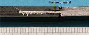

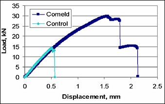

  • Composite to metal bonding, Comeld TM .

Fig.17. Tensile test data: Comeld joint (Stainless Steel 316L/glass-reinforced polyester) compared with control

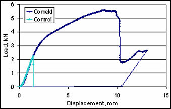

Fig.18. Comeld joint bend test data vs. control. GFRP/Stainless steel

Fig.20. Failed CFRP/Ti test joint, as per data in Figure 19. This joint design failed in the metal

Fig.23. Reverse face of Ti material, perforated using Surfi-Sculpt . Note absence of burrs

Fig.24. Multi-gun column process schematic, linear array
