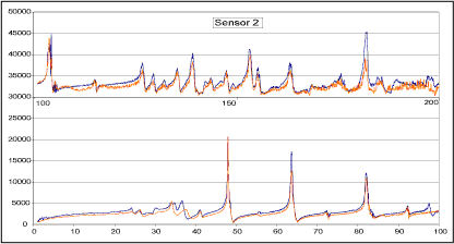

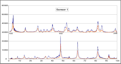

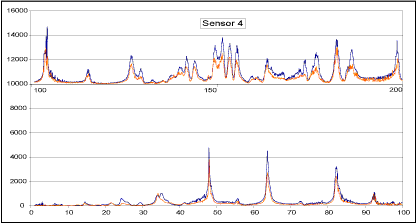

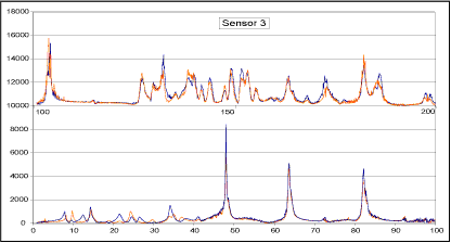

Experiment 1 and experiment 5 were repeat scans of the tank wall with no modification. Examples of the FRFs for each experiment are overlaid in Figure 3(a) (sensor 1), Figure 4(a) (sensor 2), Figure 5(a) (sensor 3) and Figure 6(a) (sensor 4). Note that in this figure the 100Hz to 200Hz range is stacked above the 1Hz to 100Hz range with an arbitrary offset. Note also that the repeat scans were taken two weeks apart. Between the first and second experiment, the actuator cable was disassembled and then reassembled and re-tensioned. The scans indicated good qualitative agreement between repeat experiments. There did not appear to be any difference in the repeatability between the upper and lower frequency ranges. The closest agreement appears to be in the frequencies of the modal peaks. The amplitudes of the peaks are noticeably more variable, although not excessively so. However it is worth pointing out an exception to this. A small peak appears at 97Hz in the FRF of sensor 2 for one experiment but not the other. Nevertheless, these results have demonstrated the concept that piezoelectric transducers could be used to excite and detect the lower order modes of vibration in a large industrial structure such as an AST.
3a) Repeat scans on unmodified tank (measurements taken 15 days apart)

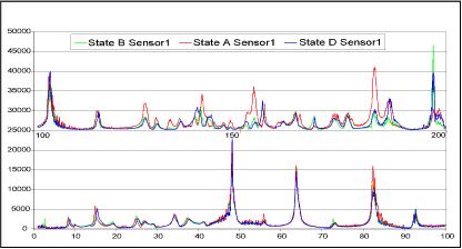

3b) Scans on tank modified with 1kg attached mass at A, B and D
Fig.3. Tank wall FRFs at Sensor 1 for stepped frequency scan (0.1Hz step)
4a) Repeat scans on unmodified tank (measurements taken 15 days apart)

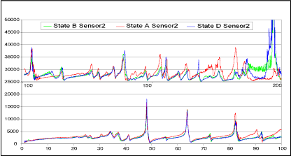

4b) Scans on tank modified with 1kg attached mass at A, B and D
Fig.4. Tank wall FRFs at Sensor 2 for stepped frequency scan (0.1Hz step)
5a) Repeat scans on unmodified tank (measurements taken 15 days apart)

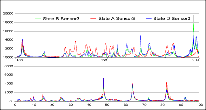

5b) Scans on tank modified with 1kg attached mass at A, B and D
Fig.5. Tank wall FRFs at Sensor 3 for stepped frequency scan (0.1Hz step)
6a) Repeat scans on unmodified tank (measurements taken 15 days apart)

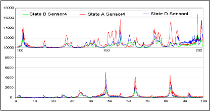

6b) Scans on tank modified with 1kg attached mass at A, B and D
Fig.6. Tank wall FRFs at Sensor 4 for stepped frequency scan (0.1Hz step)

Experiment 2, experiment 3 and experiment 4 were scans of the tank wall with modification 'W(a)', 'W(b)' and 'W(d)' respectively. Examples of the FRFs for these experiments are overlaid in Figure 3(b) (sensor 1), Figure 4(b) (sensor 2), Figure 5(b) (sensor 3) and Figure 6(b) (sensor 4) respectively. Note that in these figures the 100Hz to 200Hz range is again stacked above the 1Hz to 100Hz range with an arbitrary offset. Note also that in this figure W(a), W(b), W(c) and W(d) are represented by state 'a', state 'b' and state 'd' respectively. All three scans were taken over a period of one week.
The first point to note is that, below 140Hz, there is very little difference between the scans for the modified tank (with the single exception of the 90Hz mode at sensor 2 when the tank had modification W(a)). In other words there is generally no sensitivity to structural change below 140Hz. However, between 140Hz and 200Hz there is clearly more difference between the modified states, i.e. the higher frequency range discriminates between locations of structural modification better.
Between 196Hz and 200Hz there were dramatic indications on the spectra of the tank modified with 'W(b)' and 'W(d)' on all sensors but particularly on sensor 2. In some cases, most notably sensor 2, the change in amplitude was very pronounced. The modal amplitudes in this region of the spectrum for states W(b) and W(d) are 12 times the amplitudes in the unmodified state.
Inspection of the 100Hz to 200Hz frequency band reveals that, while the spectra of the tank wall in states W(b) and W(d) are similar to each other, that of state W(a) differs noticeably from both of them. In fact the spectrum of W(a) is very similar to that of the unmodified tank, suggesting that there was less sensitivity to this modification than for states W(b) and W(d) (there were nevertheless subtle indications of the mass in location 'a' such as the shift in frequency at the mode at 181.2Hz). The explanation for this lies in the symmetry of the tank wall. Figure 2 shows that in state 'd' and state 'b' the mass has approximately the same unequal displacements from the vertical butt welds (~ 106cm and ~313cm). However, in state A the displacements are approximately equal (156cm:162cm). The response to the modification is dependent on its relative proximity to the welds. As this does not appear to be the case below 100Hz one may assume that in this frequency range the welds do not play an appreciable role in the vibration and the wall vibrates as a continuous sheet. The mode shapes are harmonics of the first ovalisation mode and adopt a standing sinusoidal waveform with amplitude varying from maximum at the top to zero at the bottom of the wall. In addition the excitation force vector suppresses those modes that are not symmetrical about the cable. This property is exhibited all around the whole structure and hence also by the sensors and is characterized by the relative phases of all of the sensors being either 0° or 180°. The natural frequencies are called real normal modes of vibration. Figure 7 shows the unmodified tank time histories for modes at 63.7Hz and 82.1Hz. The phase of sensor 2 is matched with sensor 3 and the phase of sensor 1 is matched with sensor 4 in both cases. This restriction is imposed by the force vector that is generated by the cable. The force vector does however permit sensors 1 and 4, to be either in phase (mode at 63.7Hz) or out of phase (mode at 82.1Hz) with sensors 2 and 3.
