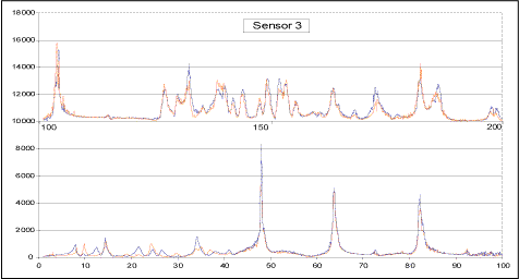

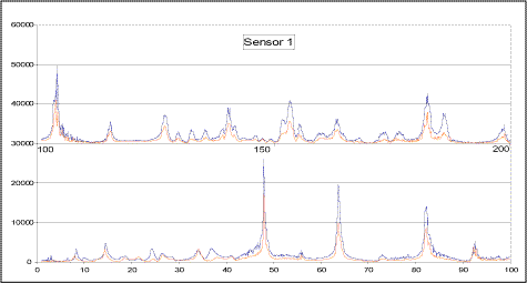

Experiment 1 and experiment 5 were repeat scans of the tank wall with no modification. Examples of the FRFs for sensors 2 and 4 for each experiment are overlaid in Figure 3 (a) (sensor 1), Figure 4 (a) (sensor 2), Figure 5(a) (sensor 3) and Figure 6(a) (sensor 4). Note that in these figures the 100Hz to 200Hz range is stacked above the 1Hz to 100Hz range with an arbitrary offset. Note also that the repeat scans were taken two weeks apart. Between the first and second experiment, the actuator cable was disassembled and then reassembled and re-tensioned. These scans all indicate good qualitative agreement between repeat experiments. There does not appear to be any difference in the repeatability between the upper and lower frequency ranges. The closest agreement appears to be in the frequencies of the modal peaks.
a) Repeat scans on unmodified tank (measurements taken 15 days apart)
b) Scans on tank modified with 1kG attached mass at A, B and D
Fig. 3. Tank wall FRFs at Sensor 1 by stepped frequency scan (0.1 Hz step)

The amplitudes of the peaks are noticeably more variable, although not excessively so. However it is worth pointing out an exception to this. A prominent mode appears at 97 Hz in the FRF of sensor 2 for one experiment but not the other. This is discussed below in relation to results from the 1Hz resolution scans.

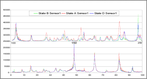

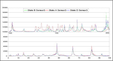

Experiment 3, experiment 5 and experiment 8 were scans of the tank wall with modification 'W(a)', 'W(b)' and 'W(d)' respectively. The FRFs for these experiments are overlaid in Figure 3(b) (sensor 1), Figure 4(b) (sensor 2), Figure 5(b) (sensor 3) and Figure 6(b) (sensor 4). Note that in these figures the 100Hz to 200Hz range is stacked above the 1Hz to 100Hz range with an arbitrary offset. Note also that all three scans were taken over a period one week.
The first point to note is that, below 100Hz, there is very little difference between the scans for the modified and unmodified tank (with the single exception of the 90Hz mode at sensor 2 when the tank had modification W(a)). In other words there is generally no sensitivity to structural change below 100Hz. However, between 100Hz and 200Hz there is clearly more difference between the modified and unmodified states, i.e. the higher frequency range has better sensitivity to structural change. The most important differences are discussed below.
Between 196Hz and 200Hz there are dramatic indications on the spectra of the tank modified with 'W(b)' and 'W(d)' on all sensors but particularly sensor 2. A prominent growth in modal amplitude, and a slight frequency shift, occurs at sensor 1 (tank wall states W(b) and W(d)), sensor 2 (wall states W(b) and W(d) and sensor3 (wall states W(a) and W(b)). Only sensor 4 is not sensitive to any of the added masses in this region of the spectrum. In some cases, most notably sensor 2, the change in amplitude is very pronounced. The modal amplitude at this region of the spectrum for states W(b) and W(d) are 12 times the amplitude in the unmodified state.
Inspection of the 100Hz to 200Hz frequency band reveals that, while the spectra of the tank wall in states W(b) and W(d) are similar to each other, that of state W(a) differs noticeably from both of them. In fact the spectrum of W(a) is very similar to that of the unmodified tank, suggesting that there was less sensitivity to this modification than for states W(b) and W(d). There is no obvious explanation for this since all modifications are in the same position relative to the actuator cable attachment points (see Figure 2). However state W(a) does show some notable indications. For example, between the modes at approximately 83Hz and 103Hz there is a subtle difference between the spectra of the unmodified tank and the tank with the modification 'W(a)' (see Figure 4). Apparently a pair of modal peaks detected on sensor 2 slightly above 90 Hz on the modified tank have slightly shifted frequency and widened (the second of these peaks is interrupted at the break between the two graphs). Indications also appear at about 110Hz in the sensor 2 spectrum of the tank with modifications 'W(b)' and 'W(d)' (see Figure 4). Despite being less dramatic than the modal amplitude increases between 196Hz and 200Hz, these spectral shifts are nonetheless, consistent in that all of the tank modifications produced a change in the this region of the FRF.
