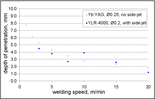

Following the findings from this initial investigation,[1] trials were carried out using an even higher beam quality and brightness YLR-4000Yb-fibre laser system, at 4kW, on steel tapered samples. Argon side-jet shielding was applied as a result of earlier observations. The beam quality of the YLR-4000 Yb-fibre laser measured 2mm.mrad. Using a 120/500 processing head (and a 50µm processing fibre), a focal spot diameter of 200µm was produced at a beam brightness of 1583x105W/mm2.sterad, i.e. 6.6 times higher than the YLR-5000 [1]Yb-fibre laser system used in the initial investigation. However, a spot diameter close to 400µm, as used in the previous trials, could not be achieved with the processing heads available. Instead, a 200µm spot size was selected, allowing the performance to be compared with that achieved with a 7mm.mrad Yb:YAG disc laser used in the initial trials.[1] This disc laser was equipped with a 200µm processing fibre and 200/200 processing head, producing a beam brightness of 51x105W/mm2.sterad, 31 times lower than the (new) YLR-4000 set-up used.
The welding performance of both these laser systems is shown in Figure 5, from which can be seen that the application of an argon side-jet shielding was unable to reproduce the performance enhancement observed from the initial trials.[1] However, for the brightest of the laser beams used, the 2mm.mrad YLR-4000 Yb-fibre laser focused in a 200µm spot, a step-change in welding performance was observed, as shown in Figure 5, between 7.5m/min and 10m/min. It was at this speed range also, that a step-change in welding performance (on steel) had been observed during the initial trials, for the YLR-5000 laser focused in a 400µm focal spot with the 120/500 process head. [1]
Fig.5. The welding performance on steel, of a 2mm.mrad Yb-fibre laser, YLR-4000, used at 4kW focused in a 200µm diameter spot, with side-jet shielding, compared with that of a 7mm.mrad Yb:YAG disc laser used at the same power and focal spot diameter (without side-jet shielding)
As mentioned above, an (ionised metal vapour) plasma was initially thought to have affected the steel welding performance for speeds below 8m/min. However, this was put in doubt, when argon (with a lower ionisation potential) resulted in a welding performance improvement similar that of helium, when supplied through a side-jet shielding arrangement. Moreover, Greses had shown that, when welding steel at the Nd:YAG wavelength, a plume instead of a plasma forms above the weld pool, comprising non-ionised metal vapour.[3] As the wavelength and power density at focus of the YLR-5000 Yb-fibre was similar to that of the Nd:YAG used in the initial trials,[1] for which this phenomenon had not been observed, no plasma was expected. Notwithstanding these arguments, disagreement remains amongst researchers on whether a plasma is created when welding with high-brightness lasers. Researchers in Germany, for instance, recently confirmed the presence of a 'weak' plasma when welding with high beam brightness lasers, although little information was published as to the conditions under which this plasma was formed. [4]
The authors note that in both cases where lower-than-expected welding performance was observed, i.e. for the YLR-5000 laser during the initial trials[1] and the YLR-4000 in recent trials, process heads with the same, long focal length focussing lenses of 500mm were used. The authors believe that the very narrow laser beam created by the long focal length lens results in a high enough power density above the processing point to result in partial ionisation of the hot metal vapour ejected from the weld pool. This creates a column of hot metal vapour plume mixed with a 'weak' plasma between the focussing lens and the processing point, which obstructs the laser power from entering the keyhole by either reflection or absorption. In case of a shorter focal length lens, the power density drops more quickly (considering the square relationship with the beam diameter) the further away from the processing point, creating less favourable conditions above the weld pool to form a plasma. Researchers in Germany, recently visualised the extent of the column of hot metal vapour ejected from the weld pool, which in some instances reached all the way up to the focusing lens positioned 500mm above the processing point. [7]
