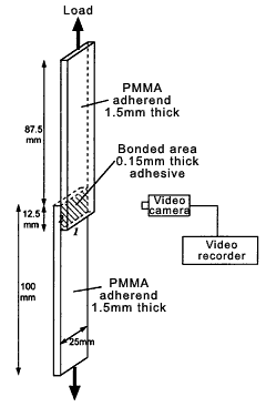

Since the aim of the work was to view damage evolution inside the joint, transparent adherends were needed. The adherend material used was polymethylmethacrylate (PMMA) and the adhesive was a two-part toughened acrylic. Acrylic adhesives were successful in bonding glass reinforced plastic [12] and the chosen acrylic adhered well to grit-blasted PMMA.
The lap-shear joint geometry was selected based on its ubiquitous nature and its ability to produce a realistic stress-state during mechanical testing. Details of materials, joint preparation, ageing environment and mechanical testing are given in Table 1. A schematic diagram of the test set-up is shown in Figure 1.
Table 1: Details of materials, joint preparation and testing
Substrate Polymethylmethacrylate (PMMA) sheet, 1.5mm thick
Adhesive Two-part toughened acrylic
Surface preparation Grit-blast; followed by degrease using 'Lotoxane', a petroleum distillate based solvent containing a blend of hydrocarbons
Joint details Adherends: 100mm x 25mm x 1.5mm
Single lap-shear samples: overlap length 12.5mm
Bond-line thickness: 0.15mm ± 0.05
Ageing conditions Hot/wet environment: 40°C and 95% humidity, no applied stress
Ageing times 0, 500, 1000, 2000 and 4000 hours
Number of samples Four samples for each ageing time
Mechanical testing Tensile loading at a test rate of 1mm/min
Video recording Simultaneously with the tensile test
Fig.1. Test set-up. Video equipment and tensile lap-shear sample

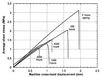

Results from the tensile tests on PMMA/acrylic single lap-shear samples are presented in Figure 2. This figure gives the joint average shear stress (i.e. load/joint area) versus cross-head displacement effectively measuring the elastic displacement of the sample ends, for samples aged for 0 to 4000 hours. Four samples from each ageing time were tested, with a typical example shown for clarity. Figure 2 shows that the mechanical response of the joints is significantly affected by the ageing prior to testing. The joint stiffness, proportional to the slope of the stress-displacement plot, decreases by 13% with the first 500 hours of ageing. There is no significant further reduction in stiffness up to 4000 hours of ageing. The joint failure stresses, averaged over the four samples at each ageing time, are shown in Table 2 and in Figure 3. The shear stresses at which damage initiates, which were determined for each of the ageing times by examination of the video images, are presented in Table 2 and Figure 3. The joint failure modes for each ageing time are summarised in Table 2.
Fig.2. Average shear stress in joint versus machine cross-head displacement. Tensile tests on PMMA/acrylic single lap-shear joints after various ageing times.

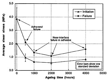

Fig.3. Average shear stress at damage initiation and final failure versus ageing time for PMMA/acrylic single lap-shear joints

Figure 3 shows that ageing reduces the stresses at which both damage initiation and final failure of the joints occurs. The changes are most marked in the first 1000 hours, with only a small reduction in the following 3000 hours. The slight increase in initiation and failure stress between 3000 and 4000 hours of ageing may be due to experimental scatter, arising from differences in joint preparation or testing. The standard deviations of results from the tensile tests are indicated on Figure 3 by the error bars. Note that there is a reduction in scatter associated with the change in failure mode from adherend failure to cohesive failure within the adhesive near the interface.

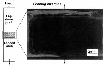

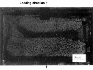

With increased ageing time the physical appearance of the joint bonded area was changed - the adhesive layer stopped being transparent and became whitened and opaque. The joint area affected increased from 0% with no ageing, to 100% after 2000 and 4000 hours of ageing, Table 2. Examples of the damage due to ageing are given for 500 and 1000 hour aged samples, Figures 4 and 5. The observed whitening effect appears to be at, or near to, the interface between the adhesive and the PMMA substrate, based on the focus position from optical microscopy. The nature of the whitening is difficult to assess since through-transmission optical microscopy at the edge of the whitening effect reveals only a diffuse region of opacity, Figure 6. No major features are apparent other than small particles within the adhesive. Some indication of the effect of the whitening is revealed when the joint is allowed to dry after ageing. The opaque region changes and micro-cracks form at the edge of the whitened region, Figure 7. This suggests that the original opaque whitening is due to physical absorption of the water, leading to swelling of the adhesive layer. On drying, the adhesive shrinks, forming the micro-cracks.
Fig.4. PMMA/acrylic joint bonded area after 500 hours ageing
Fig.5. PMMA/acrylic joint bonded area after 1000 hours ageing

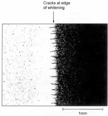

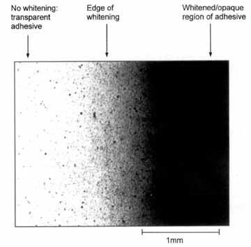

Fig.6. Through-transmission optical micrograph of edge of opaque region in PMMA/acrylic joint after 500 hours ageing
Fig.7. Through-transmission optical micrograph of edge of opaque region in PMMA/acrylic joint after 500 hours ageing, followed by 100 hours drying in air at 20°C
Figure 3 shows how the failure mode of the joints changes with increased ageing time. With no ageing, damage initiates in the adhesive fillet - apparent as whitening - and final failure is in the adherend. After 500 hours ageing, damage initiation changes to being in the adhesive layer within the joint; there is damage growth in the adhesive and final failure is in the adherend. After 1000, 2000 and 4000 hours of ageing, damage initiates in the adhesive layer in the joint and final failure is by debonding.

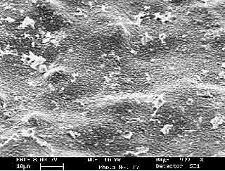

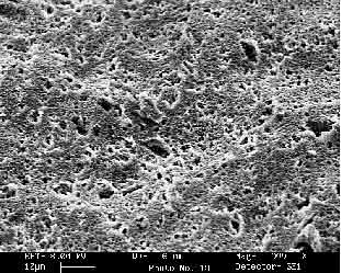

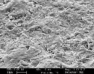

Figures 8 and 9 show SEM images of the fracture surfaces of a joint aged for 1000 hours, while Figure 10 shows an image of a grit-blasted PMMA surface, prior to bonding. Figure 8 shows an adherend failure surface that visually appears to have little or no adhesive on it. However, a close comparison of Figures 8 and 10 shows that the morphology of the fracture surface is very different from that of the PMMA surface prior to bonding. This indicates that there is a thin layer of acrylic adhesive present on the surface seen in Figure 8 and that failure of the adhesive occurs near the interface. Figure 9 is a SEM image of the opposite surface to Figure 8, showing the failed toughened acrylic adhesive. Ductile tearing and the presence of micro-voids from the failure process are visible. These micro-voids appear to be similar to those seen in toughened epoxy adhesives. [19]
Fig.8. SEM image of fractured PMMA/acrylic joint with near-interface failure in the adhesive. The scale bar is 10µm long.
Fig.9. SEM image of fractured PMMA/acrylic joint. Opposite face to Fig.8, showing cohesive failure in acrylic adhesive. The scale bar is 10µm long.
Fig.10. SEM image of grit-blasted PMMA surface. No adhesive present. The scale bar is 10µm long.

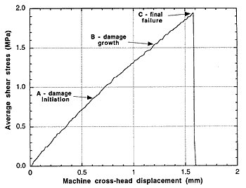

By examining the video images it was possible to track the evolution of damage in the joint during loading and investigate the effect of ageing on the way in which damage grew. For all the tests, significant damage was observed in the joint prior to failure.
Un-aged joints showed a typical lap-shear response. Failure starting as cracking in the adhesive fillet, with very visible whitening and final failure occurring in the substrate close to the adhesive fillet. [20] Joints aged for 500 hours had 29% whitening within the bonded area prior to loading. As the joint was loaded this whitening extended. Final failure of the joints was by failure in the adherend, usually at the edge of the whitening damage.

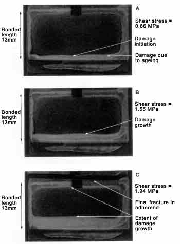

The evolution of damage growth as the joint was loaded is illustrated in Figures 11 and 12. Figure 11 shows the variation in average joint shear stress with cross-head displacement for a joint aged for 500 hours. Figures 12a, b and c show images of the bonded section of the joint corresponding to the three points A, B and C marked on Figure 11. Figure 12a shows the joint with only the damage due to ageing - the whitened area at the edge of the bonded region. At the load shown in this figure, damage is on the point of growing. Figure 12b, taken at a slightly higher load, shows growth of the whitening damage caused by the applied loading, mainly at the bottom edge. The joint at final failure, caused in this case by adherend fracture, is shown in Figure 12c, illustrating still more growth of the damaged region in the joint.
Fig.11. Average adhesive shear stress versus machine cross-head displacement. Tensile test on PMMA/acrylic joint - 500 hours ageing
Fig.12a, b and c. Damage growth in PMMA/acrylic joint under tensile load
For samples aged for 1000 hours, there was rather greater whitening of the joint prior to loading, with 56% of the joint area affected. During loading the damage was seen to extend into the transparent bonded area. Final failure of the joint was by debonding of the two adherends, with no substrate fracture. The 2000 and 4000 hour aged samples had whitening extended over the whole joint area, although the two adherends were still effectively bonded. During loading it was possible to observe further whitening of the joint and a damage front progressing through the bonded area. Final failure was by complete debonding of the two adherends, with no adherend fracture.
