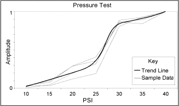

3.1 Pressure Requirement
The transmission of energy is facilitated by mechanical traction between the transducer and the pipe surface. The inflatable collar was used as a pneumatic system that applied a load at a normal to the surface to assure firm contact. A minimum pressure should be identified for the MFCs that will allow good coupling. An experiment to characterise the relationship between pneumatic load and signal amplitude was required.
In this experiment, the input pressure was increased from 10psi to 40psi with a step increase of 5psi. This test was carried out using the centre ring of the prototype in pulse-echo mode at four locations on a 4.1m long pipe. The peak to peak amplitude of the reflections from the pipe end were recorded and compared with the input pressure.

4 Results
4.1 Pressure Requirement
The pressure test was repeated four times. The data is plotted in Figure 3 and a trend line has been added.
Fig.3. Pressure test results for four tests. The measured amplitudes have been normalised between 0-1 for comparison

The pressure test showed that the MFCs used could be coupled well to a steel pipe with as little as 30PSI applied to them. Although the MFCs had no solid housing, there was generally less ringing observed, which indicates good coupling. Both tools shared the issue of being sensitive to a 'switch on' spike shortly after transmission ( Figure 4). The three ring excitation test showed that the prototype tool was equally capable of detecting the defect as the state of the art, although the ring spacing chosen limited the output power to the point where the recorded amplitude was lower.
