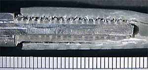

For both the control and Comeld TM specimens, the joint was manufactured by lay-up of preforms of 400g/m2 plain woven E-glass fabric (Carr Reinforcements) onto the metal specimens, followed by vacuum infusion of polyester resin (Crystic 489PA) into the glass fabric.
4.1 Testing and results
The Comeld TM and control specimens were loaded in tension at the rate of 1mm/minute until failure. Representative load-displacement curves are shown in Fig.14.
Fig.14. Load-displacement curve
Fig.15 shows damage mechanisms that occurred before and during failure of the specimens.

The load displacement curves, shown in Fig.14, demonstrate that the Comeld TM joint tested had a significantly greater load carrying capability than the corresponding control joint. The area under the load-displacement curves corresponds to the energy absorbed during failure of the specimen. The energy absorbed by the Comeld TM joint was more than double that absorbed by the control joint.
In the control specimens, failure occurred at the bond-line. These failures were very sudden and there was very little damage to the metal or composite substrates.
In the Comeld TM specimens, damage was visible before failure as whitening of the composite caused by matrix cracking. There was deformation of the metal proggles before failure of the composite and the Comeld TM specimens eventually failed due to shear failure of the composite just outside the proggle area. The damage in the metal and composite described above contributed to the additional area under the graph and therefore extra energy absorbed during failure when compared to the control specimens. Similar work on other material combinations has also demonstrated improved mechanical performance of Comeld TM joints over control joints. [14]
It can be concluded that the application of a new surface treatment technique, called Surfi-Sculpt TM , to a new joining system, called Comeld TM , improves the mechanical performance of joints between composite materials and metals in the following respects:
