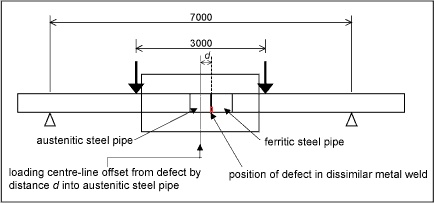

Loading
As shown in Figure 4, the test assembly was subjected to four-point bending in order to promote ductile tearing of the defect, with the ferritic and austenitic sections of interest in the mock-up held at a temperature close to 300°C. The test assembly was positioned in the loading rig to give equal ram displacements and loads on either side of the mock-up.
Fig. 4. Four-point bending loading configuration of ADIMEW test assembly

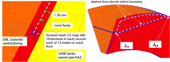

Figure 12 shows two pictures relating to the defect itself. The left-hand picture shows the focused mesh surrounding the crack front, where the latter intersects the plane of symmetry. The dashed white line denotes where the coincident crack flanks meet the vertical symmetry plane of the pipe. There are 12 rings of elements in the square section box surrounding the crack front, with 32 elements around each ring. The innermost rings of elements immediately adjacent to the crack front are standard type C3D8H but each has one face collapsed onto the local segment of the crack front. The right-hand picture in Figure 12 shows only weld metal elements on the austenitic side of the defect plane. Dashed lines indicate the boundary of the defect. A total of 12 equal length segments, and so 12 elements lengths, are used along the half-length crack front modelled in the mesh. There are 13 nodal positions along the crack front; the drawing points out the nodes labelled 'J 11 ' at the middle of the crack front (at the vertical plane of symmetry) and 'J 23 ' where the crack front meets the outer pipe surface.
Fig. 12. Left picture shows focused mesh around crack front. Right picture is section through plane of defect, showing weld metal only: with 13 nodes on (half) crack front from 'J11' at middle to 'J23' on outer pipe surface

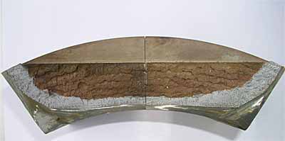

The actual ADIMEW pipe test showed a substantial amount of ductile crack growth of the initial defect, a maximum of 28.1 mm through the wall of the pipe, but with no change to its circumferential length around the pipe, as illustrated in Figure 20. This suggests potential for leak-before-break rather than a guillotine failure. The test is therefore a demonstration that supports safety.
Fig. 20. Post-test fracture face of the actual ADIMEW test pipe
Such large extent of tearing observed in the test should not be treated with undue alarm; it is a consequence of the maximum ram displacement applied. The bending moments required for significant growth of the defect are close to those required for plastic yielding or collapse of the uncracked pipe. The defect makes negligible difference to structural behaviour of the pipe as a whole. Moments of this magnitude would not be expected to occur during normal operation of such pipework in real plant.
Pre-test discussions and studies envisaged that tearing would be limited to about 9 mm: this led to the maximum 26 mm crack depth (i.e. 17 mm initial plus 9 mm tearing) considered in this study. Crack behaviour up to about 9 mm of tearing was successfully predicted by finite element J-based methods. Bending moments for initiation and maximum load were approximately correct and support the use of such analysis.
The toughness of the mock-up buttering layer as measured by small specimens appears to be consistent with a fairly shallow resistance curve. The flat moment versus crack depth or CMOD curves determined in the test reflect the shallow resistance curve of the buttering material. There is therefore potential for large amount of stable tearing if the loads applied are sufficient. The microstructural and mechanistic reasons for the flat R curve behaviour are not entirely clear at present.
The cracked section of the pipe is subjected to a predominantly tensile stress field. This may impose less plastic constraint ahead of the crack front than the side-grooved three-point bend and compact tension specimens used to provide the various J-R curves. This difference in crack tip plastic constraint can lead to higher values of apparent fracture toughness in the ADIMEW test pipe geometry: see for example Ref. [12] . These higher values of toughness would give less extensive ductile tearing than predicted here at a particular measured value of a test parameter such as bending moment or CMOD.
However, the test results obviously do not bear this out. The apparent toughness of the buttering appears to be consistent with a shallow resistance curve extrapolated from both valid and invalid test results on deeply-cracked(albeit small) bend specimens. It is therefore important to find out, in any future studies of the ADIMEW test, why there appears to be no benefit or margin conferred by structural constraint. One reason could be the confinement of the crack tip plastic zone by the high yield strength ferritic parent pipe; despite gross yielding taking place in the uncracked 316L pipe. More work on this subject linking the microstructure of the buttering layer to the crack tipplastic zone would be worthwhile.
