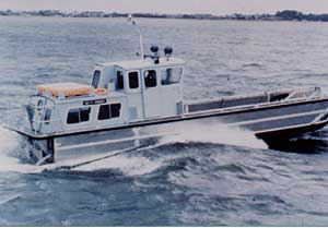

Figure 1 shows an example of adhesively bonded aluminium in the marine industry.
Fig.1 Toughened acrylics show their durability in the assembly of a naval landing craft. Rivets are reduced to a minimum when the adhesive is used. The small number of rivets are used to pull the sections together and hold themin position whilst the adhesive cures

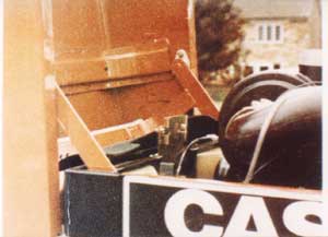

David Brown Tractors use a rubber-toughened epoxy to bond the steel bonnet and various stiffeners on the model shown in Fig. 2. Anaerobic adhesives are used extensively in a variety of engine threadlocking, sealing and retaining applications. However, caution has to be exercised about application to certain engine parts, where temperatures exceed adhesive capabilities, e.g. cylinder head gaskets where temperature may rise beyond 200°C.
Fig.2 Bonding of steel attachments
