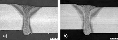

These conditions were also used to weld joints with up to a 2mm high mismatch. Figs.2a and 2b show sections from such welds with 0.6 and 1.0mm mismatches. In particular, these figures show that a Class B root and cap profile were achieved to a mismatch of 0.6mm (Fig.2a), with the root toe blend angle becoming re-entrant on the higher plate when the mismatch increased to 1.0mm (Fig.2b).
Fig. 2. Cross-sections through a hybrid weld made over a joint with mismatch a) 0.6mm mismatch b) 1.0mm mismatch

These same conditions were also used to weld joints with gaps. In terms of the weld profile, Figs.3a and 3b show cross-sections at nominal gap widths of 0.3 and 0.6mm width, respectively. In this weld a small amount (0.3mm) of mismatch has been introduced inadvertently. Nevertheless, as Fig.3a shows, the depth of underfill is 0.26mm at a nominal gap width of 0.3mm (ie to Class B), becoming 0.56mm deep at a nominal gap width of 0.6mm (outside of class B requirements). The root profile was acceptable up to a gap width of at least 1.2mm. Only one 0.7mm diameter sidewall pore was detected in the radiograph of this weld, ie the internal quality was also to Class B. The results suggested that the base conditions could also be used to weld joints with gaps up to, at most, 0.3mm wide.
Fig. 3. Cross-sections through a hybrid weld made over a joint with gap a) 0.3mm gap b) 0.6mm gap
