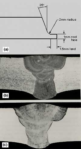

The A TIG procedure should be compared with conventional TIG welding procedures where a substantially greater number of weld passes would have been required. For example, in welding 60 mm diameter, 5.7mm wall thickness stainless steel, a stringer welding procedure will require eight passes with filler wire addition to fill the joint preparation. However, the number of passes can be reduced to four by using an electrode weaving procedure.
Welding procedure (8 stringer passes):
Welding current, pulse
Welding current, background
Welding speed
Wire feed speed
Shielding gas
72-199A/800ms
30-40A/400ms
160s/rev
0.2-0.3m/min
argon 1% H2
Welding procedure (4 weaving passes):
Welding current,
Weave rate
Weave amplitude
Weave frequency
End dwell
Welding speed
Wire feed speed
Shielding gas
81-105A
10mm/s
2, 2.5, 3, 5mm
0.36-0.52Hz
0.3-0.4s
165-200s/rev
0.75-0.9m/min
argon
The joint preparation and the sections through the welds for the two procedures are given in Fig 5.
Fig.5. Orbital tube welds in 60mm diameter, 5.7mm wall thickness, type 304 stainless steel tube using conventional TIG process with stringer and weaving welding procedures:
a) Joint preparation,
b) Weld with a stringer bead procedure and
c) Weld with an electrode weaving procedure
