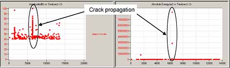

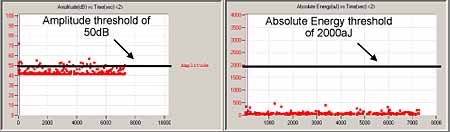

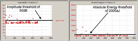

Acoustic emission monitoring was found to be significantly more sensitive to the detection of the initiation of cracking than monitoring the clip gauge. For example, during the initial test used for calibrating the AE, cracking was detected 4 hours before any appreciable clip gauge response was detected. During the experimental trials, three different types of signal were identified.
  • A signal emitting waves with amplitude between 50 and 60dB and an absolute energy lower than 2,000aJ, during crack initiation and propagation
  • A signal emitting waves with amplitude between 50 and 70dB and an absolute energy above 20,000 aJ, during crack initiation and propagation
  • A signal emitting waves with amplitude between 80 and 100dB and an absolute energy above 20,000,000 aJ, in the latter stages of crack extension.
Examples of AE data acquired during testing are shown in Figure 3. Note that these data are correlated with fracture location, as described in sections 3.3 and 3.4.
Fig.3. Examples of the AE data acquired during testing a) AE signal of the crack occurring in Zone Δ
b) AE signal of the crack occurring in Zone Φ
c) AE signal of tearing

AE monitoring proved capable of capturing the earliest fracture initiation events that occur during environmental testing of dissimilar joints. This technique proved more capable than the other crack monitoring methods commonly employed for this type of environmental test.
Multi-parametric analysis of the AE events combined with examination of the fracture faces enabled the identification of specific crack features, corresponding to these acoustic signatures. Analysis of the AE events proved capable of differentiating between failure in different microstructural zones. Specifically, analysis of the amplitude and energy of the signal provided data that indicated where in a narrow 50µm or so wide microstructural zone failure initiation occurred ( Table 2).
