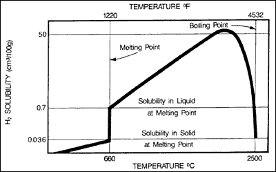

Although possible, the laser welding of aluminium is generally perceived to be difficult because of the initial high surface reflectivity and the high thermal conductivity of aluminium, both of which contribute to the risk of weld imperfections such as lack of penetration or cracking, in certain alloys. Weld metal porosity is also frequently associated with the laser welding of aluminium and this weld imperfection is the subject of the work described in this paper. Weld metal porosity is always an issue when fusion welding aluminium [4,5] and laser welding is no exception. What causes porosity and, in particular, how it is formed in laser welds are issues still being debated, but not considered in detail here. Some suggest that volatilisation of low boiling point constituents in some of the aluminium alloys causes keyhole instabilities, others believe it is simply entrapment of shielding gas in the solidifying weld pool, whilst others attribute porosity to hydrogen entrapment during weld pool cooling and solidification. [1,6,7] Irrespective of the cause however, porosity is generally categorised as either fine or coarse, typically differentiated at an average pore diameter of 0.5mm. Fine porosity appears as a distribution of spherical pores and is generally understood to originate from hydrogen or from the rejection of dissolved shielding gases on solidification. Coarse porosity is characterised by larger, more irregularly shaped voids, randomly distributed throughout the weld bead. These are generally considered to be the result of keyhole instabilities and are typically present in partially penetrating welds. [1,7] Coarse porosity can have a detrimental effect on a welded joint's mechanical performance. [8]
The work described in this paper details Nd:YAG laser welding trials, carried out on 3.2mm thickness 2024 aerospace aluminium alloy, aimed at reducing both the fine and coarse porosity in aluminium weldments. Particular efforts were on reducing the fine porosity, and especially fine porosity resulting from hydrogen-entrapment. Hydrogen dissolves very rapidly into the aluminium weld pool [4] but has a very low solubility in solid aluminium, as is shown in Figure 1. With a high-speed process such as laser welding, the time available for diffusion is sufficiently low that a certain amount of hydrogen can become entrapped in the solidifying weld pool. [6] Hydrogen can originate from the parent material, the filler wire or the shielding gas and these sources were all investigated. In addition, the performance of twin-spot Nd:YAG laser welding was assessed to establish whether this technique resulted in a reduced level of porosity, because of the resultant elongated weld pool found when using this technique. [9]
Fig. 1. Solubility of hydrogen in aluminium

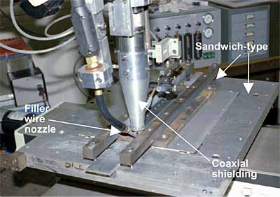

The welding trials were completed using a high-power flashlamp-pumped continuous wave (CW) Nd:YAG laser delivering 3kW of laser power to the workpiece through a 0.6mm diameter step-index fibre optic. Initial trials used a single spot beam focus 1:1 imaging lens, producing a 0.6mm minimum focus spot diameter. Square-edge butt welds were produced in 3.2mm thickness 2024-T3 aluminium alloy (and some in 3.2mm thickness 6056-T4 aluminium alloy) by traversing the laser output housing, mounted on an articulated arm robot, over a stationary welding jig, holding the samples in position during welding in the flat (PA) orientation ( Figure 2). The material samples were 150mm wide and 300mm long with the cold band sawn (long) edges dry machined to ensure a good joint fit-up. The samples were degreased with acetone immediately after the dry machining operation. Industrial grade helium (purity grade 5.0 or 99.999% pure) conforming to BS EN 439:1994, [10] typically containing around 5ppm moisture, was used for shielding both top and bottom of the weld pool. The 1.2mm diameter 2319 and 4047 filler wire for the 2024 and 6056 aluminium alloy respectively, was introduced into the leading edge of the weld pool. [11]
Fig. 2. Set-up for welding trials
Process parameters such as welding speed, laser focus position (in relation to the material surface), filler wire position (in relation to the laser-workpiece impingement point) and shielding gas flow rates were varied to obtain fully penetrating, visually acceptable, square-edge butt welds, in accordance with BS EN ISO 13919-2:2001. [12] The absence of cracks in the weld metal and heat-affected zone (HAZ) was confirmed through radiographic and macro-metallurgical examination. The presence of micro-cracks in weld metal or HAZ was not examined. Subsequent welds were produced using the process parameters established earlier, but with different conditions for parent material cleanliness, filler wire cleanliness and condition and delivery of process shielding gas. These factors, widely considered to be the main causes of hydrogen-induced weld metal porosity, were varied in a controlled fashion. In addition, the effect of a twin-spot versus a single-spot laser energy distribution on the level of weld metal porosity was also investigated.

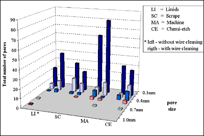

Fig. 5. Pore counts for different parent material cleaning methods

As with the earlier results (depicted in Figure 5), little difference was noticeable between the linished and the chemi-etched samples. If anything, the chemi-etched samples exhibited less porosity than the linished samples, because of the uniformity and non-manual operation of the chemi-etching, and, contrary to earlier trials, because the chemi-etch operation was completed much earlier prior to welding, i.e. within 24 hours, through the use of smaller batches. Nevertheless, some coarse porosity was present in these welds, which was not present in earlier welds carried out using similar (cleaning) conditions or in any of the welds carried out subsequently. A contributing factor to the coarse porosity was the 40% increase in welding speed, i.e. 1.75m/min instead of 1.25m/min used before, necessary to compensate for the higher power density resulting from the 25% reduction in focus spot diameter, i.e. 0.45mm instead of 0.6mm used in earlier trials.

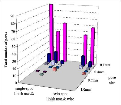

Twin spot energy distribution versus porosity
Laser welding is a high-speed process. As such, time for hydrogen bubbles to escape from the solidifying aluminium weld pool is limited, which contributes to the incidence of weld metal porosity in aluminium laser welds. Subsequent trials were carried out to examine if an elongated weld pool created by a twin-spot laser energy profile obtained using a process head with an effective focal length of 150mm, would delay this rapid solidification and thus allow more time for hydrogen to escape. [9] Welds were produced in both 2024 and 6056 aluminium alloy using a twin-spot energy profile with a 0.27mm spot separation and a 50/50 energy distribution between the spots. These conditions were based on previous TWI work. [16,17]
Figure 6 and Table 3 show that the levels of coarse porosity for welds produced with a twin-spot energy profile are lower when compared to those in welds produced (previously) with a single-spot energy profile. However, not only was the twin-spot technique applied, but the welding was also carried out at lower travel speeds, i.e. between 0.8 and 1.0m/min for the twin-spot energy profile and 1.75m/min for the single-spot energy profile. It was not possible to separate the twin-spot energy profile from this lower travel speed, to investigate their individual effects on the reduction of weld metal porosity, because the low travel speed was inherent to the twin-spot technique. With this technique, the total laser power is shared between the two spots, creating a lower power density in each of the spots, necessitating a lower travel speed, when compared with the single-spot technique, to produce fully penetrating welds in a given material thickness. Furthermore, it was not possible to produce fully penetrating butt welds using the single-spot technique at this lower travel speed either, as such welds had excessive penetration and in most cases local burn-through.
