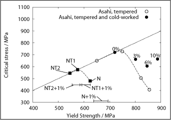

Asahi and Ueno [9] have carried out a similar study on a seamless pipe material of yield stress around 700 MPa. Tests were NACE TM0177-90 method A (constant load tensile tests) in NACE TM0177 solution A (5% NaCl + 0.5% acetic acid, saturated with H2S). The threshold stress was defined as that for which there was no failure after 720 h (it is not known, unfortunately, at which stress intervals tests were carried out, and therefore it is difficult to estimate the uncertainty that might exist on the value of the threshold stress). For prestrained specimens, deformation was by tensile straining. The authors varied the strength of the material by varying the tempering temperature between 640 and 720°C, and the samples tempered at 700°C were strained to 3, 6 and 10% prior to SSC testing. In this case, the authors did report the yield stress of the strained material.
Figure 1 compares the result of both studies by showing the effect of varying the yield strength through tempering (variations outlined in dashed lines) and through work hardening (individual points with indication of the degree of work-hardening). As can be seen, while in both cases, there is a detrimental effect of strain on the threshold stress, the conclusions differ significantly. Baldy's work indicates that the effect of strain on SSC susceptibility is greater than that of the corresponding increase in strength alone. For example, the critical stress for sample NT2 following straining to 1% (indicated in Figure 1 as NT2+1%) is significantly lower than that of sample NT1; however the estimated yield stress of sample NT2+1% is approximately equal to that of samples NT1.
Fig.1. The critical stress SSC of for N-80 and Asahi's steels in various conditions. In Baldy's work [7] , the strongest material was only normalised, while materials of lower strength were normalised and tempered. The yield stress of the strained material was estimated by the present author, using two methods which provide lower and upper bounds for possible values. The critical stress was taken, by the present author, as being the highest stress at which no failure occurred in 1000h. Asahi and Ueno's work [9] provide threshold stress and yield stress in strained conditions
Although Asahi and Ueno [9] concluded that the detrimental effect of cold-work on SSC resistance was probably caused by an increase in yield stress, their results indicate that the effect of strain on SSC susceptibility is less than that of the corresponding increase in strength. In this sense, their conclusions are opposite to those of Baldy. As can be seen in Figure 1, the points for strained material lie above the curve for the materials whose strength was varied by changes in the tempering treatment.
Figure 1 also suggests a behaviour whereby the threshold stress firstly increases with increasing yield strength, but decreases beyond a given value which perhaps depends on the material under consideration. However, it should not be assumed that the threshold stress equals the material yield stress in this region. This is possibly only a consequence of the fact that the investigators did not carry out tests for stresses above the yield stress. Indeed, investigations where loads have been allowed to exceed the yield stress have demonstrated threshold stresses above the as-received yield stress. [12] Nevertheless, it appears as if below a given value, the SSC threshold stress is at least equal to the as-received yield stress.

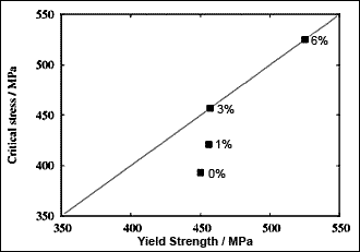

Further results by Asahi et al [10] appear to illustrate a rather different behaviour for a lower strength steel (450 MPa, composition given in Table 1). In this case, the threshold stress was below the as-received yield stress. However, following cold-working by tensile straining, the threshold stress increased and was found to be at least equal to the new yield stress ( Figure 2). These results are surprising for a number of reasons. Firstly, the authors demonstrate that the material investigated has a yield point, with a Lüders strain about 3%. It is therefore surprising that the material strained to 1% plastic strain behaves differently from both the as-received material and the material strained to 3%. It is reasonable to expect that the material strained to 1% will exhibit regions strained to 3% plastic strain and regions with little or no deformation. The cracking resistance should then be dictated by the weakest regions, which, according to the results of the authors, are the unstrained one. One would therefore expect the critical stress to be identical to that in the as-received samples.
Unfortunately, as is often the case in similar studies, the authors do not report the details of their test programme and it is difficult to comment on the significance of the increase compared to the expected accuracy with which the critical stress is estimated. It seems reasonable however, to suggest that the increase is well within the uncertainty typically accompanying the determination of the critical stress. Secondly, that the increase of strength should result in an increase of critical stress is opposite to virtually all other results identified in this review.
Fig.2. The critical stress for the SSC of a low strength steel as investigated by Asahi et al. [10] Cold work appears to result in an increase of the critical stress

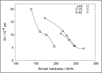

Treseder and Swanson [13] investigated the effect of cold work on SSC resistance for three API steel grades J55, C75 and X52. In this case, cold work was applied by cold rolling to 4, 8, 16 and 32% thickness reduction. Chemical composition was only provided for the C75 tubing material (Table 3). The tests consisted of placing three point bend specimens, with two drilled holes, in a solution of 0.5% acetic acid in distilled water, saturated with H2S (Shell Sc test). In this test, of four weeks duration, the stress in the outer fibre of the specimen was estimated from the deflection of the specimen. As discussed earlier, because of the presence of stress concentrators (holes) and because, in this procedure, the stress is estimated from the deflection of the beam whether in the elastic or plastic strain regime, this stress has little physical meaning, making the test useful only for comparative studies. From a number of experiments at different values of stress, the Sc value is determined, where Sc is the estimated stress giving a 50% probability of failure. Prior deformation was by cold rolling. The results obtained by these authors are shown in Figure 3. According to the authors, a value of Sc=10 (x104 psi) is the lower limit for acceptability and is the basis of the hardness limit of 235 HBN (~247HV) recommended by NACE (at that time). In this case however, it was shown that some of the cold-worked materials had values of Sc under 10, although their hardness was below 235 HBN.
Table 3: Composition of the tubing steels used by Treseder and Swanson [13] (*) not indicated in the reference, standard requirements are given for reference
GradeCMnPSSiMoNiCrCu
C75 0.45 1.62 0.02 0.014 0.20 0.19 0.014 0.012 0.024
X52 (*) <0.20 <1.40 <0.030 <0.030 - - - - -
J55 (*) <0.36 <1.60 <0.030 <0.030 - - - - -
Fig.3. The effect of hardness increase (caused by cold working), on the SSC susceptibility of three API grade steels. Increases in hardness were obtained by cold rolling to 4, 8, 16 and 32% thickness reduction. AfterTreseder and Swanson [13]

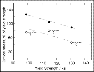

Dvoracek [14] carried out tests on P-110 grade heat-treated (quenched and tempered) to different strength levels and cold-worked. The composition of the material is given in Table 4. The tests were in distilled water saturated with H2S (it is not clear from the text whether the solution used for this particular set of experiments contained NaCl or not). The samples were notched cantilever beams. The author reported a 40% reduction of the threshold stress for SSC between standard and cold-worked samples, for materials of similar strength before cold-working (Figure 4). Unfortunately, the degree of cold work and effect on hardness are not reported, and could not be estimated as the details of the cold-working procedure are left unclear. It should therefore be borne in mind that the data points for cold-worked material in Figure 4 should probably be located further to the right, having higher yield stress values than the corresponding initial materials.
Table 4: Composition of the P110 casing material used by Dvoracek [14]
EltCMnPSSiCuNiCrMoAl
wt% 0.45 1.18 0.009 0.028 0.32 0.03 0.02 0.08 0.01 0.046
Fig.4. The effect of cold working on the critical stress for SSC in saturated H2S solution. After Dvoracek. [14] Filled circles are for unstrained material, empty circles for cold-worked. As in Dvoracek's work, the data for cold-worked material are shown assuming the yield stress has not been affected. This is, however, unlikely tobe correct, as illustrated by the question marks indicating a possibly higher yield stress value

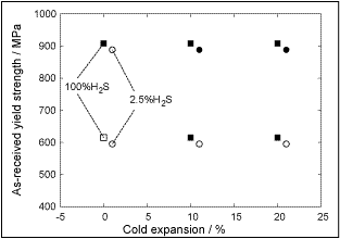

More recently, a number of studies have been concerned with the effect of cold expansion on the resistance to sulphide stress cracking of pipes. [16,17,18,19] Mack et al [16] investigated the SSC resistance of L-80 (as-received yield stress 615 MPa) and P-110 (as-received yield stress 908 MPa) pipes before and after expansion by 10 and 20%. The tests consisted of four point bend samples loaded at100% of their yield stress, in NACE solution A saturated with H2S and in less severe conditions (5% NaCl in distilled water, 2.5% H2S with balance CO2). The results suggest an effect of straining in both materials. However, this is not perceived in L-80 when testing in the mild sour solution, as the material passed all the tests, or in P-110 in the 100% H2S solution, as all the tests failed. The reference yield stress was that of the actual material and therefore accounted for possible effect of cold work. Interestingly, the P-110 grade showed a significant drop in longitudinal yield stress after expansion (from 908 in the as-received condition to 680 MPa for both 10 and 20% expanded). As the actual yield stress was used to determine loading conditions for SSC tests, the P-110 tubing material would have been tested at a significantly lower stress (680 MPa compared to 908 MPa) when in the cold expanded condition.
By contrast, the same authors only used the as-received yield stress for determination of loading conditions in further work carried out on P-110 material. [18,19] In this case, tests were carried out using C-ring specimens in a solution of 5% NaCl in distilled water (gas: 1% H2S/balance CO2) and stressed to 100% of the as-received material yield stress. The composition of the materials investigated are given in Table 6. As in the earlier study, [16] cold work and strain ageing appeared to be significantly detrimental to the SSC resistance of the material. This work also shows that, not only can failure occur as a result of straining (in a material which would otherwise pass the given SSC test), but also that it tends to occur faster with increasing degree of plastic strain. These results are however reported qualitatively as graphs with an arbitrary scale and it is therefore not possible to exploit them further.
Fig.5. Outcome of SSC tests in 100% H2S (squares) and a 2.5% H2S (circles) solutions, for L-80 and P-110 pipe materials, using data from [16] . Empty symbols indicate a pass, filled symbols a fail

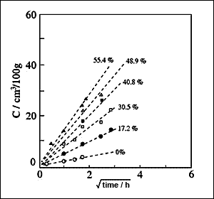

Cold work results in an increase in both vacancy and dislocation densities, and one would therefore expect the hydrogen content of a steel to increase with cold work. Numerous studies have indeed reported such effects. For example, Hudson and Stragand [29] measured the hydrogen concentration in steels cold-worked to different amounts, after different exposure times to an aqueous H2SO4 solution. The results indicated that not only the total hydrogen concentration but also the rate of absorption increased significantly with increasing amounts of cold work ( Figure 7).
Fig.7. Hydrogen concentration as a function of exposure time to an aqueous H2SO4 solution. After Hudson and Stragand. [29] Cold work increases the amount of hydrogen absorbed and the rate of absorption
Huang and Shaw [30] have investigated the effect of cold work on the electrochemistry of corrosion in sour service and found that an increase in cold work leads to an increase in corrosion rate and potential. The current density increased for up to20% cold work (thickness reduction). The authors suggest that this is due to surface alteration by the cold working process, which in turn enhances both ad- and absorption of hydrogen. [4] Huang et al [31] have later confirmed that cold work results in both an increase in permeability and a decrease in diffusivity of hydrogen in steel. This implies an increase in the 'solubility' of hydrogen in the steel (since permeability is a function of diffusion and solubility), and the authors have suggested that cold work enhances hydrogen uptake.

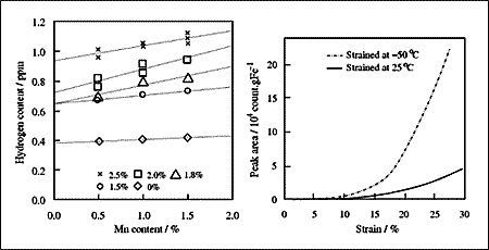

Recent work by Nagumo et al [32] has demonstrated an effect of both the Mn content and the temperature of straining on the resulting increase in hydrogen content (Figure 8, left). Hydrogen absorption increased with plastic straining, and more importantly, increased as the straining temperature was decreased (Figure 8, right).
Fig.8. Left: effect of strain and manganese content on the amount of hydrogen absorbed in identical conditions. Right: effect of the temperature at which the material is strained, on the amount of hydrogen subsequently absorbed in identical conditions. After Nagumo et al [32]

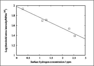

Hydrogen content and embrittlement
There is no questioning, from the literature, that cold-worked material will absorb more hydrogen and will do so faster than annealed materials. This leads to the question of whether embrittlement and hydrogen content are correlated. Numerous results indicate that this is the case. For example, Lucas and Robinson [33] have reported a strong correlation between threshold stress intensity and diffusible hydrogen content, as illustrated in Figure 9.
Fig.9. The influence of hydrogen content on the threshold stress intensity for steel BS4360 Gr50D, with a hardness of 405HV (±25). After [33]
Fuchigami et al [34] have made similar observations using the reduction of areas in slow strain rate tests. Shim et al [35] have reported a continuous decrease in the notch tensile strength of 4340 steel after hydrogen charging for different lengths of time (leading to different hydrogen content). Luppo and Ovejero-Garcia have also reported a direct correlation between diffusible hydrogen content and embrittlement in an ASTM A516-G60 steel. [36] In this case however, the result is perhaps overstated as the variations in hydrogen content relate to microstructural differences which may therefore also influence the results.
