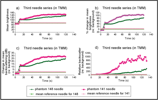

Two sets of experiments were conducted using coated needles. The first set investigated the activity of the coating in relation to different gauges of needle versus control systems. It also enabled a quantitative analysis to be made of the activity ( Figure 1). The second set utilised the latest generation of coating, which had been improved in terms of responsiveness (rate of initial bubble generation) and brightness. In addition, the second set was compared with a commercially available coating that has been claimed to exhibit similar properties.
Fig.1. Quantitative analysis of ultrasound data for coated needles in a tissue-mimicking phantom: a) Mean brightness; b) % Change in brightness (re. background); c) Change in backscattering (dB); d) Relative backscatter

Both the green- and pink-coated needles were readily visible in the resulting ultrasound image when tested in the tissue-mimicking phantom. Enhancement of the needles persisted throughout the imaging experiment (>100 s). The larger bore needle (pink) was more readily seen than the smaller bore needle (green). The increased visibility is probably a result of the increased area available for bubble generation compared with the thinner green needle. Figure 1quantifies the increased enhancement of the needles, compared with the uncoated controls. In particular, Figure 1 shows a peak mean backscatter of 25-30 dB, relative to the controls. The coated needles were visible within a few seconds of insertion and the rate of bubble generation, hence reflectivity, continued to increase, reaching a plateau after approximately 60 s.

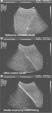

Figure 2 shows the results of the second set of experiments where the novel coating and the commercial coating are clearly visible compared with the uncoated reference. However, the novel coating is more than twice as bright as the alternative system, which demonstrates the superior features offered by a coating that generates bubbles dynamically. These active bubbles are most graphically illustrated in Figure 3, which shows a coated needle that has been immersed in water for several seconds. The quantitative effect of this bubble evolution for the latest generation of bubble coating is demonstrated in Figure 4.
Fig.2. Echocoat comparison in TMM

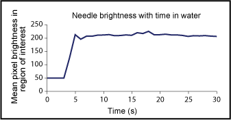

Fig.4. Change in brightness with time in water for latest generation of novel coating

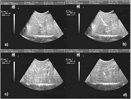

The coated needles were clearly seen in the images obtained in the isolated ovine liver ( Figure 6). A track of bubbles was still visible in the liver once the needles had been removed. Consequently, the clinician is able to track a bright line during needle placement. This provides information about the angle and position of the needle relative to the target, rather than the single bright spot afforded by the tip of the echogenic needle. Furthermore, when the coating was completely stripped from one of the needles (green), no background reflectivity was seen, which results from roughening the needle surface to promote coating attachment.
Fig.6. Ultrasound images of sheep liver (green needles): a) Needle 149 at start of data collection; b) Needle 149 at end of data collection; c) Track left by needle 115 when removed; d) Uncoated reference needle (167) in liver
