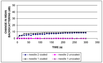

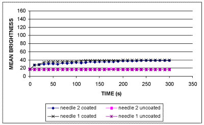

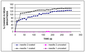

Upon analysis of the ultrasound data, it was found that the most promising coatings on needles 1 and 2, identified by eye and earlier video assessment, gave rise to the greatest quantitative changes, as shown in Figure 1. These samples were coated whereby the layer order followed the scheme in which a layer of Hydrothane TM containing dissolved citric acid was deposited first and then overlaid with subsequent layers of Hydrothane TM only and Hydrothane TM containing sodium hydrogen carbonate. Samples where the order was reversed showed very little activity. The other more obvious factor, was that the most active coatings contained the most gas producing reagent i.e., >50%/wt assuming an equal ratio of the reactive components (0.25g citric acid and 0.25g sodium hydrogen carbonate in 1g Hydrothane TM).
Fig.1a) Mean brightness
Fig.1b) % Change in brightness (re background)
Fig.1c) Change in backscattering (dB)
Fig. 1. Quantitative analysis of ultrasound data for brightest coating on stainless steel biopsy needles in a water bath

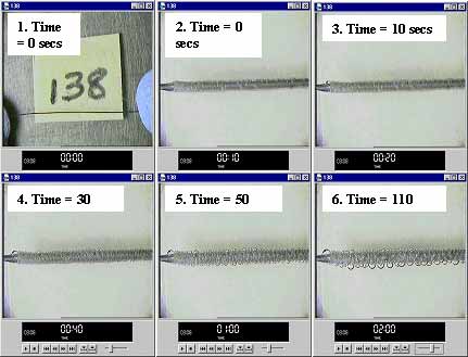

The reference wire in the first frame has a diameter of 0.125mm. Figure 2 shows the sequence of bubble development with time over approximately 2 minutes on a coated needle. Again, the reference wire in the first frame has a diameter of 0.125mm.
Fig. 2. Image sequence taken from video analysis of coating cast on a biopsy needle (sample no. 138). Wire in image 1. has a diameter of 0.125mm

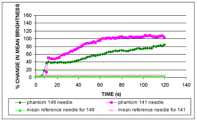

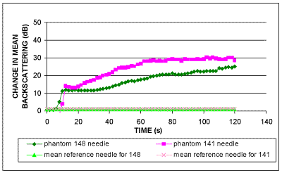

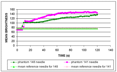

Both the green and pink coated needles were readily visible in the resulting ultrasound image, when tested in the tissue-mimicking phantom. Enhancement of the needles persisted throughout the imaging experiment, i.e. for greater than 100 seconds. The larger bore needle (pink) was more readily seen than the smaller needle (green). The attached graphs ( Figure 3) quantify the increased enhancement of the needles, compared with the uncoated controls. In particular, Figure 3 shows a peak mean backscatter of 25-30 dB, relative to the controls. The coated needles were visible within a few seconds of insertion and the rate of bubble generation, hence reflectivity, continued to increase, reaching a plateau after approximately 60 seconds.
Fig.3a) Mean brightness
Fig.3b) % Change in brightness (re background)
Fig.3c) Change in backscattering (dB)
Fig. 3 Quantitative analysis of ultrasound data for coated needles in a Tissue-Mimicking Phantom

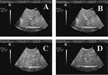

The coated needles were clearly seen in the images obtained in the isolated ovine liver as shown in Figure 4. It was noted that a track of bubbles was still visible in the liver once the needles had been removed.
Fig. 4. Ultrasound images of sheep liver (green needles): a) Needle 149 at start of data collection; b) Needle 149 at end of data collection; c) Track left by needle 115 when removed; d) Uncoated reference needle (167) in liver
Consequently, the clinician is able to track a bright line during needle placement, which provides information about both the angle and position of the needle, relative to the target, rather than the single bright spot afforded by the tip of the echogenic needle. Furthermore, when the coating was completely stripped from one of the needles (green), no background reflectivity, due to roughening the needle surface to promote coating attachment, was seen.
