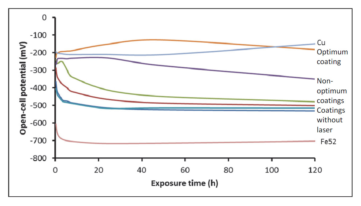

Finally, Figure 11 shows the OCP test results for a second type of Cu bronze coating deposited onto steel, using a number of different laser assisted cold spray conditions.
Figure 11: Open circuit potential in 3.5wt% NaCl solution of Cu bronze coatings deposited on steel prepared, using different laser assisted cold spray conditions.
Figure 11 suggests that coating barrier properties close to parent Cu can be achieved with appropriate spraying conditions.
