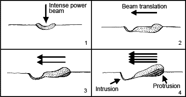

Power beams have been used for many decades to process metals in a variety of ways, including welding, cutting and drilling. This paper describes a new laser variant of a technique that uses power beams to melt and displace material, thereby creating a surface form. The material moves largely due to surface tension generated by a temperature gradient created across a molten material surface. How the material moves, and ultimately the shape of the features produced, can be determined by precisely controlling the beam path and speed over the surface. The process can create surfaces that may be impossible to produce by other means. Using electrons as the power beam source, a large number of features of a few millimetres height above a metallic surface have been fabricated in a very rapid way - several thousand features within 10 seconds. Recent electron beam developments have also demonstrated that the technique can work over a wide dimensional scale: making small features of tens of microns in size, and at the other extreme creating protrusions of tens of millimetres diameter and height.[1-4] The types of surfaces produced are being investigated for many applications, including orthopaedic implants, with improved fixation due to promotion of bone in-growth, preparations for metals to be joined to composite, and for making surface features that enhance thermal transfer for high performance heat exchangers.
Figure 1 shows a schematic representation of how the process works when a high intensity laser beam is passed over the surface of a metal plate several times.
Fig.1. Schematic of the process involved in the generation of a Surfi-Sculpt like feature. Note the direction of the beam movement is from right to left
Although most of the work to date has used electron beams, which are readily manipulated using electromagnetic deflection systems, the work reported here has employed high brightness laser beams, with either rapid work piece movement or galvanometric mirror beam deflection.
