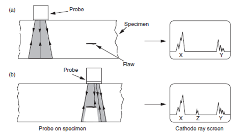

The oscilloscope screen in Fig. 1 shows on the vertical axis the signal height or amplitude and on the horizontal axis the time taken for the signal to return to the receiver and therefore distance from the transmitter. This method of examination is known as an “A scan” and is the most common method in use in industry for the examination of welded joints. In Fig 1 three signal peaks can be seen on the oscilloscope screen – one where the signal enters the sample, one reflected from the back face of the sample - the “back wall echo” - and, between the two, a reflection from some feature – a “reflector” such as a welding defect. The distance of this signal on the screen from the transmission pulse will give the distance of the reflector from the probe so a little simple geometry can be used to calculate the position and depth of the reflector within the block of material. Comparing the height of the signal with the signal from a known size of reflector enables the size of the feature to be determined.
There are two main types or modes of sound waves – longitudinal or compression waves which alternately compress and decompress the material in the direction of propagation and shear waves which vibrate the material at right angles to the direction of propagation. Which mode is produced depends upon the angle at which the sound beam enters the material. Probes that project the beam into the test piece at an angle normal (90degs) to the plate surface are known as compression probes and are ideally suited to the detection of defects such as plate laminations or for the measurement of plate/pipe thickness as shown in Fig 2.
Fig. 2. Compression Wave Probe

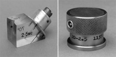

To obtain the strongest reflected signal the beam should ideally strike the feature at 90O – flaws that lie parallel to the beam may be missed. This means that to examine a weld that may contain flaws laying in any number of orientations within the weld a range of different angle probes and scanning patterns must be used. To do this both compression and shear wave probes may be used, shear wave probes projecting the beam into the test piece at an angle, as shown in Fig. 1. Probes with angles of 30o, 45o, 60o and 70o are commercially available. Examples of standard probes are illustrated in Fig. 3.The angle of the probe is often selected to give the strongest signal from the defect of interest and for very high integrity welds all five probe angles may be used.
Fig 3. A 2.5MHz 70 degrees shear wave probe and a compression wave probe.

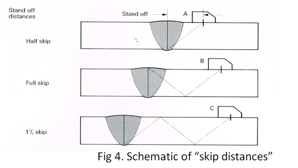

As shown in Fig. 4 the sound beam can be made to scan the full depth of a weld by moving the probe back and forth. At the half skip distance the beam would readily detect lack of side wall fusion along the left hand fusion line but may miss lack of side wall on the right hand fusion line. Moving the probe to the full skip distance so that the beam reflects off the back face enables the right hand fusion line to be scanned with the beam at the optimum angle to detect lack of side wall fusion.
Fig 4. Schematic of “skip distances”

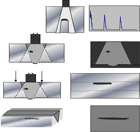

The A-scan mentioned above is one method for reporting the results of the scan – there are in fact four methods identified as A-, B-, C- and D-scan. The A-scan method is the conventional way of presenting the results – signal amplitude vs distance; B-scan is a view looking along the length of the weld; C-scan is a plan view and D-scan a view from the side of the weld. These are illustrated in Fig.5
Fig 5 Schematic of A-, B-, C- and D- scan results
Fig 5. Schematic of A-, B-, C- and D- scan results
