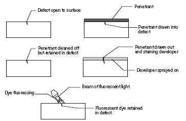

Fig. 1 Principles of LPI

LPI is a simple, cheap and easily portable inspection method that requires no equipment apart from spray cans. It can detect surface breaking imperfections only and relies on a coloured or fluorescent dye, sprayed on the surface and penetrating the imperfection. About15 minutes is generally specified to enable the dye to penetrate any very fine imperfections. After cleaning the excess the dye is drawn to the surface by spraying on a developer in the case of the colour contrast dye or exposing the surface to ultra-violet light in the case of a fluorescent dye, the imperfection being revealed by the dye staining the developer or fluorescing, as shown schematically in Fig. 1 and in Fig. 2, a liquation crack in an aluminium alloy.
The fluorescent dye gives greater sensitivity than the colour contrast dye and does not require the use of a developer. It does however require the use of an ultra-violet light source and preferably a darkened room which makes it a less portable inspection method than the contrast dye technique.
The dye used as a penetrant must be able to penetrate tight cracks but must not be capable of being removed from more open imperfections during the cleaning operation carried out prior to applying the developer.
