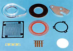

jk53f4.jpgLaser cutting offers a high precision, CNC controlled method of cutting plastic, metallic and thin ceramic components. It is a mechanised, thermal, non-contact process capable of cutting most materials with a high degree of precision and accuracy.

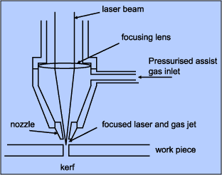

There are two commonly used types of industrial cutting laser, CO2 and Nd:YAG. These differ in that the wavelength of infrared light produced is 10.6µm for CO2 lasers and 1.06µm for Nd:YAG lasers. Both these types of lasers produce the cut by focusing a beam of monochromatic light to a very small spot size by lenses and mirrors giving power densities in the up to 105 W/mm2. This power density is sufficient to melt locally or even vaporise most materials. Once a through thickness zone of molten or vaporised material is generated (a keyhole), a jet of assist gas, delivered co-axially through the cutting nozzle, is used to eject this material from the kerf. (Fig 1).
Fig.1. Laser cutting head
The characteristics of the laser cutting process relate to the fact that the beam can be focused to a spot of less than 0.5mm diameter to achieve these very high power densities. The resulting cut edge is very square and the process is capable of cutting at very high speeds. The combination of an intensely concentrated heat source moving at high speeds also results in very little heat being transmitted to the surrounding material and, therefore, very little thermal distortion of parts.

The types of assist gases used to eject the material from the kerf can be classified as either reactive or inert. The CO2 gas used in CO2 lasers is not the assist gas, but one of the gases excited to produce the laser light in the lasing cavity, usually quite a distance from the cutting process head. The most commonly used reactive assist gases are oxygen or air. Oxygen is used primarily for cutting low alloy steels and readily reacts with iron at high temperatures producing additional heat energy which enables thicker parts to be cut or greater speeds to be achieved. This gas is delivered at relatively low pressures and flow rates and the process is referred to as 'low pressure oxygen cutting'.
Inert assist gases commonly used are either nitrogen or argon. These provide no thermal assistance to the cutting process and are used simply to blow the molten material out of the kerf. They are used at pressures of around 10 bar and the process is referred to as 'high pressure inert gas cutting'. Inert gases can be used for alloys which readily oxidise in the presence of oxygen such as stainless steel, aluminium or titanium to give a very bright and clean cut edge. Occasionally, inert gases are recommended for cutting low alloy steels where the edges are to be subsequently laser welded. This reduces the formation of an oxidised layer on the face of the cut edge and will reduce porosity in the resulting weld.

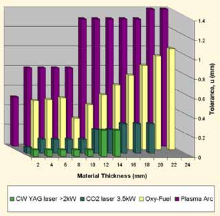

Cut edge squareness, U
Edge squareness is of interest because it gives an indication of the fit-up between two components and whether any post cutting machining operations will be necessary. It is defined in terms of the Perpendicularity and Angularity tolerance, U (mm). This is a measure, in millimetres, of how much the cut edge deviates from a perfect square edge. CO2 and Nd:YAG lasers are capable of producing cuts with good edge squareness (<0.5mm). This is highlighted in Fig. 2.
Fig.2. Relative edge squareness of laser and competing processes for carbon steels

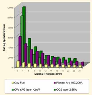

Whilst most suited for precision cutting of thin sheet in the 1-15mm thickness range, both CO2 and Nd:YAG laser cutting systems require high capital investment. The cost of purchasing laser equipment can range from £50k-£250k depending on the output power requirements of the system. Precision work handling equipment is required if a laser is to be used to its full potential, in terms of cutting speed and quality. When combined with a chiller unit, this can add a further £100k to the cost of implementing a laser system.
As a result, laser cutting systems typically are used where high cut quality requirements make their application essential, or where the initial investment is offset by the high production rates that can be reached as a result of their high cutting speeds on thin sheet materials as illustrated in Fig.3.
Fig.3. Cutting Speeds of laser and competing processes for carbon steels
